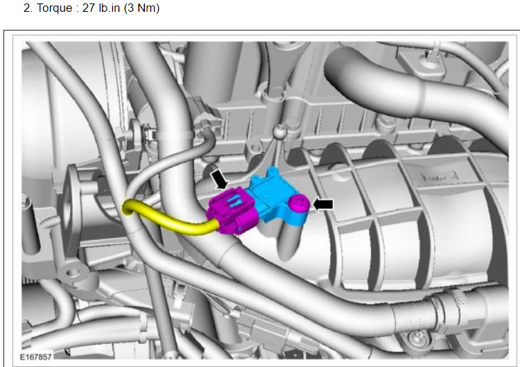

Location of MAP sensor? Can you tell me please?

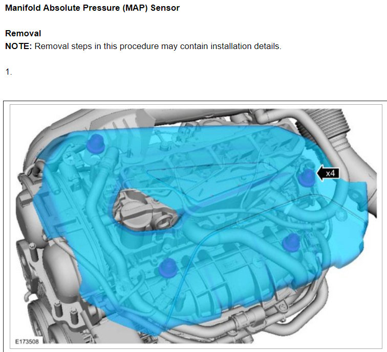

Here is the location of the MAP sensor and how to change it out. Check out the diagrams (Below). Please let us know if you need anything else to get the problem fixed.
