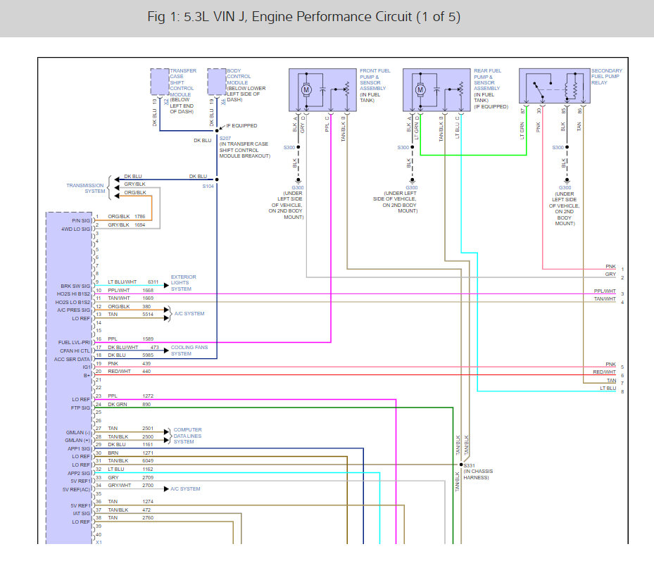

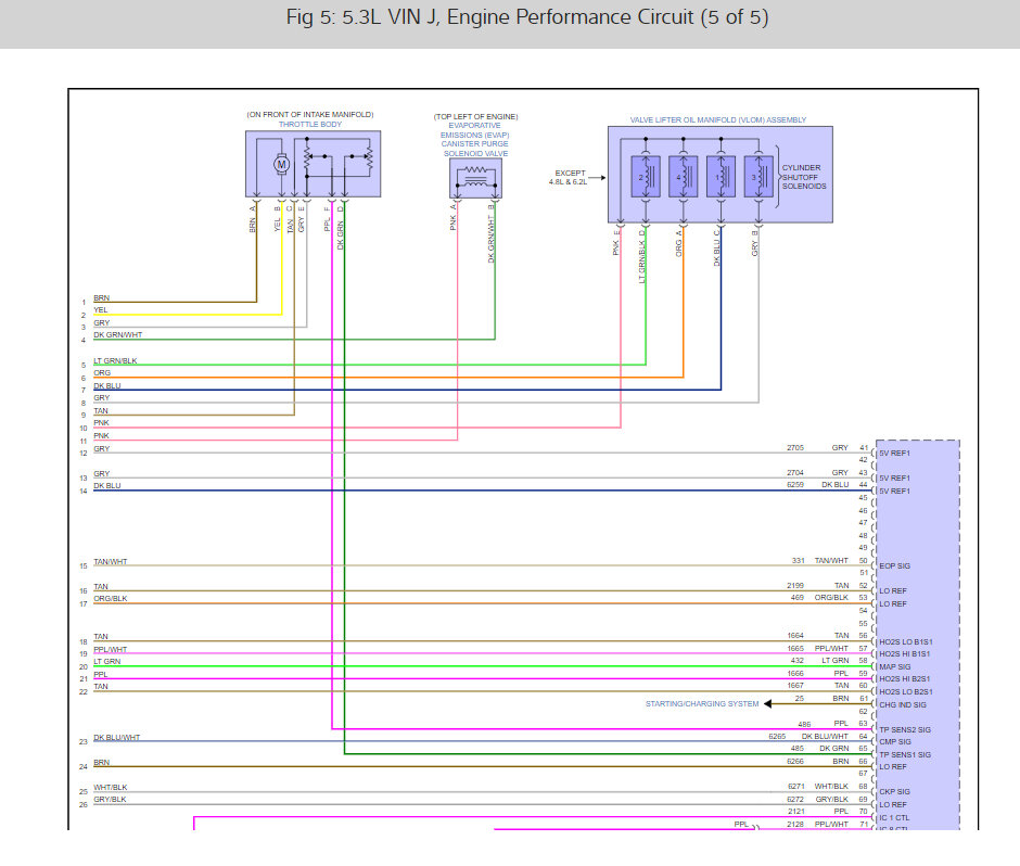

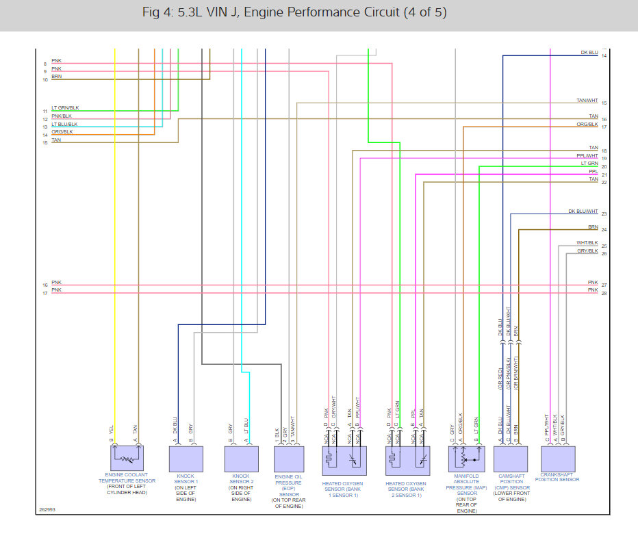

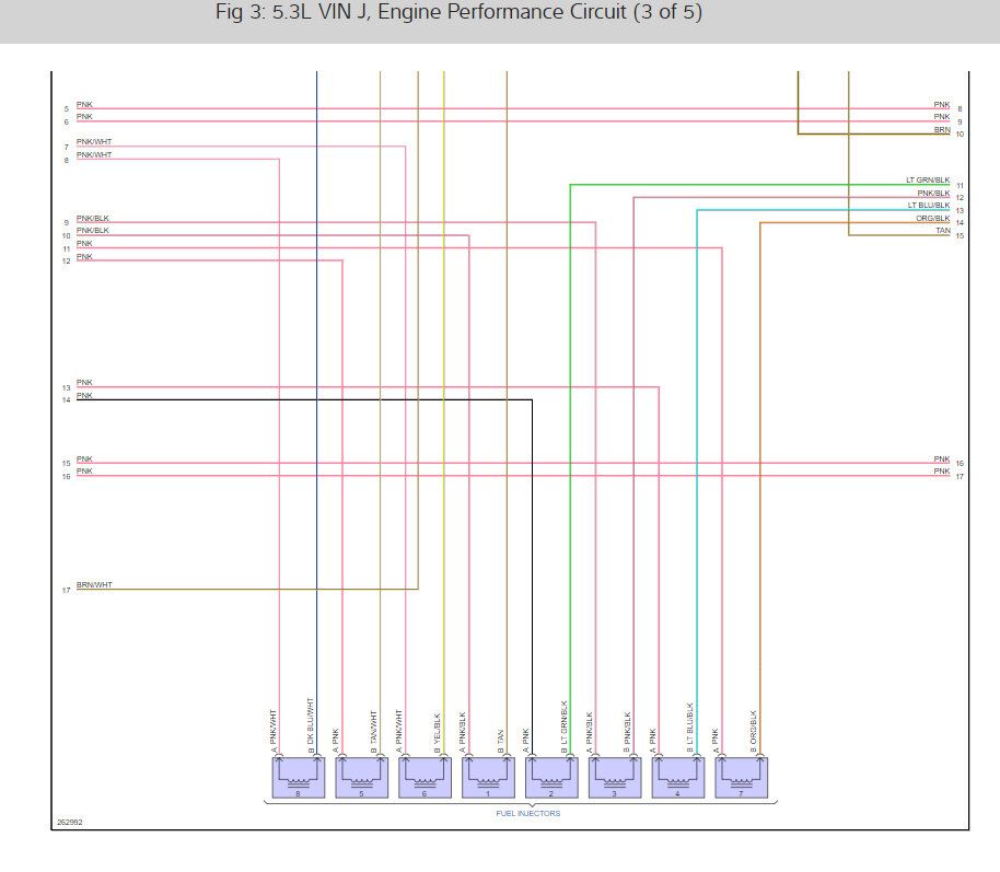

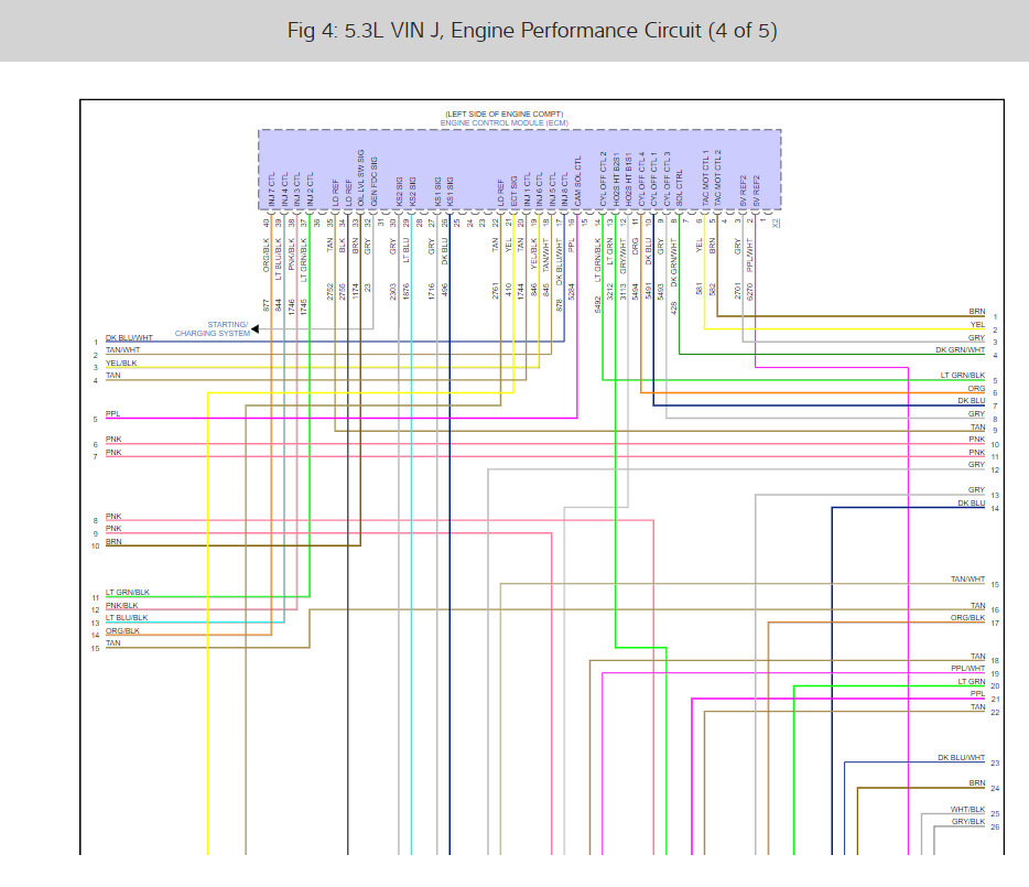

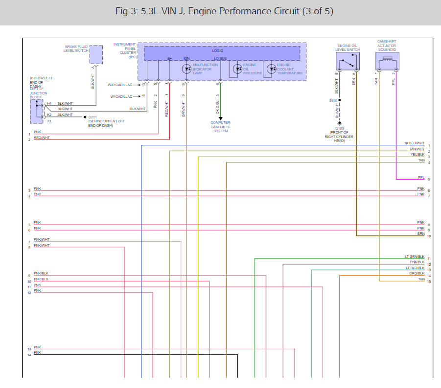

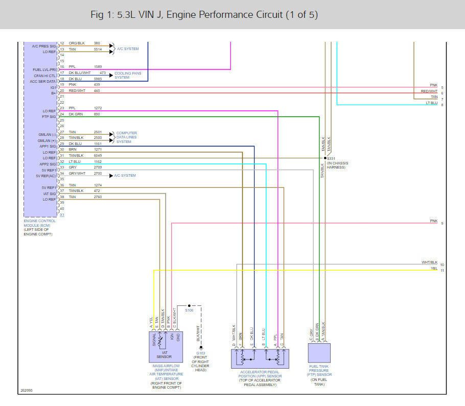

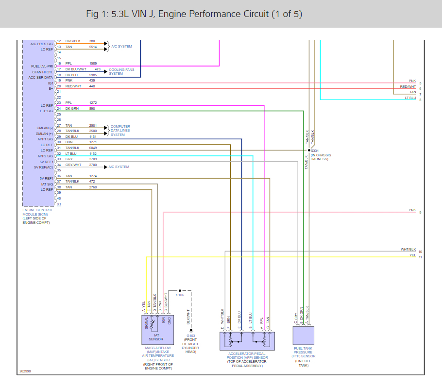

The air intake sensor is inside the MAF sensor, you must have bad wiring or the connector to the MAF sensor is bad, I would remove the connector and inspect it using the flashlight to see if any of the pins are pulled out.

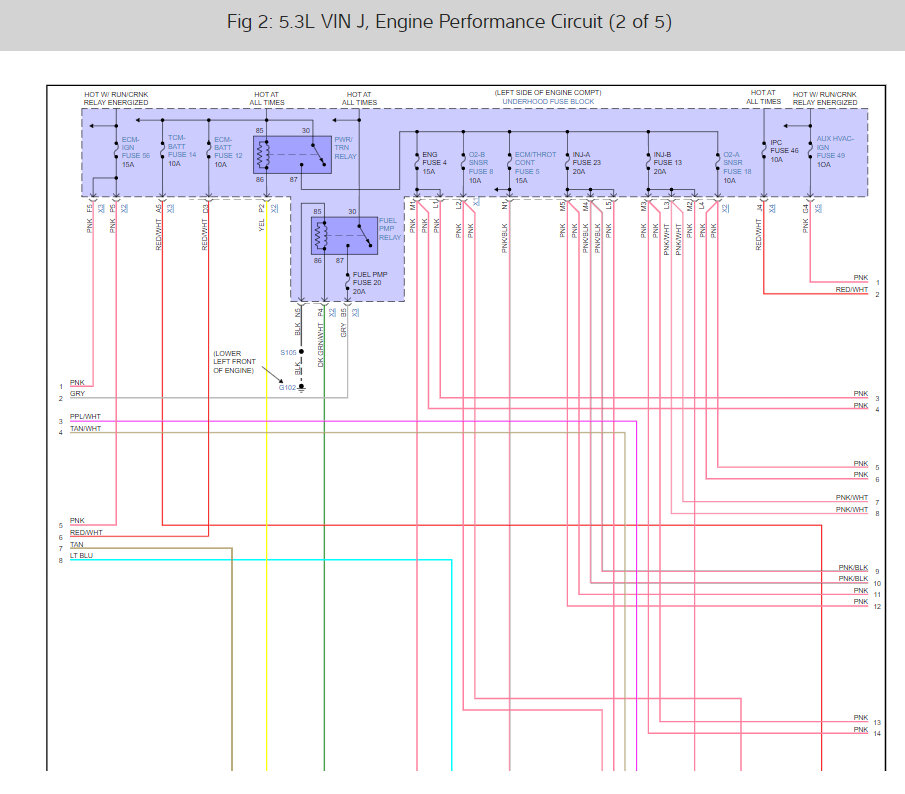

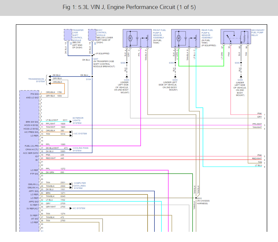

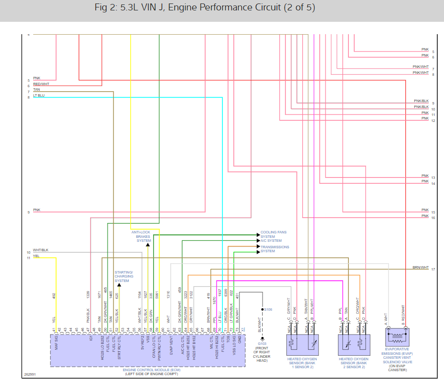

If the connector is good, you will need to check the engine wiring here is a guide and the engine wiring diagrams in the images below.
Check out the images (below). Please let us know what you find. We are interested to see what it is.
