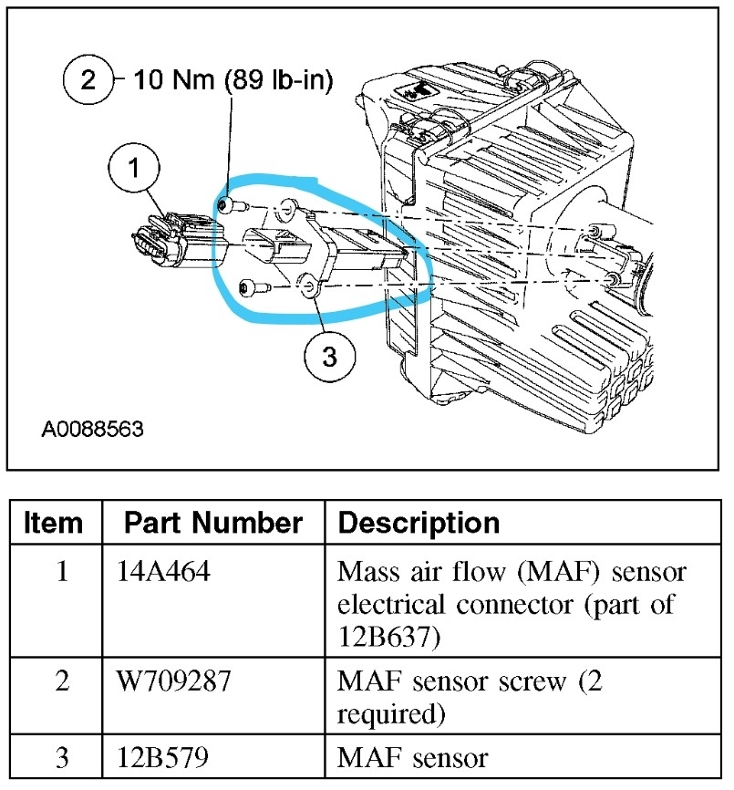

Please tell me where the MAF sensor is located.

It is bolted into the side of the air duct near the air filter box in the hose that goes to the intake. You remove the electrical connection, then the screws and remove the sensor. Observe the direction it is installed so it goes back in the same direction.
