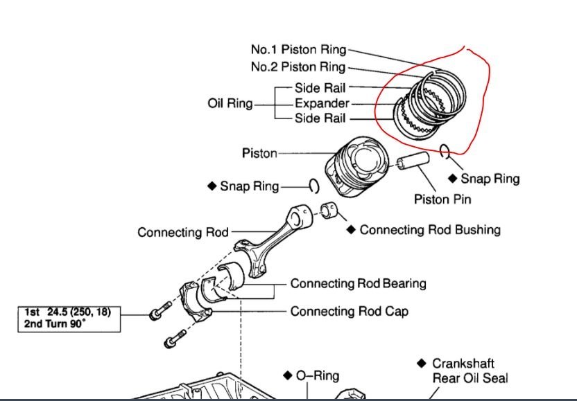

Hi there. I have the car listed above which is driving me crazy by slowly losing oil. it loses around 1 quart per month. I think I've replaced every seal that could've been replaced or anyone could think of.
the rear crankshaft seal(which involved the removal of the transmission) - replaced.
valve cover gasket - replaced.
PCV valve - replaced.
engine oil pan gasket - replaced.
maybe engine is burning oil? no smoke is coming out of my exhaust, even with the highest RPM revs.
maybe head gasket is blown? engine oil and coolant both looks super clean.
I really love this car and don't want to sell it. but this continuous oil decrement is driving me crazy.
