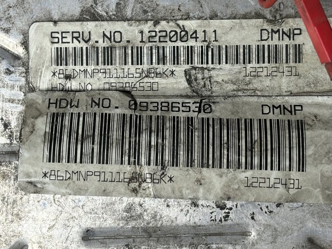

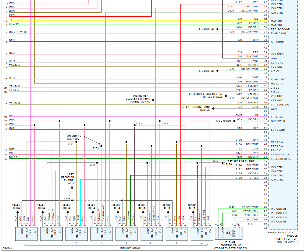

I am trying to help someone figure out or identify the wiring in the vehicle listed above. It is my understanding that there has been a LS swap done, I’m so sorry if I’m not explaining this correctly. This ECM is or has been hooked up already, I’m not looking for help with harness or pin stuff I don’t think. Being that this a different motor and computer the original cluster has been disabled, we are trying to connect a new cluster that supports this ECM. The wires I guess from the new cluster need to connect with the wiring coming from the ECM, I think it’s about 70 wires. I hope some of this makes sense. I’ve attached a picture of the computer thing.

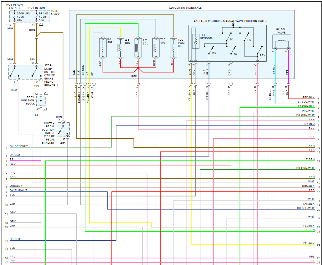

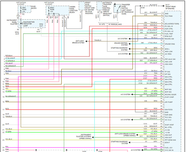

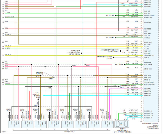

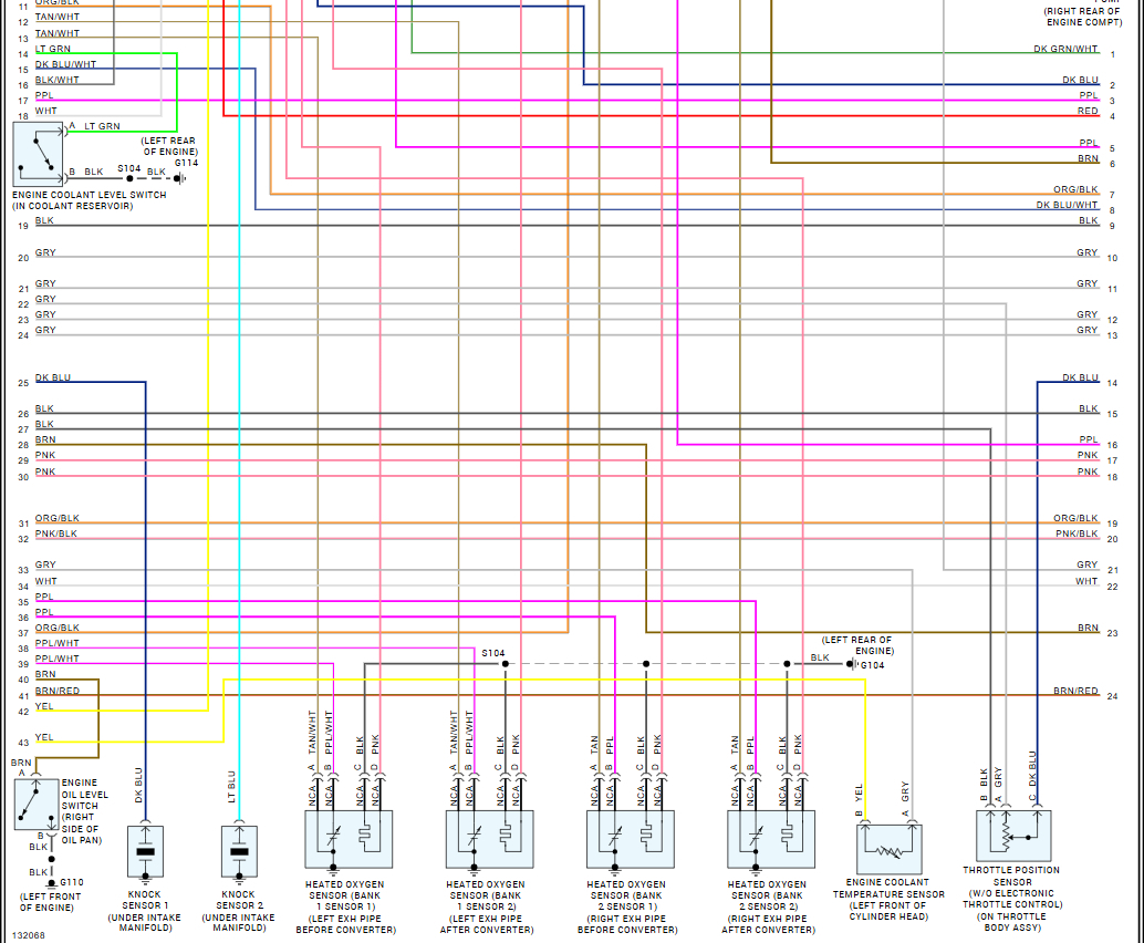

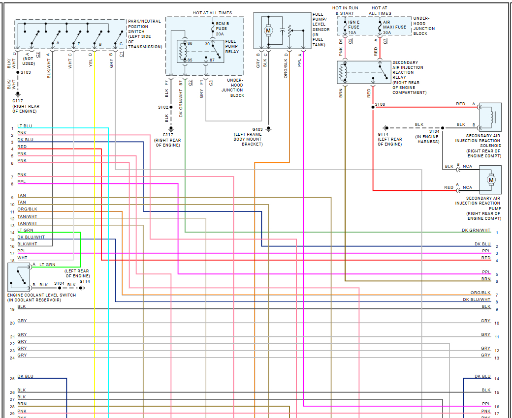

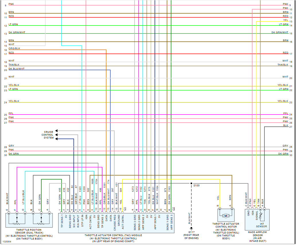

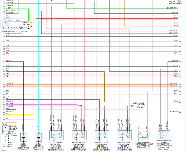

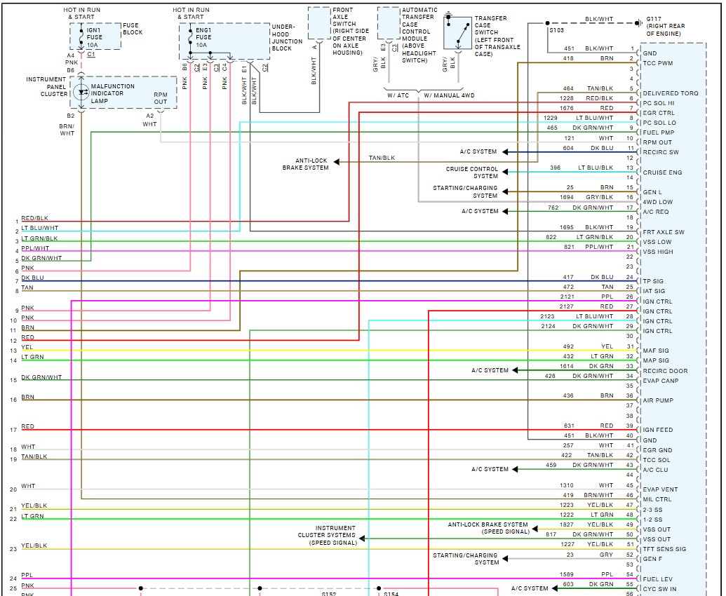

Okay, this part number is for a:
2001-2002 Silverado 1500

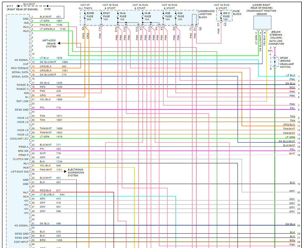

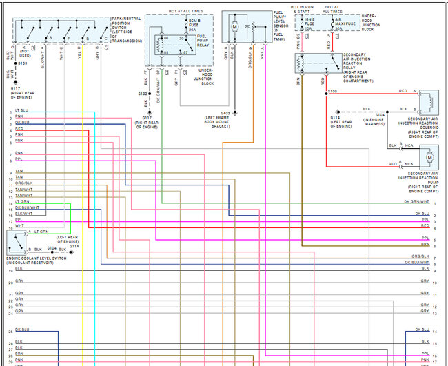

Here are the PCM and engine wiring diagrams so you can try to connect the instrument cluster. Check out the images (below). Let us know if you need anything else.
Nov 2, 2024 at 10:29 AM

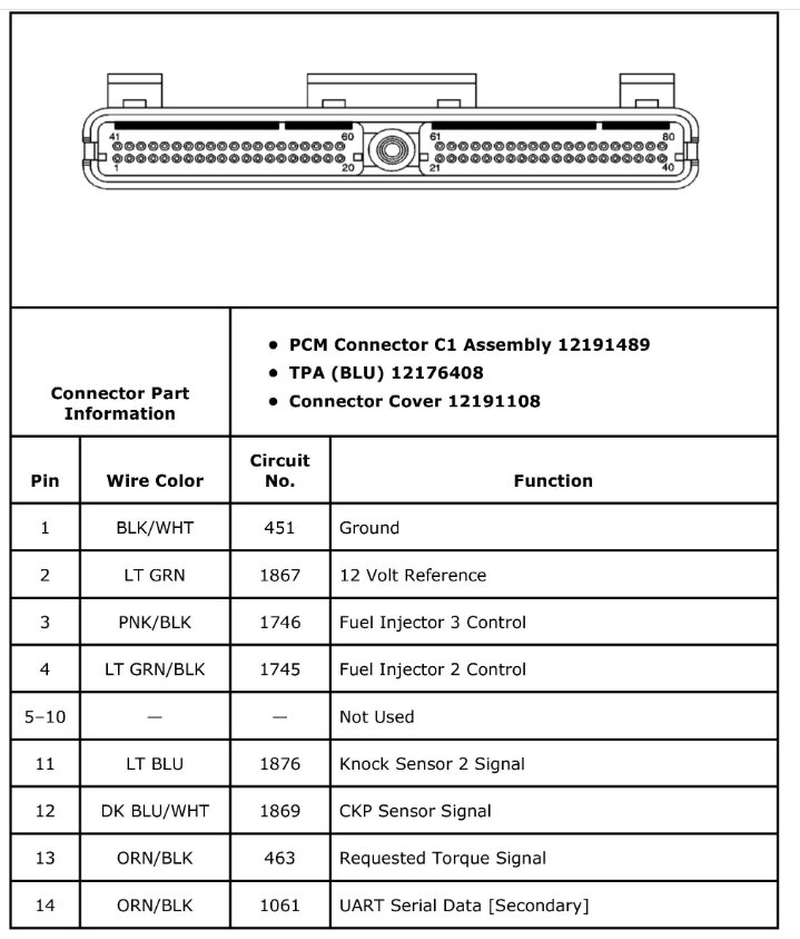

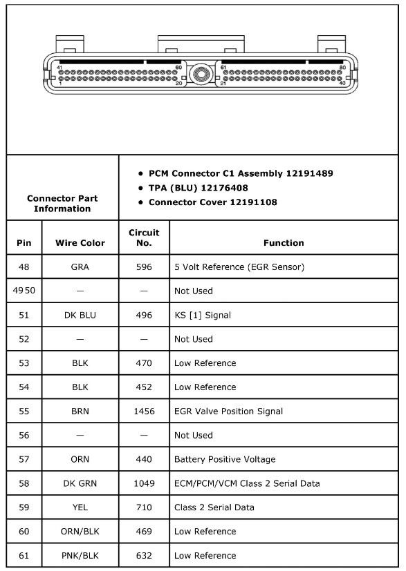

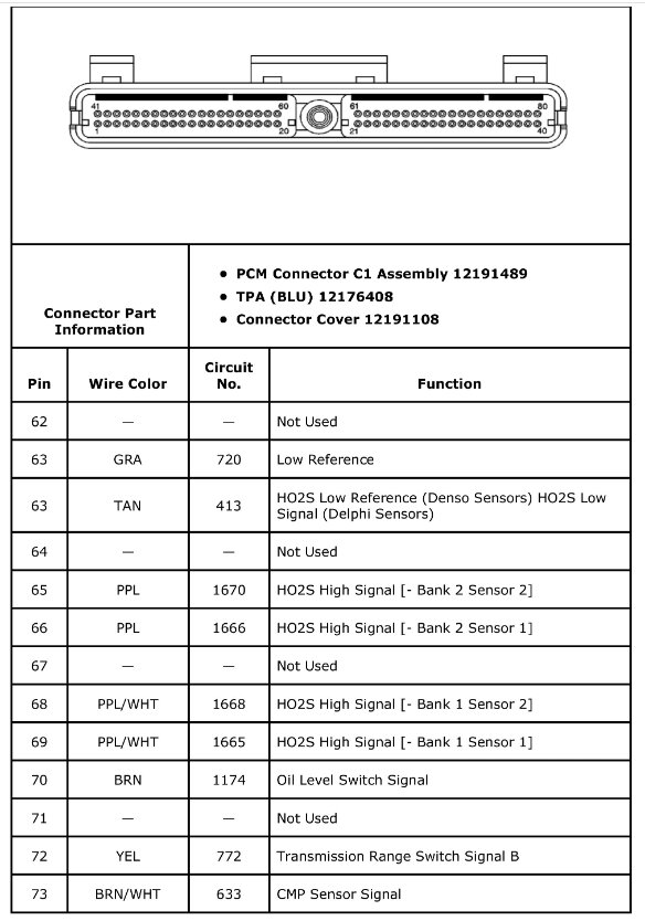

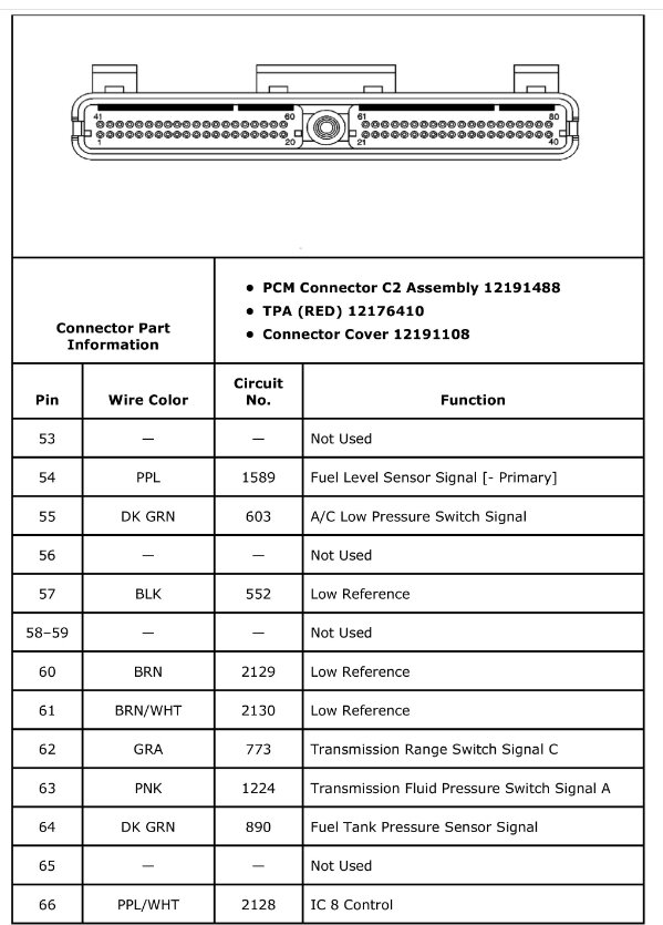

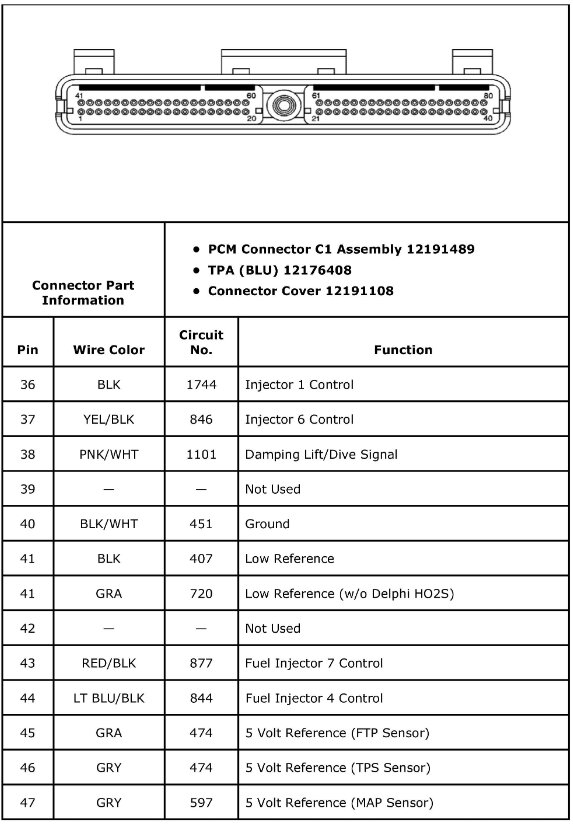

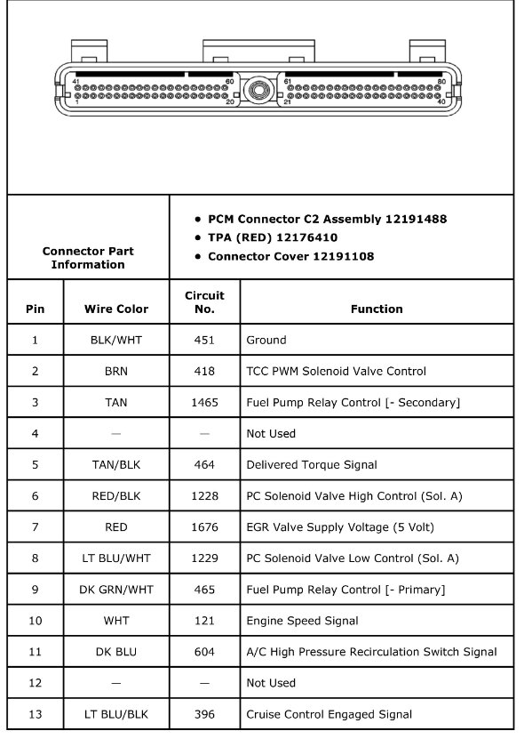

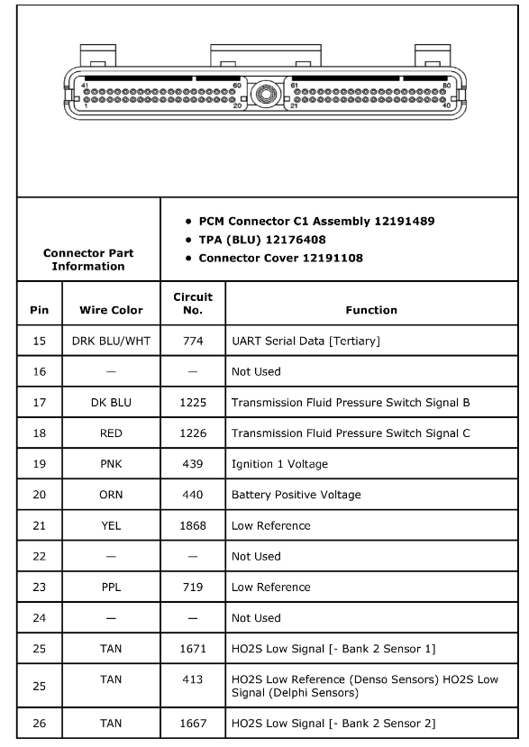

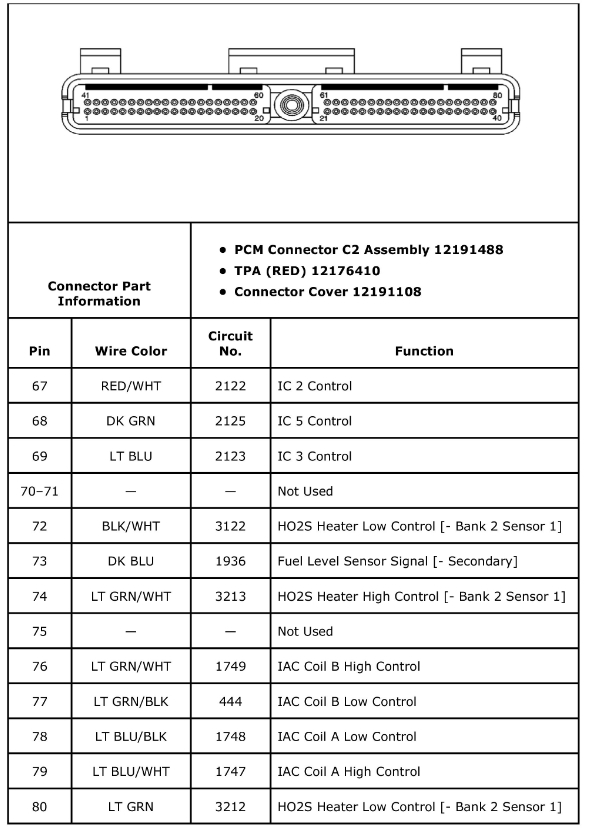

Thank you for the reply. I’m assuming this is a stupid question but are any of these showing the Pinout? I don’t know if I mentioned I know nothing about this stuff, I'm trying to help someone that is attempting to connect a digital cluster to his car that has a different motor and computer thing now. I know the car has been “tuned” and now just needs the cluster. I guess I’m looking to know which wires and where in the back of the computer plug/pin are what which wire is what? Leading from the plug on the back? I’m so sorry if this is not making any sense.
Nov 4, 2024 at 8:00 AM

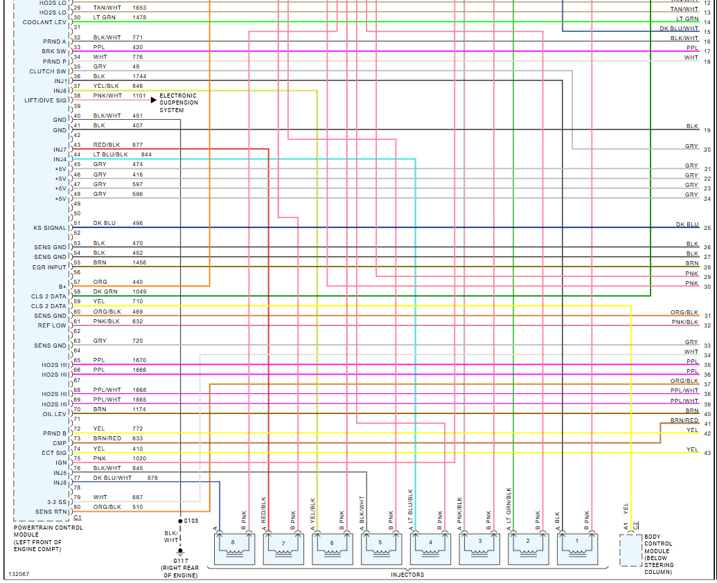

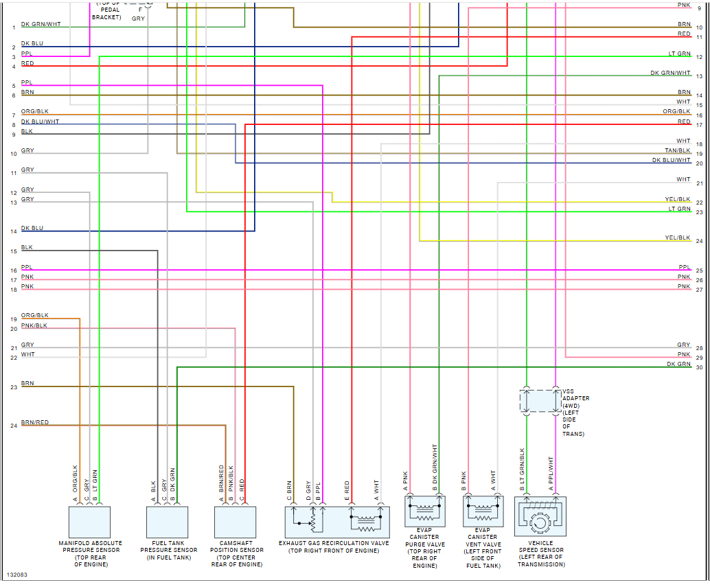

You are okay, I understand, here is the pinouts for the PCM for the 2001 chevy 1500 both the red and blue connectors. Check out the images (below). Let us know if you need anything else.
Nov 4, 2024 at 10:13 AM
