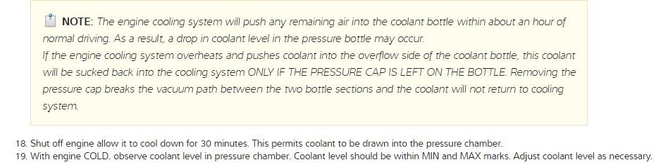

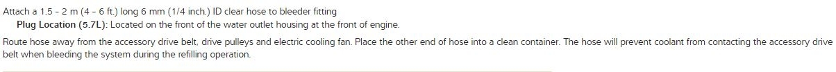

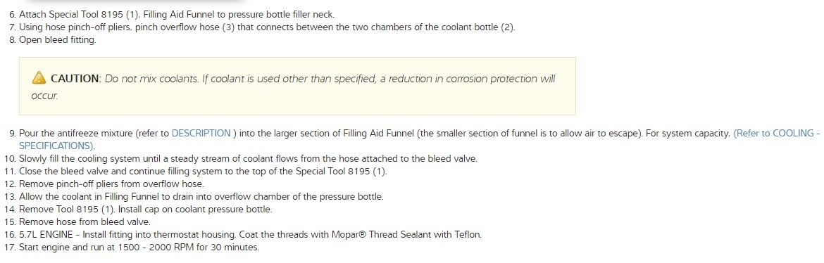

I have a leak from the bottom radiator hose. Getting it off and replacing it is not the problem. My concern is on how to fill it with coolant after. I’ve heard that I have to burp the system. Can anyone help? If there is a procedure on how to do this?
