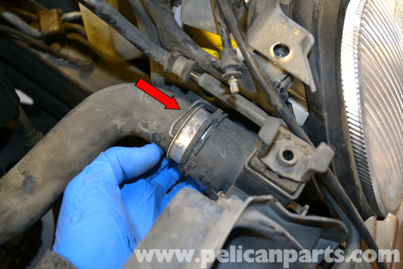

What are the steps to replace the hose? It has some weird connections. It is not just regular clamps.

The hose is plugged in and held in position by a locking clip. Use a screw driver to pry the clip outwards until it is unseated from position and clicks into its unlocked position. The clip should stay on the hose end. Twist the hose until it is loose and it should come off. Inside the hose is an 'O' ring. lubricate it with a little rubber grease before installing. For new hose, do not pull the clip out. Just plug into the radiator and thermostat outlet until you hear the clip clicks. Tug at hose to ensure that is is locked, failing which the hose would detach itself when pressure builds up as coolant heats up.

Additionally, I am looking at the new part and the ends of the hose (the quick connect ends) are lacking the clip. So how should if I have to reuse the old clip, how do I orient it?

The hose should come with the clip in its locked position. If it is not there, you would need to reuse the old one. The clip comes easily when pried off.
