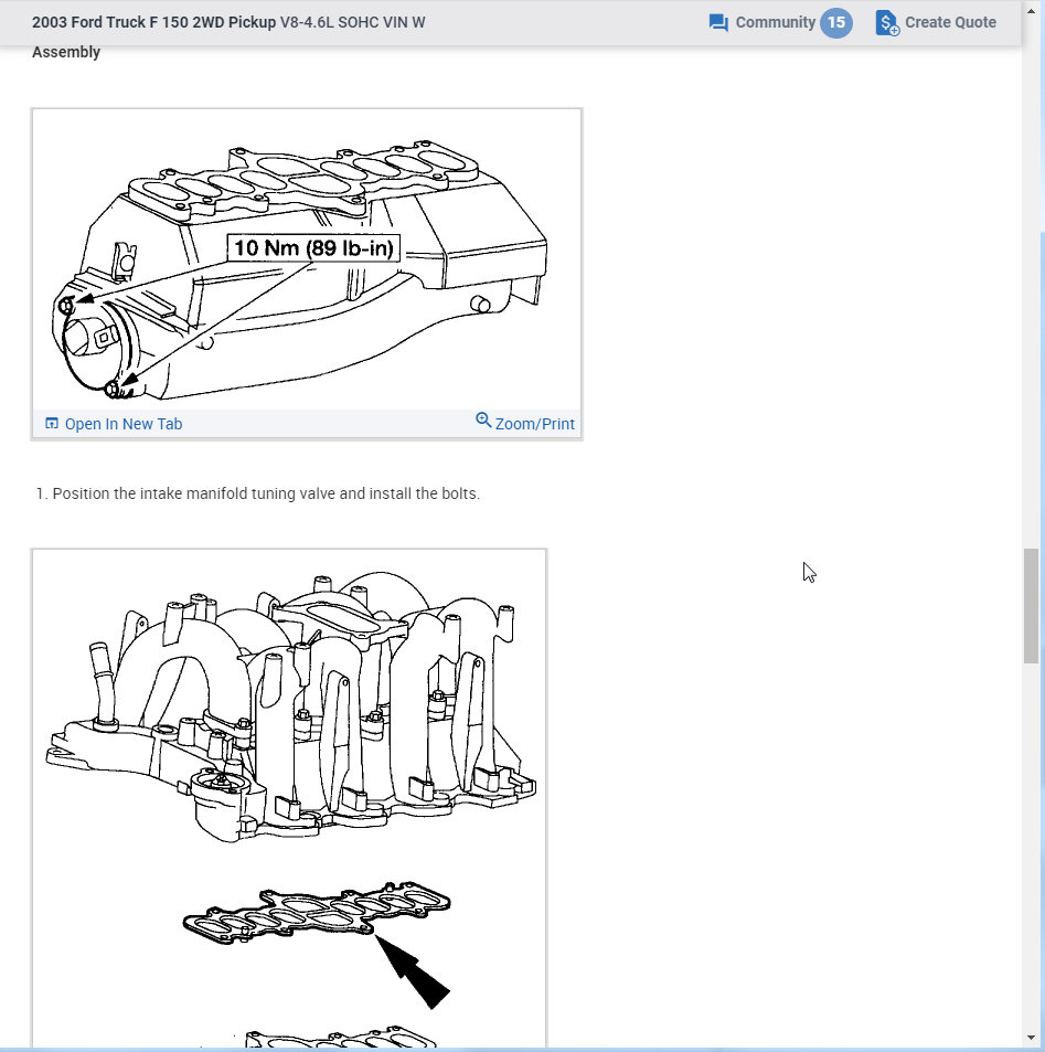

What is the torque setting to connect the lower intake manifold to the upper intake manifold?
May 8, 2020 at 2:41 PM
CERTIFIED EXPERT
18,907 POSTS

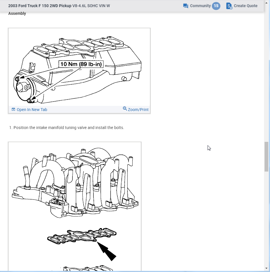

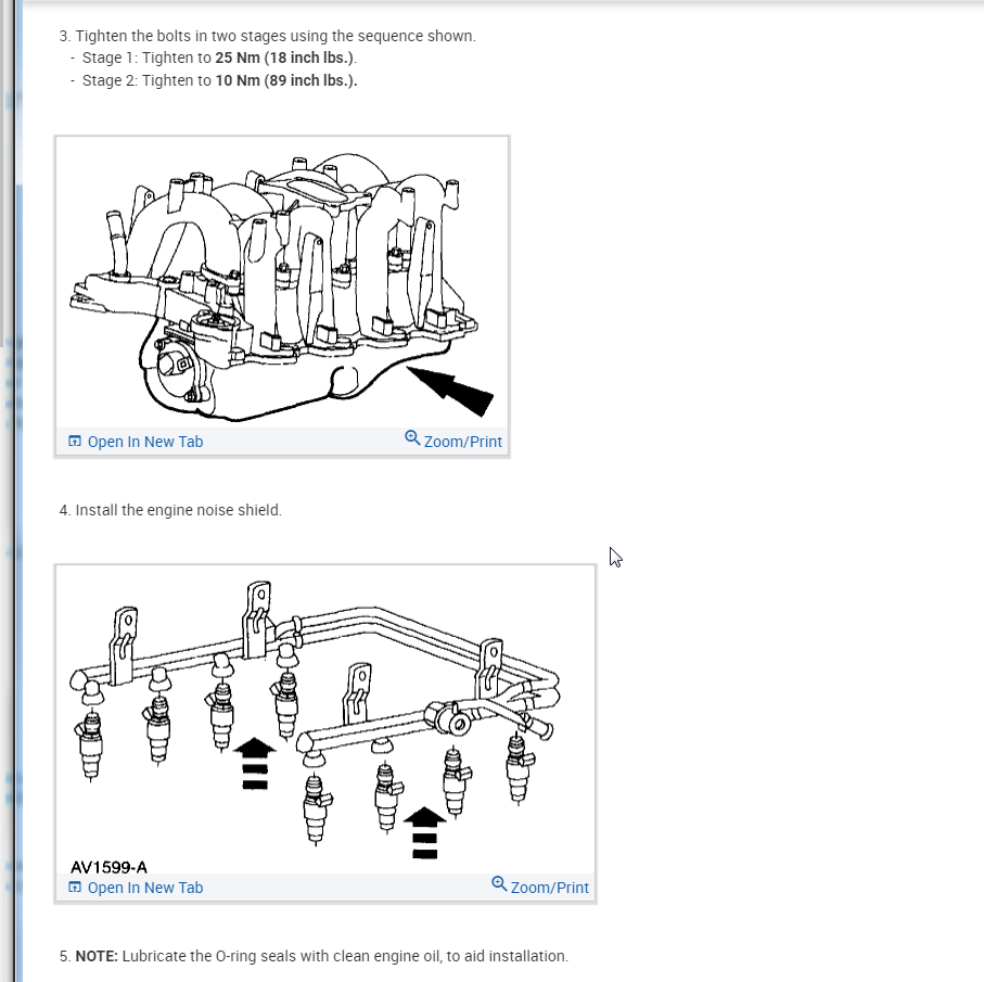

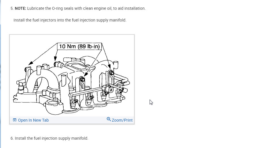

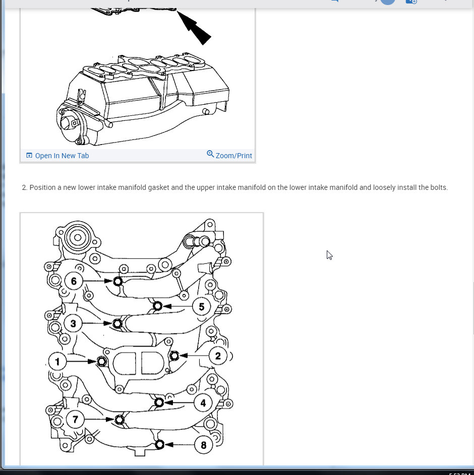

Here is the process for installing the manifolds with torque specs. Let us know if you need more info and we can send it over. Check out the diagrams (Below). Please let us know if you need anything else to get the problem fixed. Thanks

This is the upper to lower sequence and torque spec.
Stage 1: Tighten to 2 Nm (18 inch lbs.) .
Stage 2: Tighten to 25 Nm (18 ft. lbs.) .

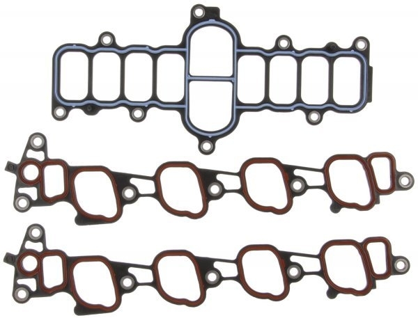

My manifold looks like this one but doesn’t fit my 4.6 . My engine block has 12 bolt holes.The same gasket can be used on either side of engine by flipping gasket from back to front.

Your gaskets should look like these. If so the above is the correct pattern according to Ford. If you have an extra bolt it also gets torqued to the same spec.

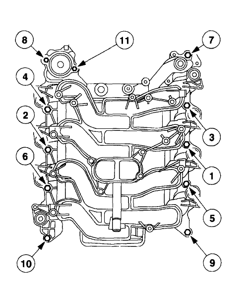

can you tell me what the torque specs are for the intake manifold for 97 ford 4.6l triton?
Dec 9, 2020 at 1:58 PM
(Merged)
DAVE H
CERTIFIED EXPERT
13,384 POSTS
Intake Manifold Bolt Ft.Lbs 15-22 Nm.(20-30)
Tighten bolts in sequence. See Fig. 2 .
