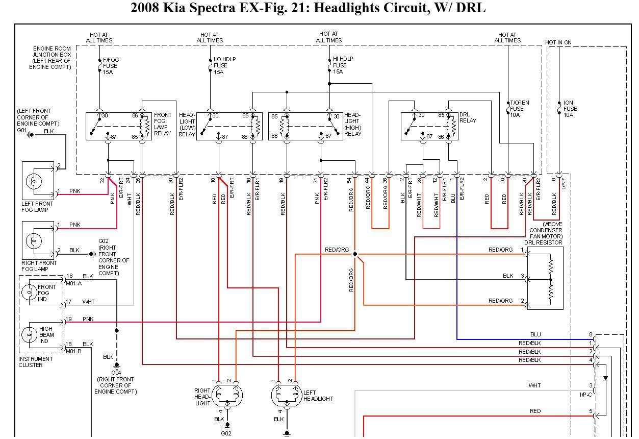

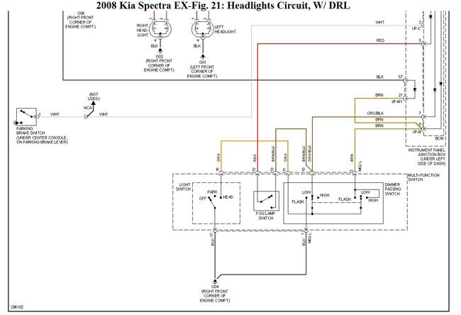

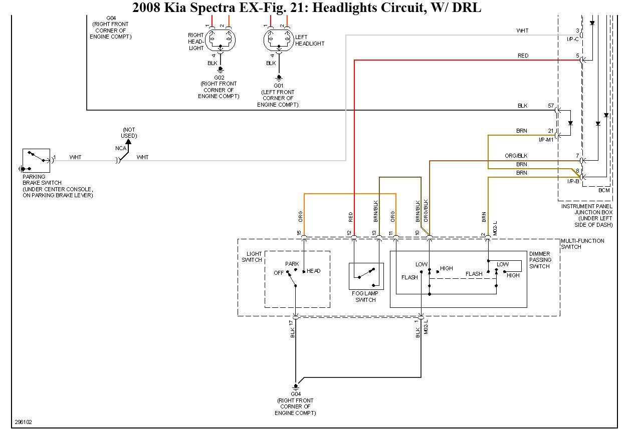

KHLOW2008
  • 41,814 POSTS
I have the schematic and component location description in the diagrams below. Print them out and go through them.
Try swapping the low and high relay.
Do you have battery voltage at the light switch for the low beams? If yes, most probably the low beam relay or its circuit is bad.
