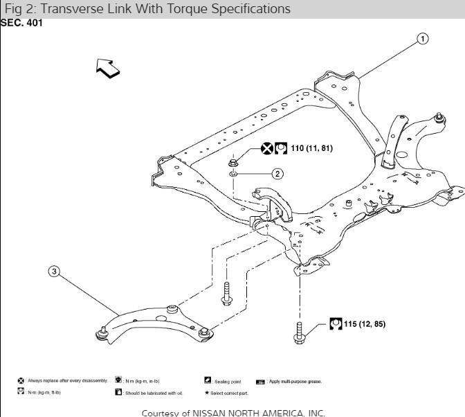

I need to find the torque specifications for the lower control arms on the vehicle listed above. The part numbers are listed below:
54501-5RL1B (Left)
54500-5RL1B (Right)

The torque for the lower control arms is 85 ft lbs.
Be sure to torque these with the vehicle weight on the ground, or binding of the arm bushings can occur and cause problems.
