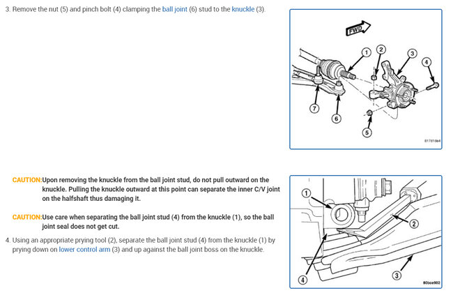

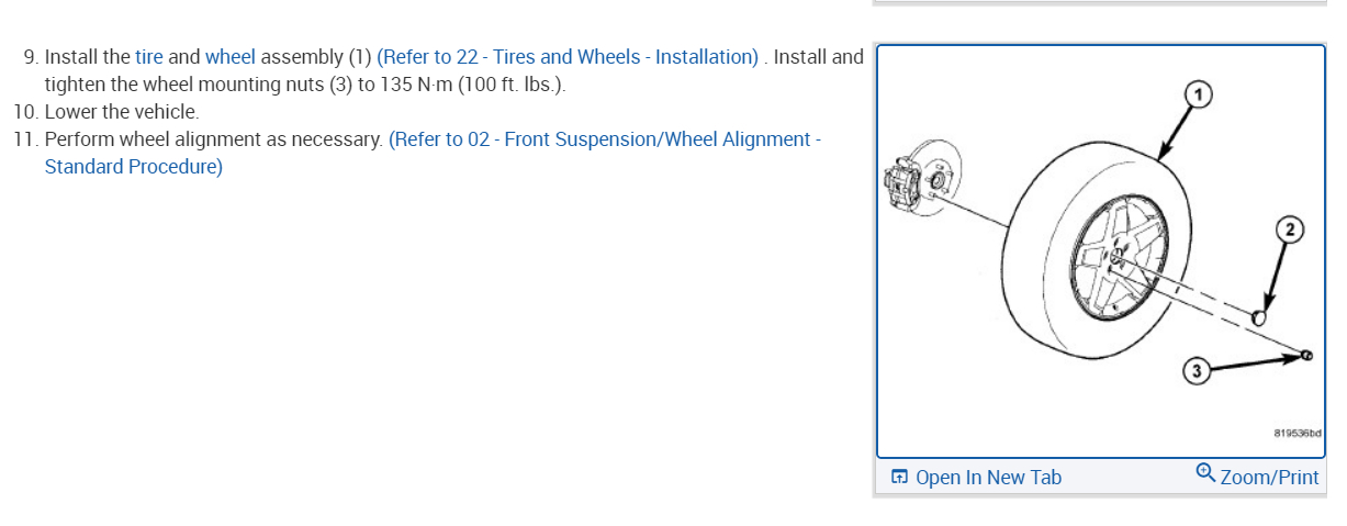

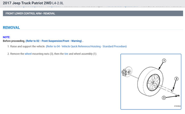

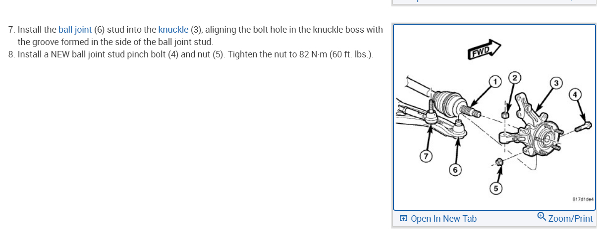

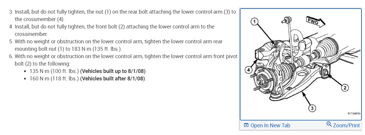

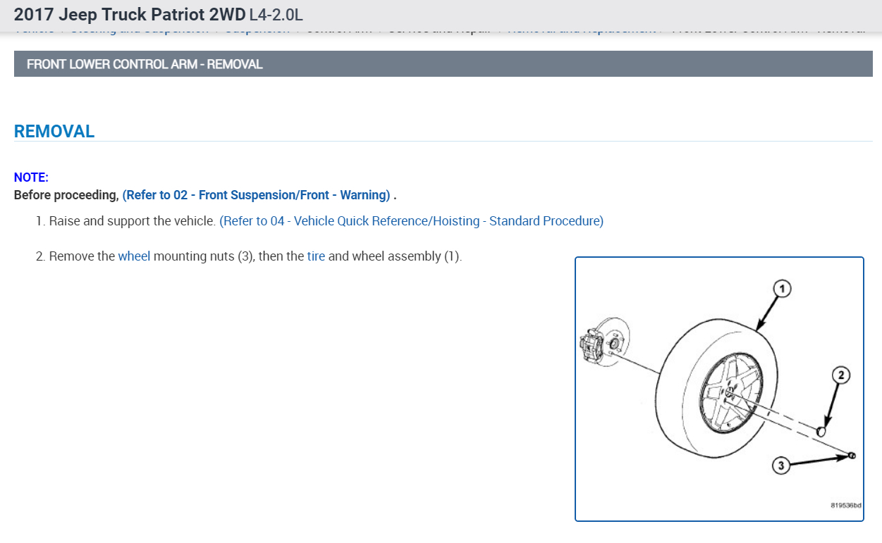

Do you have over sized tires on the vehicle?

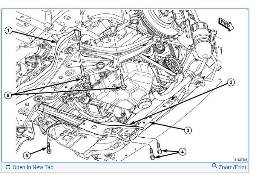

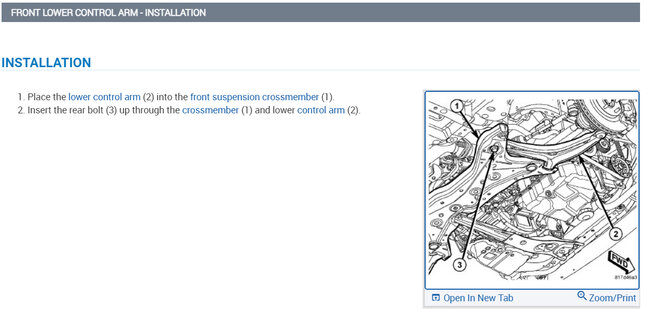

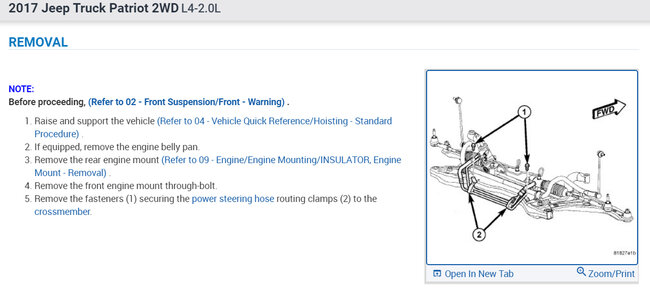

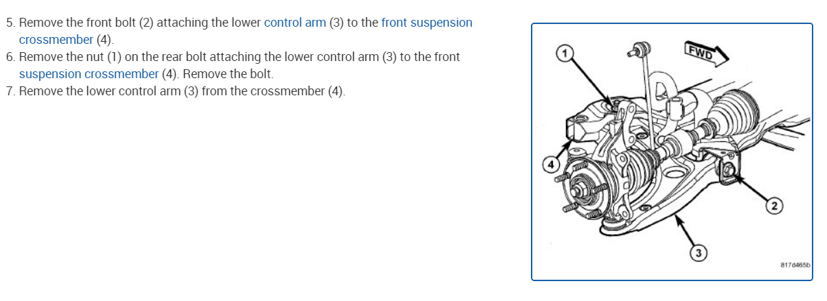

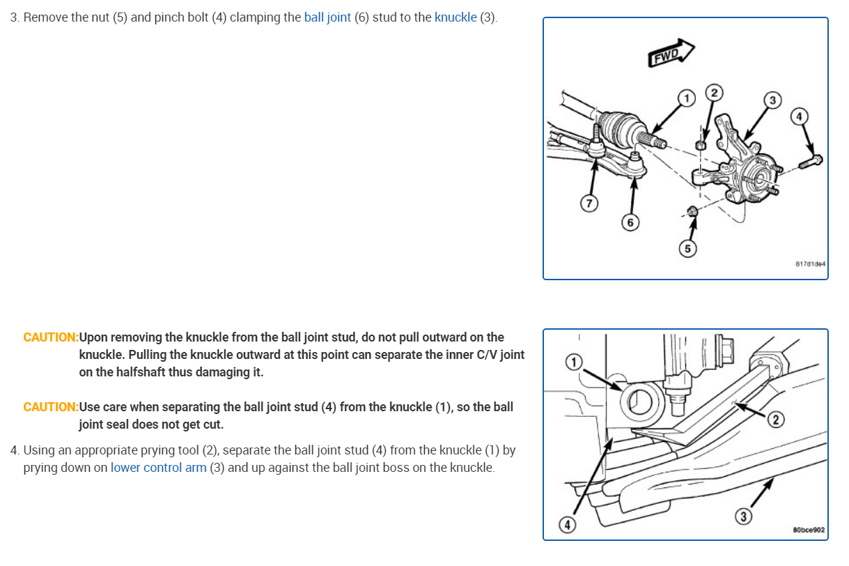

Here is how to install the lower control arms correctly. Check out the images (below). Let us know what happens and please upload pictures or videos of the problem so we can see what's going on.
Jun 20, 2023 at 5:15 PM

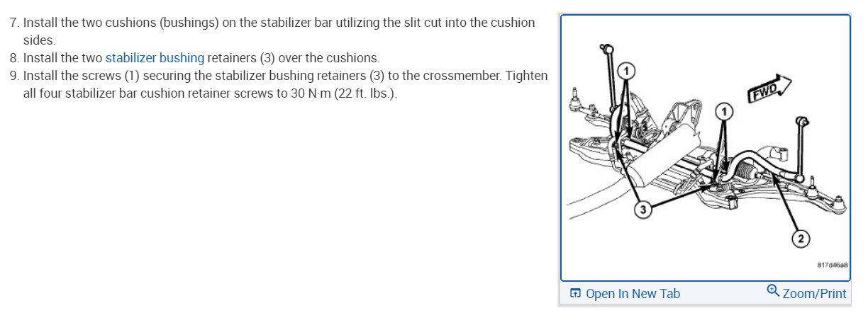

My fiancée and I went to a u-pull-it junkyard and got the stabilizer bar/sway bar from another Jeep Patriot. When we replaced the bar on my truck you could definitely tell the difference between the bar that came off of my truck because it was not only bent but the passenger side was lower than the driver's side and like I said before it was resting on the lower control arms but the new one is doing the same thing even though it is not bent and it has nothing wrong with it. Can you help me because I can't, for the life of me, find a diagram showing exactly where the bar is supposed to be. I have tried everything to keep it off but as soon as I connect the links on both sides it drops down. Please, I really need your help.
Jul 27, 2023 at 11:36 PM

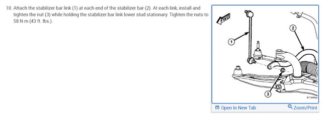

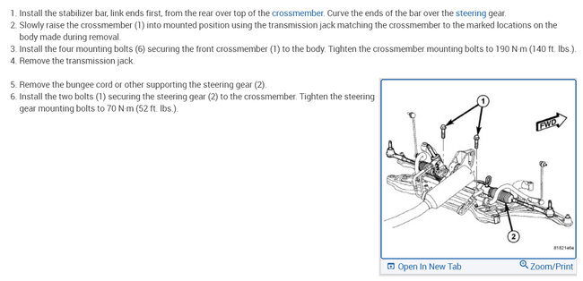

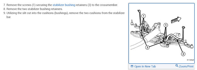

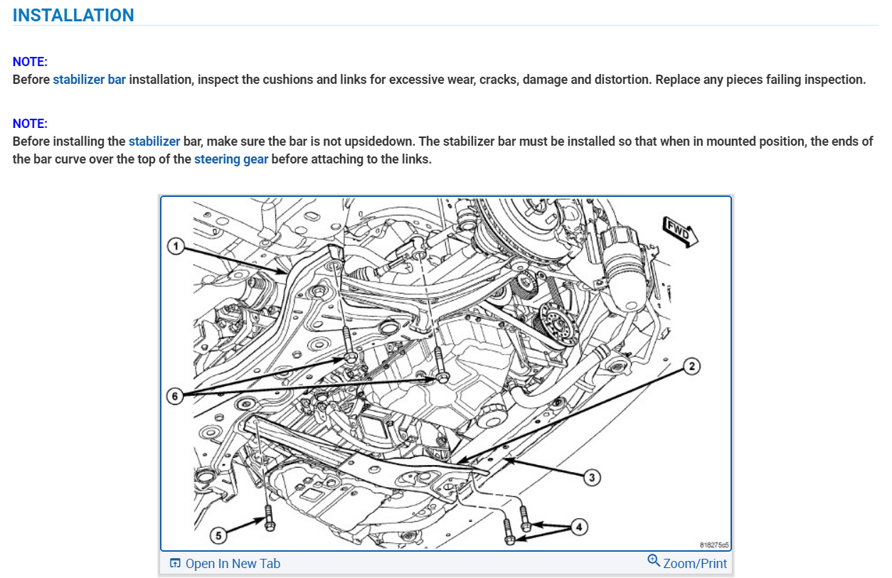

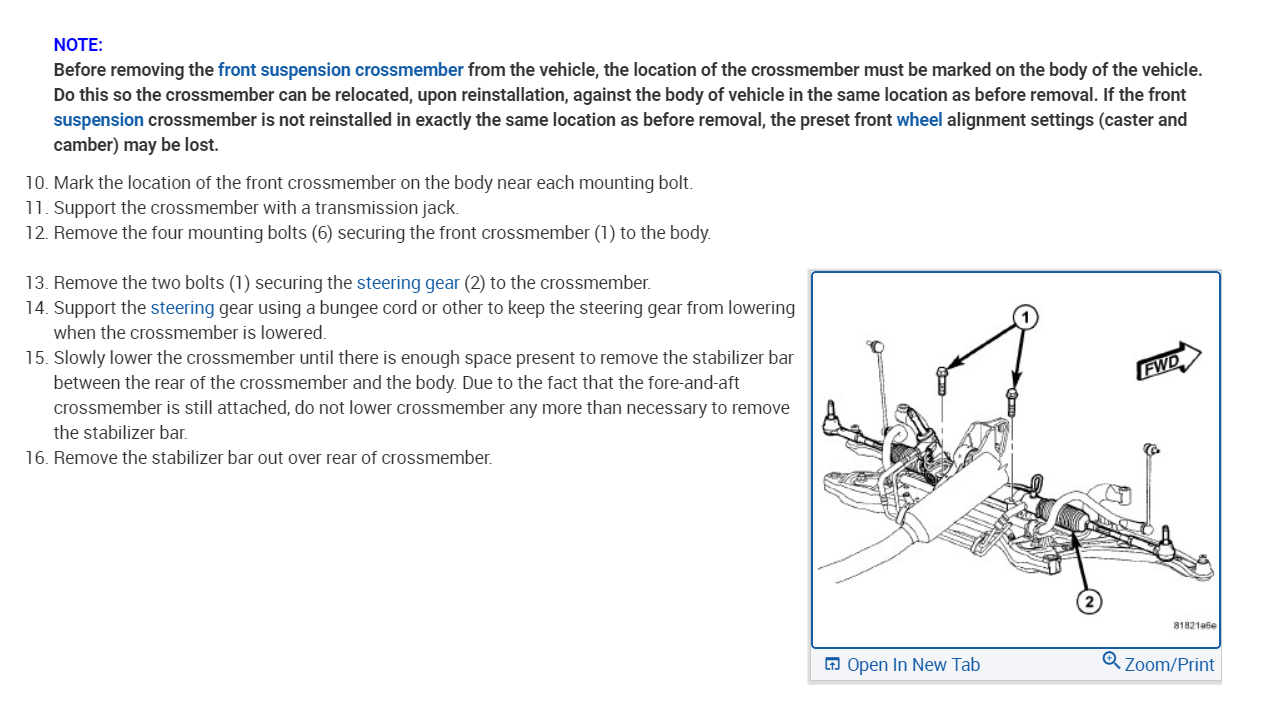

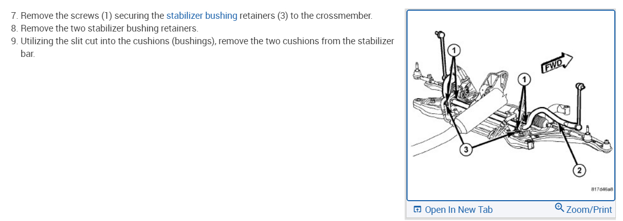

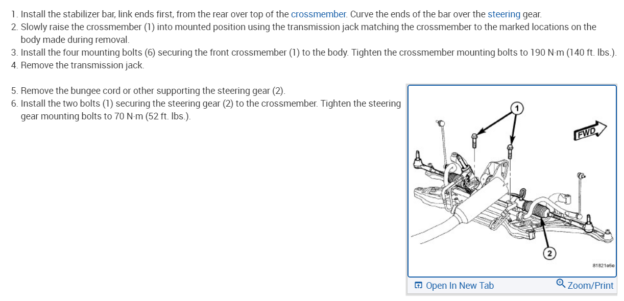

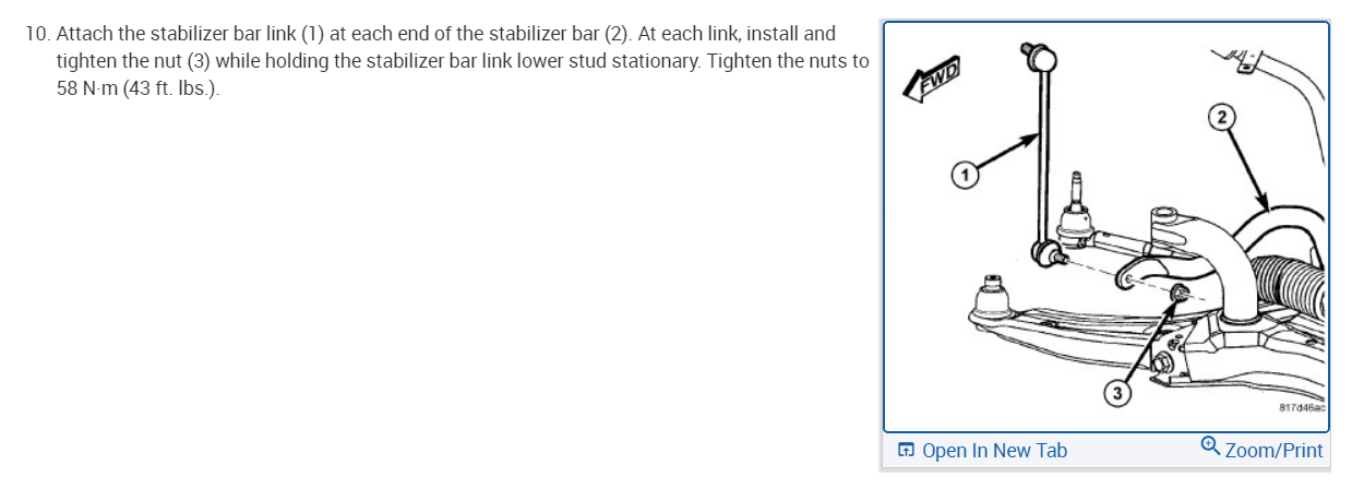

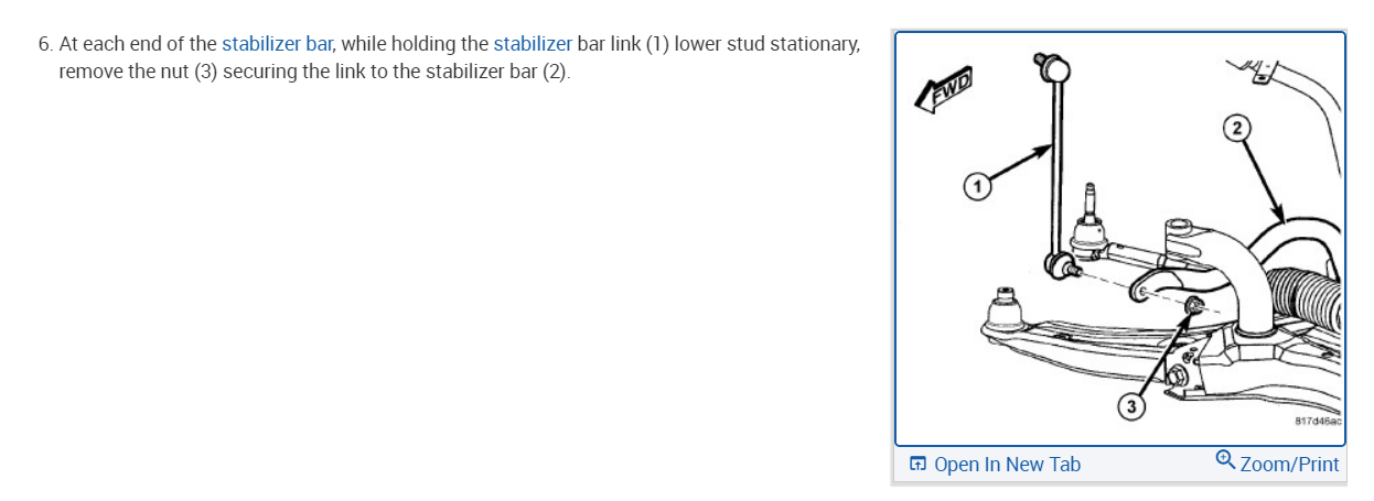

Can I ask if the vehicle has been in an accident? Here are the instructions on how to install the new sway bar. If the links don't line up something is bent. Check out the images (below). Let us know what happens and please upload pictures or videos of the problem so we can see what's going on.
Jul 28, 2023 at 10:54 AM

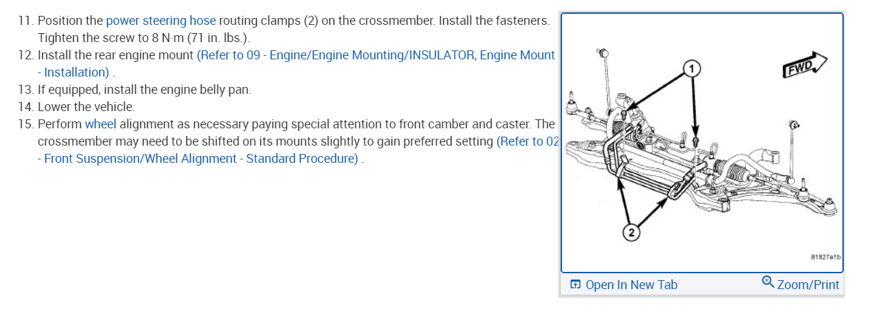

I replaced the stabilizer bar that was bent and put the new one on but just like the other bar this one is resting on the lower control arms, and I have tried everything to keep it off. Will the alignment printouts be able to guide me in the right direction to fix this as well?
Aug 16, 2023 at 1:05 AM
I don't think so, was this vehicle in an accident? Is the subframe bent as well?
