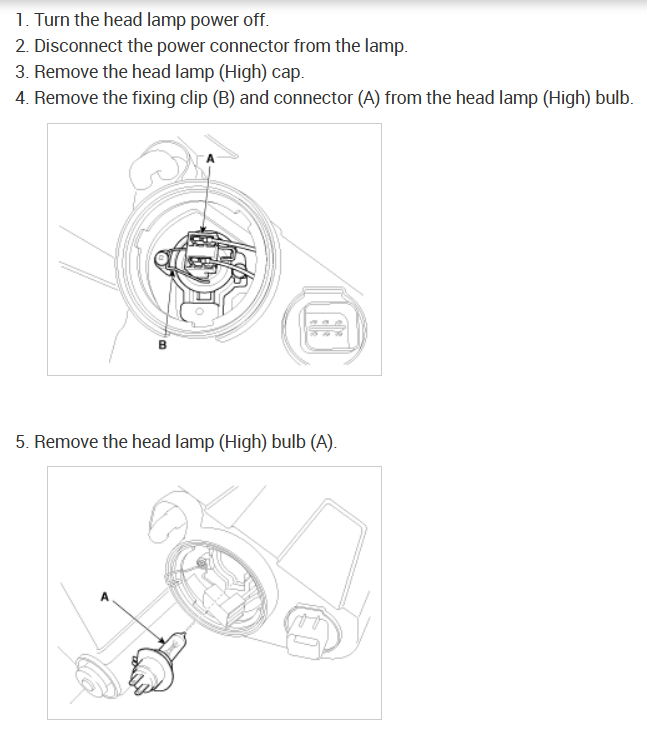

how do I replace the right front lowbeam headlight bulb?
Jan 27, 2026 at 5:26 PM

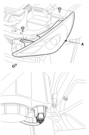

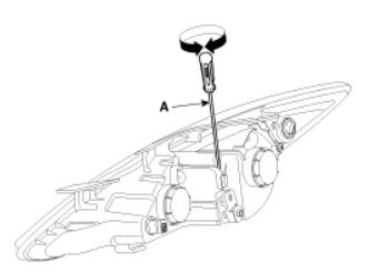

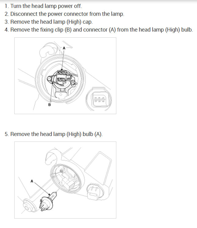

So. if you cant get to the rear of the headlight lens you might need to remove what is blocking you, and if not he lens will need to be removed which is 3 small bolts/screws. There is a cap you will need to remove with a simple clip. Check out the images (below). Please upload an image or a short video in your response, so I can see what's going on.
