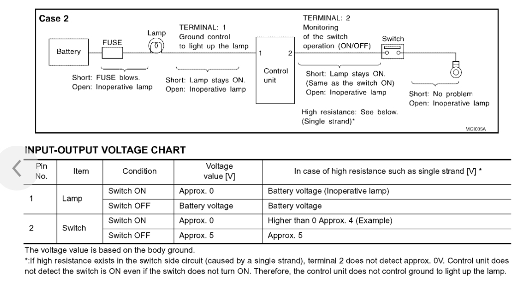

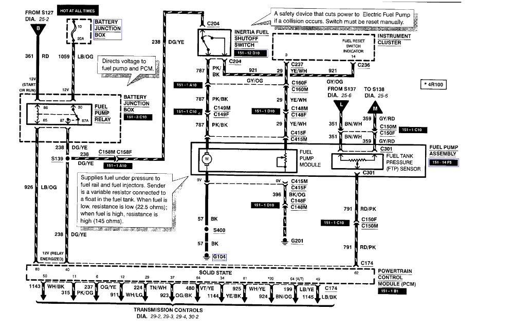

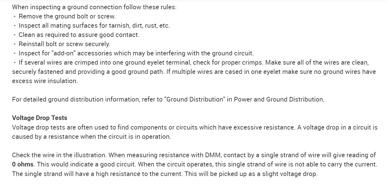

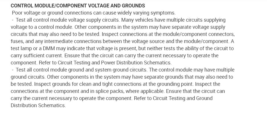

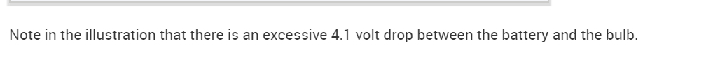

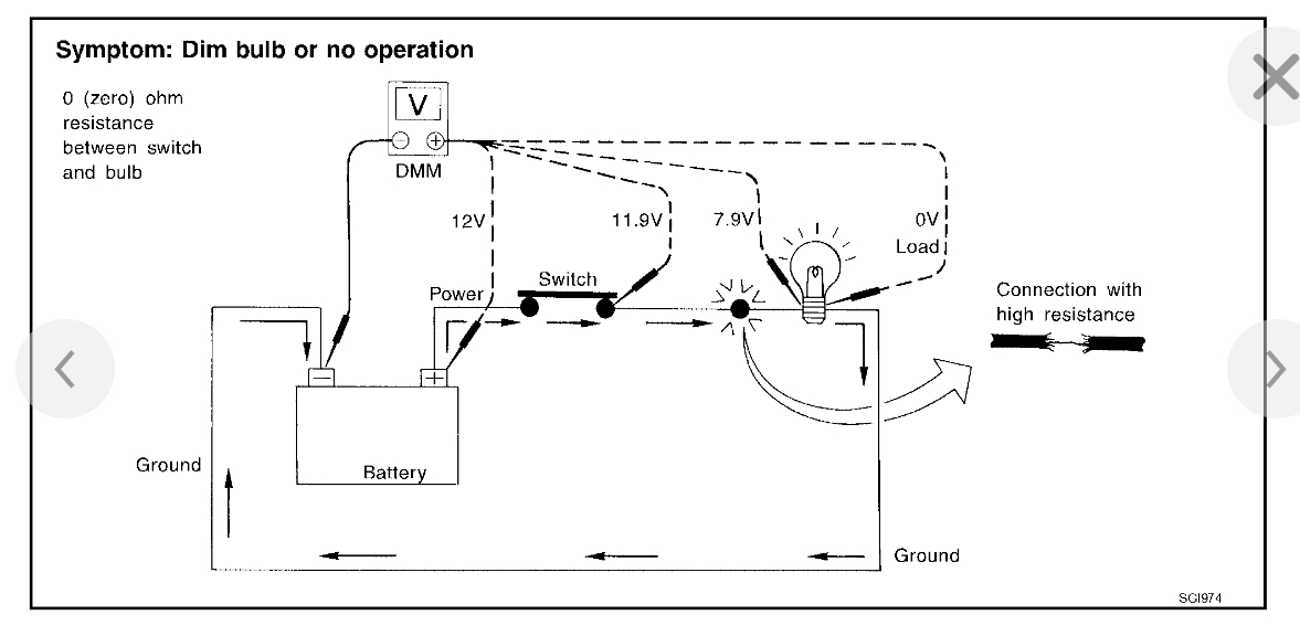

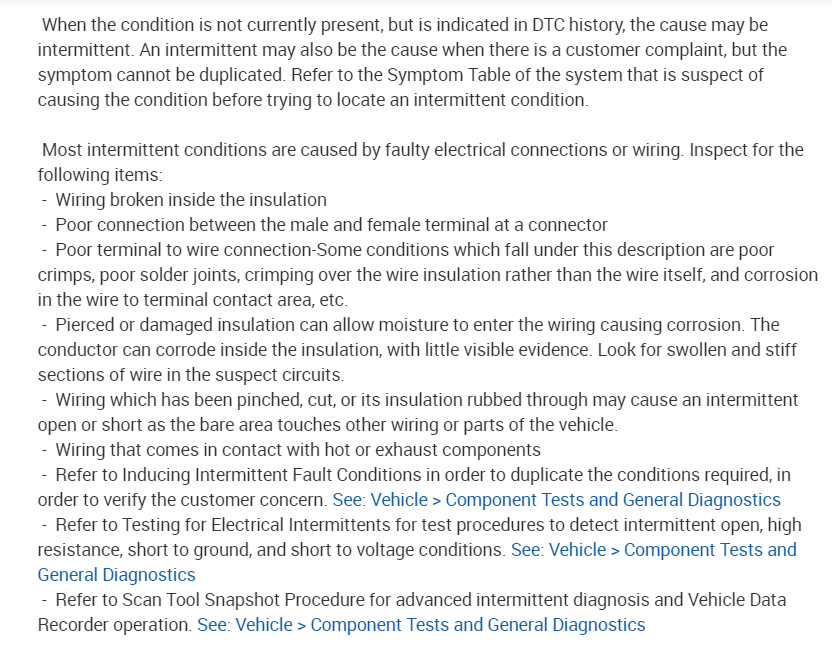

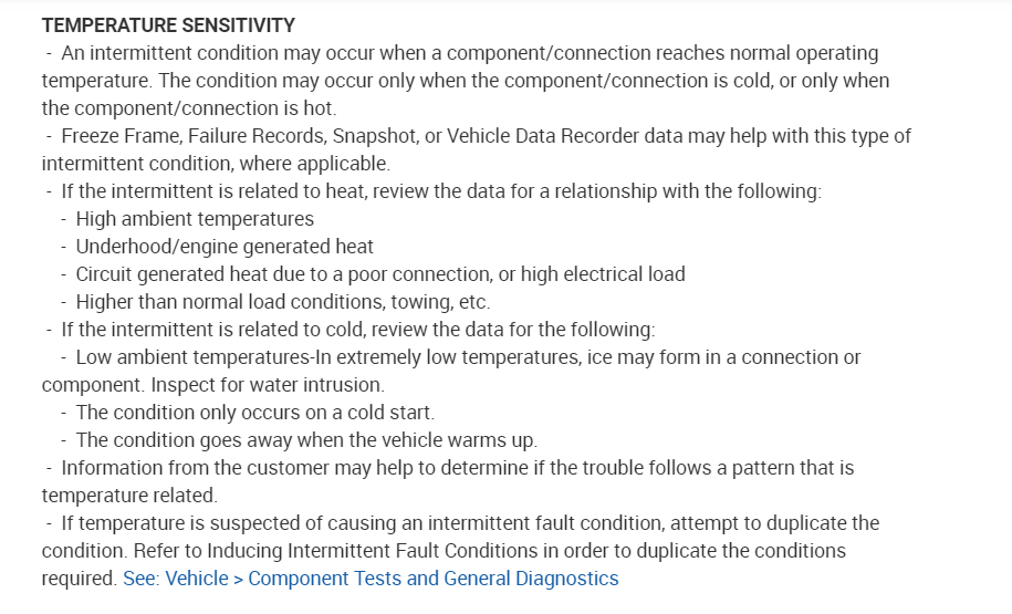

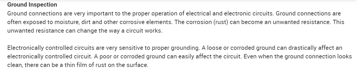

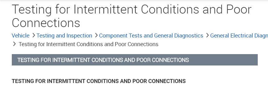

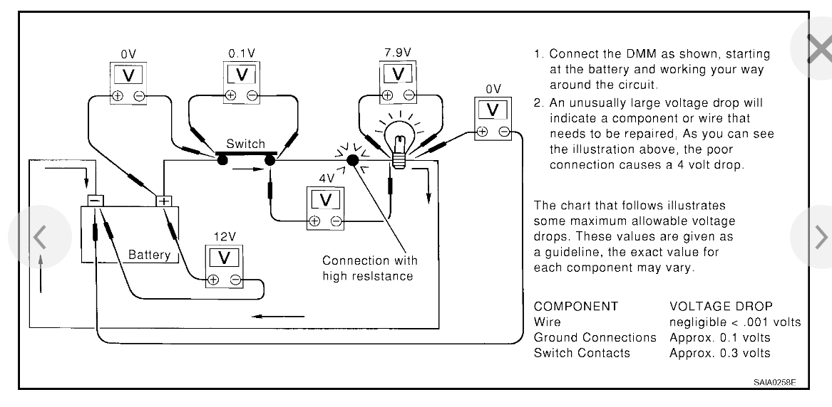

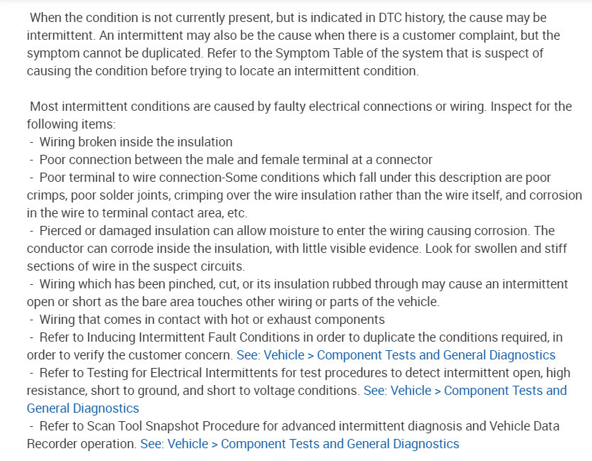

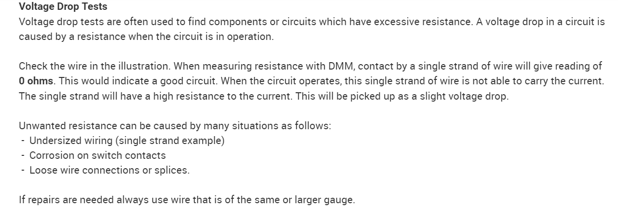

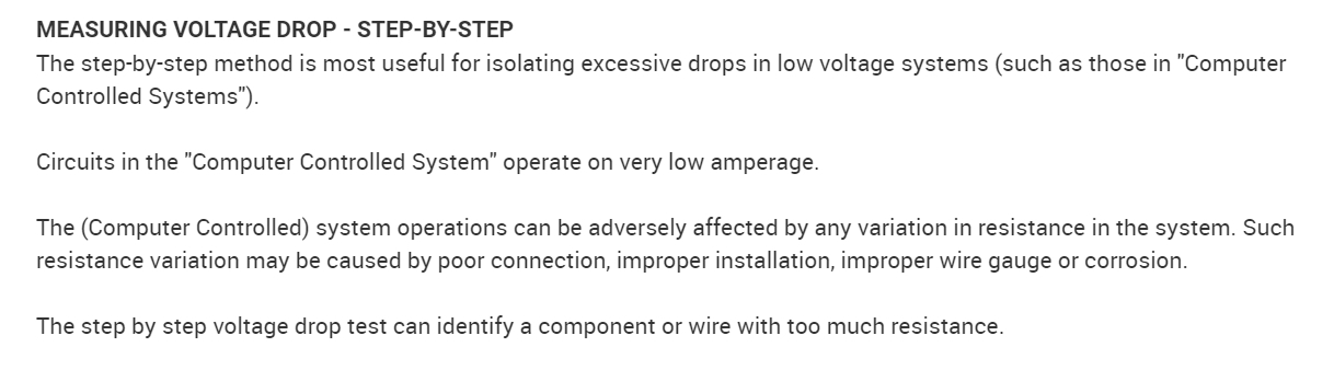

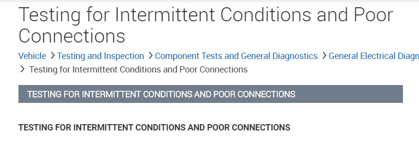

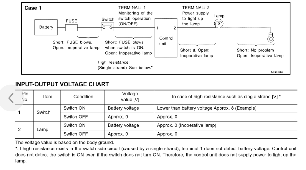

Okay, this is definitely a case of unwanted resistance somewhere in the fuel pump circuit. In the diagrams down below I have included a wiring diagram of your vehicle's fuel pump circuit, a guide for intermittent and poor electrical connectors, and the preferred way to find unwanted resistance in an automotive electrical circuit, voltage drop tests. I have also included a guide for checking grounds. Please go through these guides and get back to us with what you are able to find out.
Thanks,
Alex

Thank you. checking it out now, have same voltage at inertia switch 6.8 volts heading to relay socket now.
Oct 12, 2019 at 8:30 AM
RSS9099
  • 8 POSTS
Okay, so here is what I found so far: I jump out pin 30 to pin 87 I get 12v. through to fuel pump connector. Put relay in I get 6.8 volts on green yellow wire and at fuel pump connector. I put a new relay in same thing. What else could be drawing voltage with resistance in this circuit and can I bypass any of this to make it work?

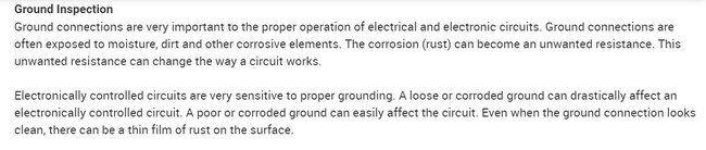

Hello again,

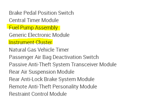

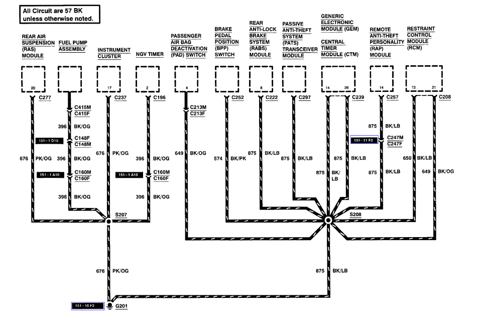

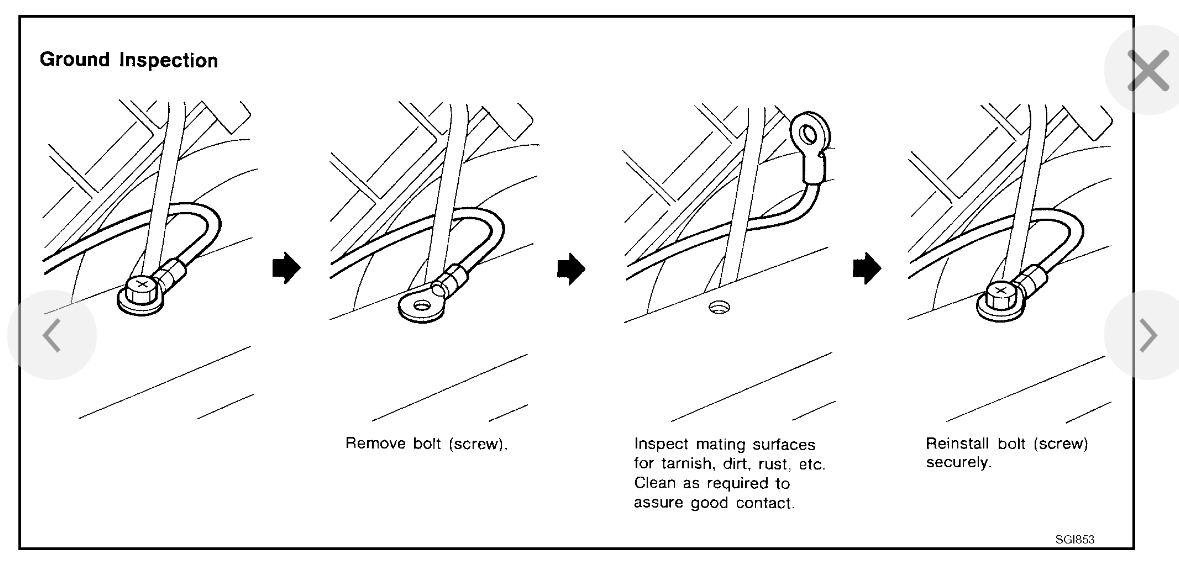

This could be a problem with Ground 201. In the diagrams down below I have included a ground distribution wiring diagram for the fuel pump assembly and the instrument cluster as well as a guide explaining how to inspect grounds. Please go through these guides and get back to us with what you are able to find out.
Thanks,
Alex

Hello again,
Yes, this was taken into consideration. Power-train Control Modules [PCM][s] control components by providing and taking away ground paths. Your vehicle's PCM controls the fuel pump relay by providing a ground path or taking it away to Pin 85. The coil on the control side of the relay will be energized when the switched power from the ignition key goes to Pin 86 and the PCM provides ground to Pin 85. In this way the PCM can turn the fuel pump off after it primes the fuel system for a couple of seconds when your vehicle's ignition key is turned to "run" and then you don't start the vehicle immediately. Please check the ground and report back with what you find out, please. P.S. In my first reply I included a wiring diagram where you can see the fuel pump relay and follow how it works. It is a 5 pin relay.
Thanks,
Alex
2CarPros

thank you for your help. I see that the fuel pump and instrument cluster ground through the same point G201 and point S207. any idea on my 1999 F250 where that may be?
