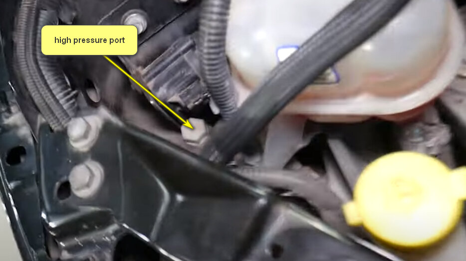

On the Fiat 500 the high-pressure port is located next to the coolant expansion bottle. see image 1

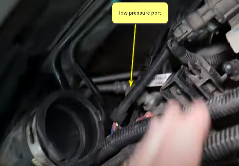

The low-pressure port is located on top of the AC compressor.
To access this port, you will need to remove the air filter housing.
It is located at the rear of the engine, passenger side, covered with a grey cap. see image 2
