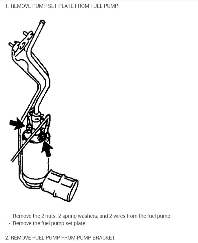

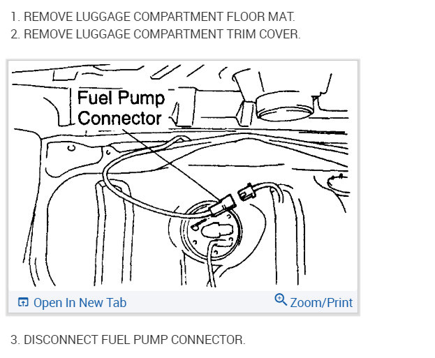

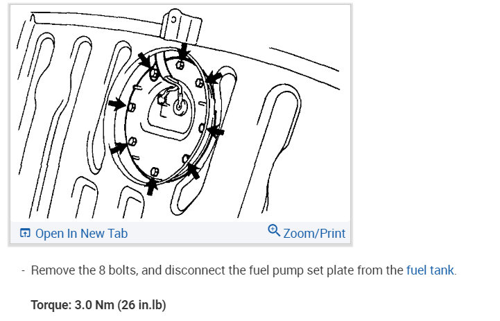

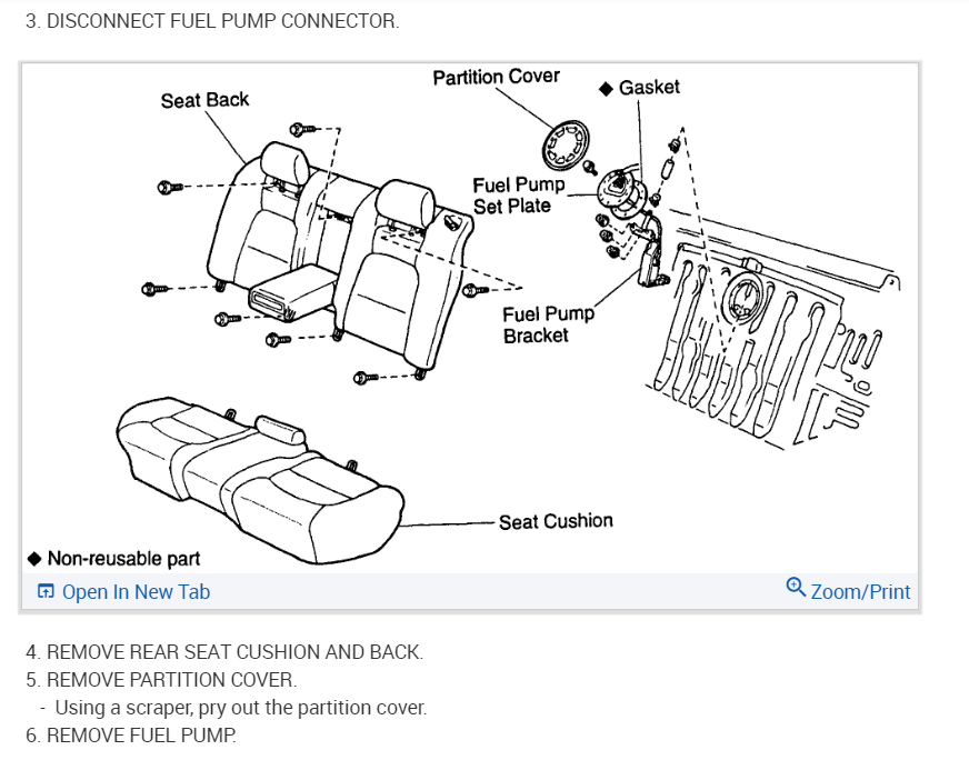

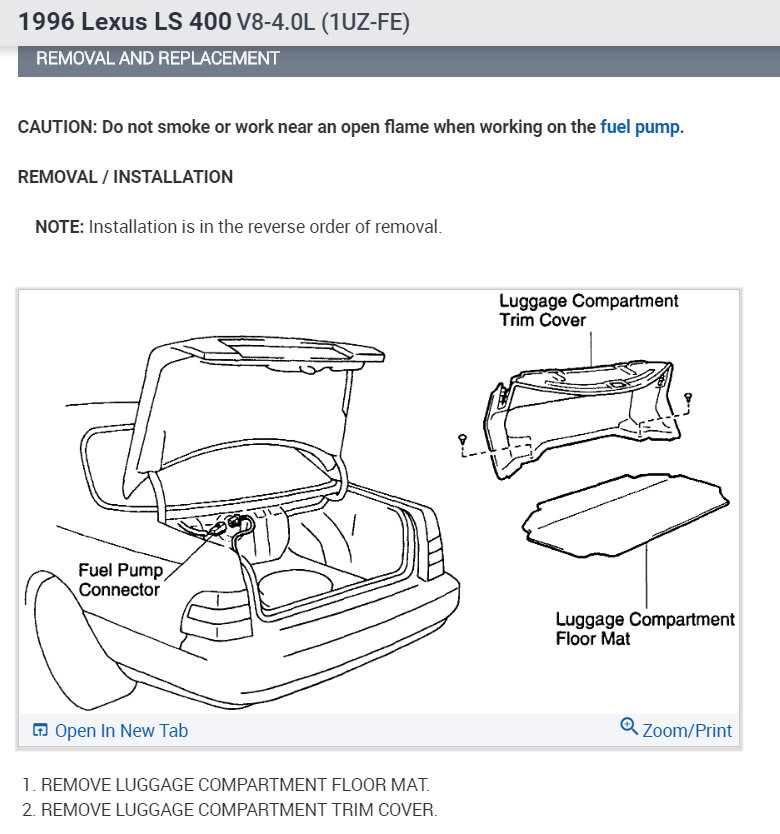

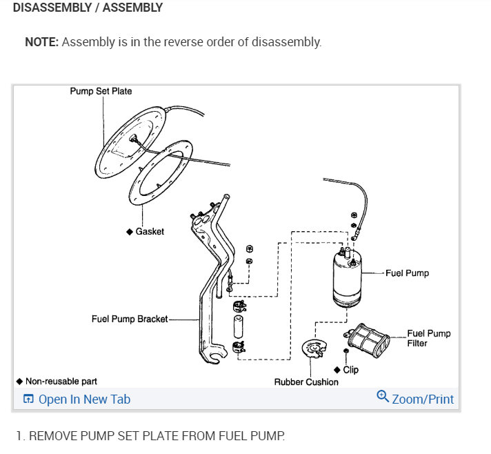

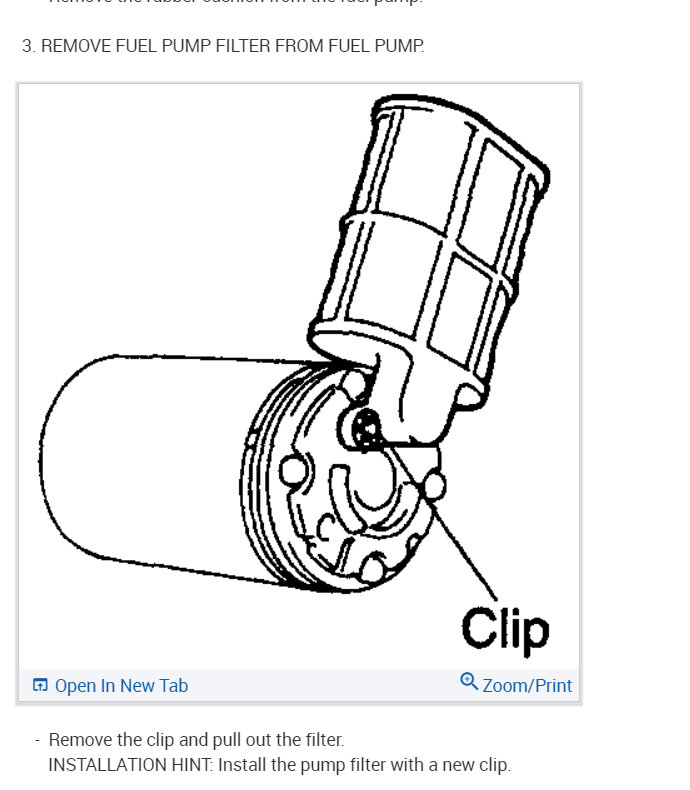

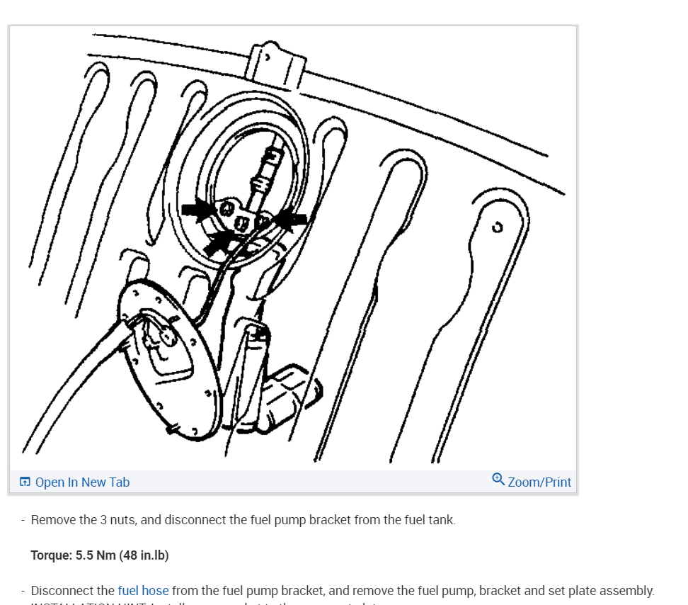

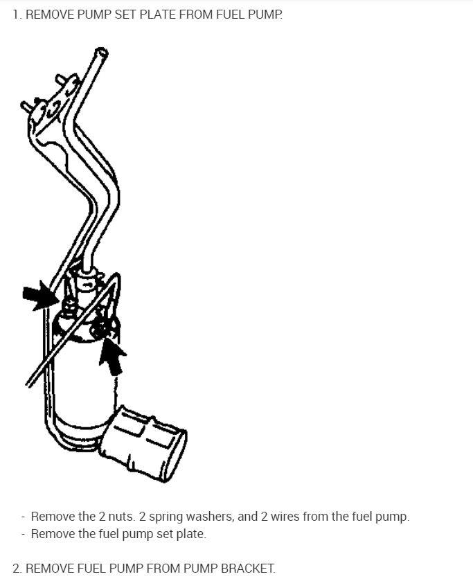

This sounds like you have a fuel pump going out. To be sure we need to check the fuel pressure. Here is a guide to help and instruction below on how to change the pump out:
These guides can help as well:
https://www.2carpros.com/articles/engine-has-low-power-output
