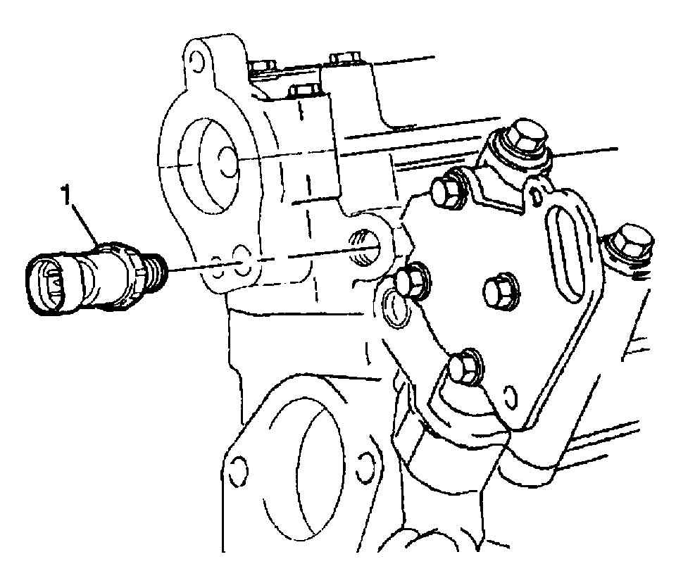

However, if you find the sending unit is bad, here are the directions for replacing it. The attached pics correlate with the directions.
______________________________________
2000 Pontiac Grand AM L4-144 2.4L DOHC VIN T SFI
Engine Oil Pressure Sensor/Switch
Vehicle Powertrain Management Sensors and Switches - Powertrain Management Sensors and Switches - Computers and Control Systems Oil Pressure Sensor Service and Repair Removal and Replacement Engine Oil Pressure Sensor/Switch
ENGINE OIL PRESSURE SENSOR/SWITCH
Removal Procedure
^ Tools Required
- J 35748 Oil Pressure Sending Unit Socket
pic 1
1. Turn the ignition OFF.
2. Remove the electrical connector.
3. Remove the engine oil pressure sensor (1) using J 35748.

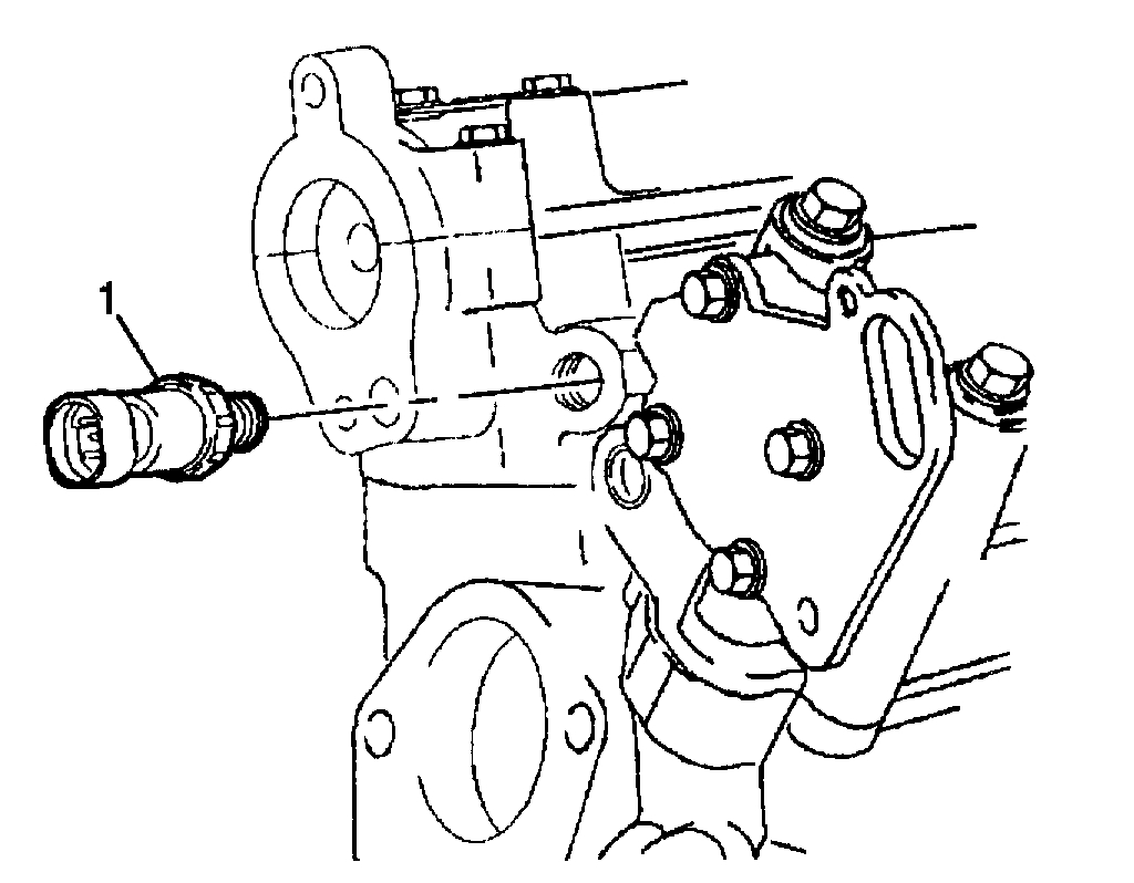

Installation Procedure
pic 2
1. Coat the threads with sealer.
Notice: Refer to Fastener Notice in Service Precautions.
2. Install the engine oil pressure indicator sensor (1) using the J 35748.
^ Tighten the engine oil pressure indicator sensor to 12 Nm (106 inch lbs.).
3. Install the electrical connector.
