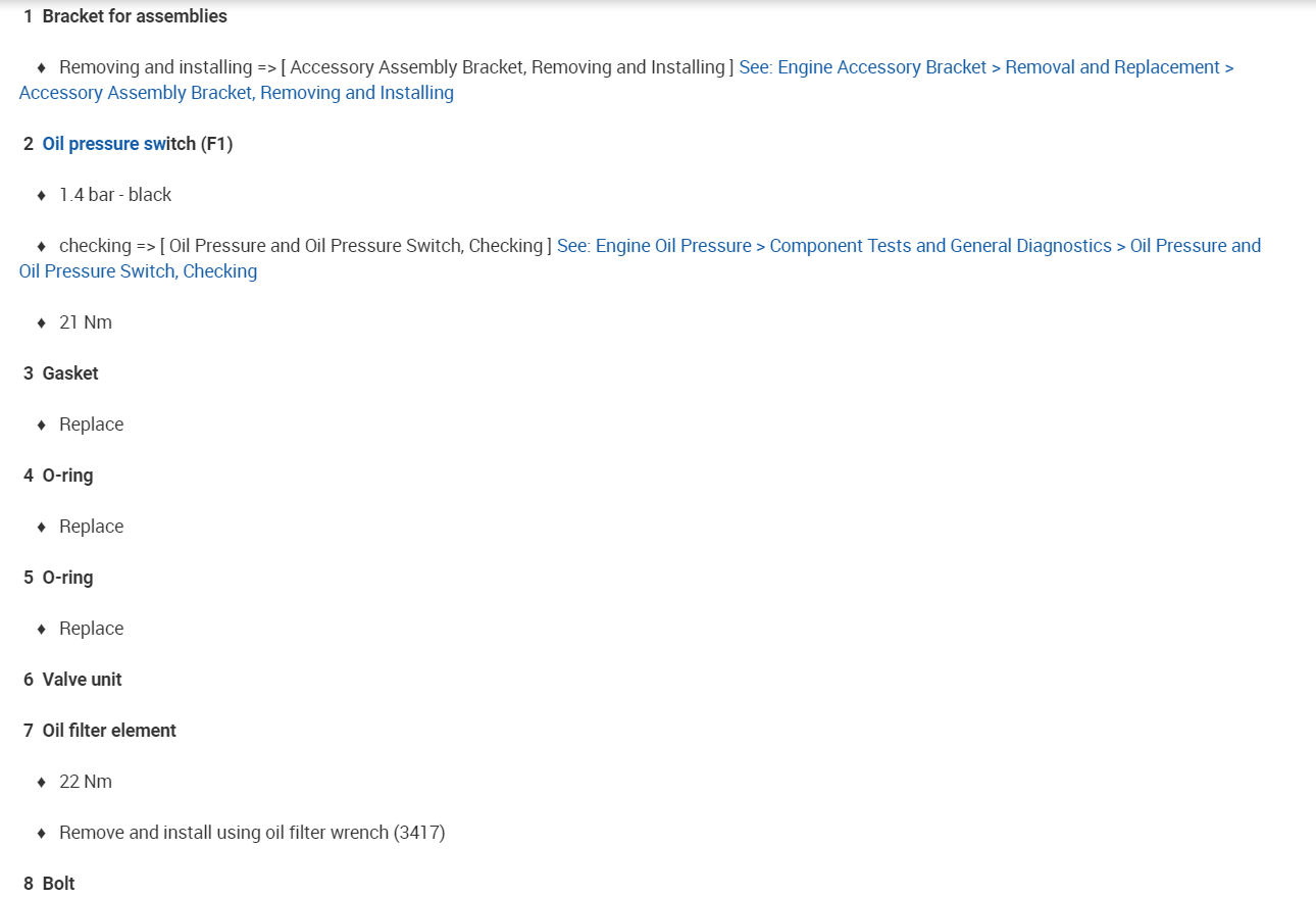

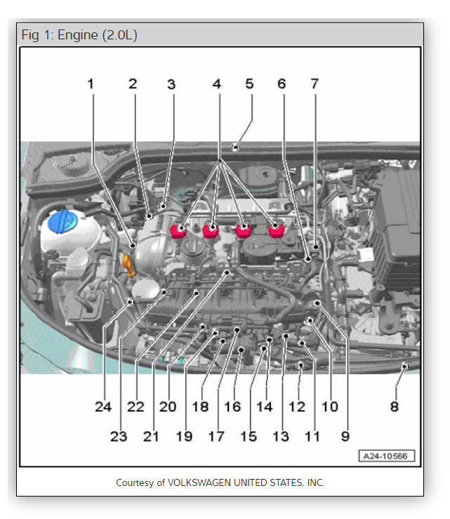

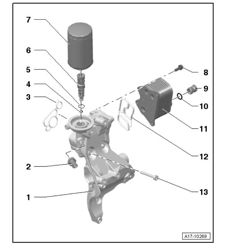

When you did the pump did you replace or make sure the pick up screen was clean? If so we need to remove the sender and install a manual gauge (auto parts store will rent one for free in most cases) to see what the pressure actually is. I would try replacing the oil filter as well. Here is the sensor location in the diagrams below #24. Check out the diagrams (below). Please let us know what you find. We are interested to see what it is.

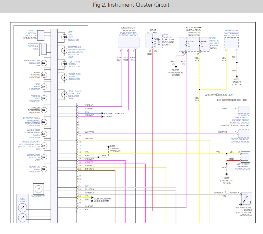

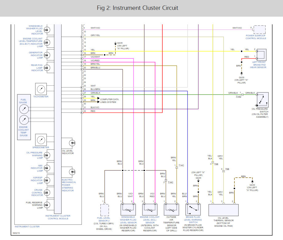

The oil pressure sender wire goes directly into the instrument cluster so the cluster could be bad causing the issue 35 psi is fine for the oil pressure by the way. I would try testing to wire to the cluster here is a guide and the wiring diagram to help with the test. You want to do a omh's test. Also check it to ground as well to make sure there are no shorts anywhere. If it is okay I would get a used/rebuilt cluster.
