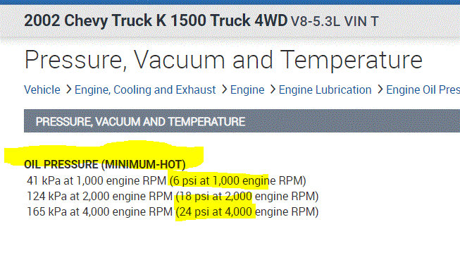

That's a good question to ask. Honestly, it isn't below what the manufacturer indicates as a problem, so even though it is low, it won't likely make noise. With the engine hot and at idle (1,000 RPMs) the minimum recommended is 6 PSI.
If you look at the pic below, it shows what the minimum readings should be with the engine at operating temperature and at specific RPMs.
See pic below.

Yep, that's what I expected. The only thing I recommend is to make sure you keep the oil clean and full. It's hard to believe that the manufacturer indicates 6psi okay at 1,000 RPMs. It does seem a bit low, but that's what they indicate.
If something changes or if you have other questions, please feel to let me know.
