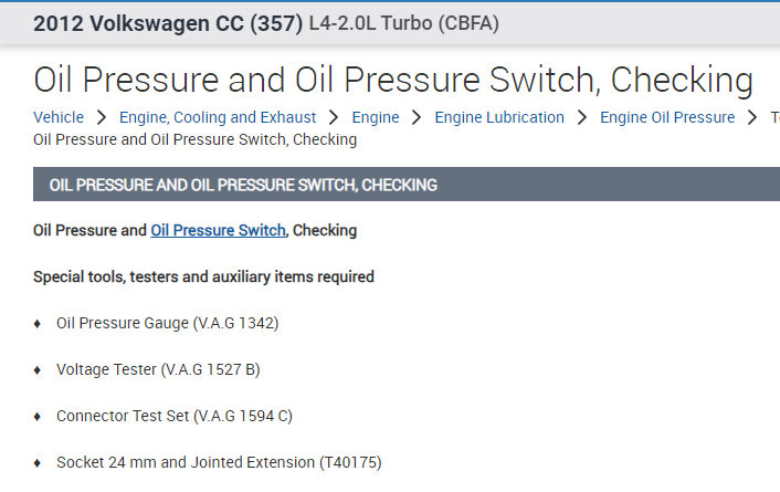

Have you checked for diagnostic trouble codes? Also, they don't provide us with the specific voltages for testing. Instead, it requires a specific fuel pressure gauge.
As far as a power signal voltage is concerned, I would suspect it to be 5v.

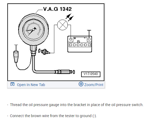

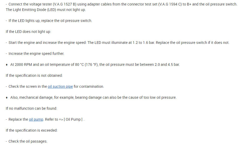

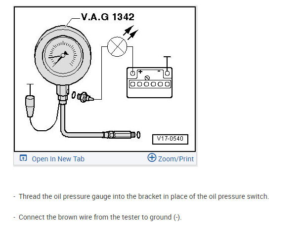

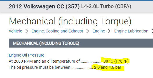

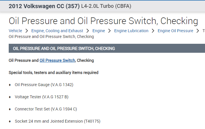

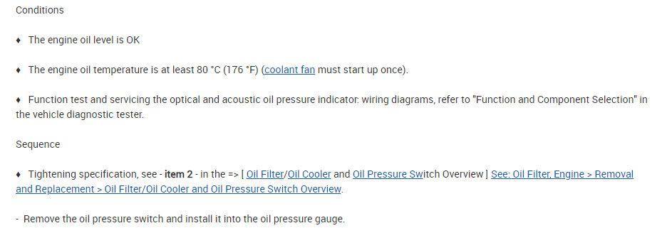

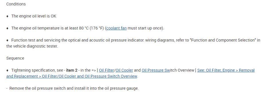

I attached the directions below for testing. Take a look and let me know if you are comfortable performing them.
See pics below.
