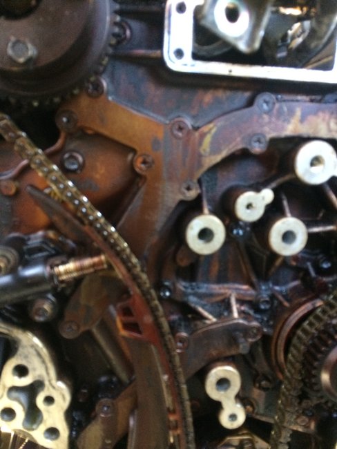

My timing case had oil (see the photo) in it and didn't look like everyone else's online, which is why I thought that it was the main oil gallery. In addition to the low oil pressure and the loss of power, It seems that my noise occurs when it is warm and I hit the gas (with a slight delay). I think i'm hearing slack in the timing chain (which is why I think that the timing chain guide broke originally). Here is a photo of the timing chain case prior to when I repaired the main timing chain guide. You can see there is dried oil in the case. I thought it was really odd when I had it open. This is why, more recently, I thought it might be an oil gallery leak causing my pressure loss.

what you see is sludge and varnish and can be from oil used or how often changed etc. also re reading you rfirst question it says after you replaced timing chain so I would suspect either a pump problem or partial blocking of pump pickup or an air leak there.if you take the pump off pack gears with Vaseline prior to starting as well and make sure pickup has good connection to pump. but i'd try 20w oil first prior to taking pan off see what you get there, if it still drops then it may very well be a bearing problem.

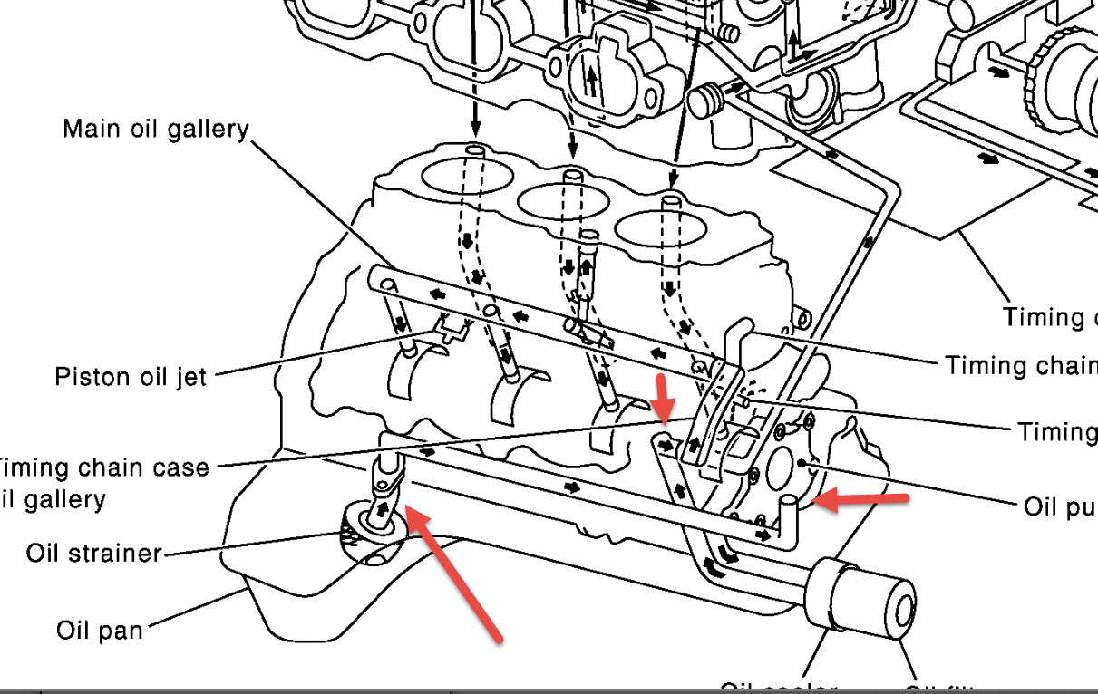

I am really out of ideas from the diagram i'm sending the oil lines go no where near the rear cover so I would rule that out and I see no tips from other mechanics for this problem. If I were you and you REALLY want to put the time and energy into this then where arrows point I would look for a problem there or partial blockage. because if it's cold and has good pressure then gets warm and drops but from your testing the second number is warm i'm assuming so with heavier oil in it drops about 10 psi so it leads me to a bearing problem. or leaking where I've pointed out that is all I can think of. from the factory chart shows only 14psi at 2000 rpm when warm and ALL oil will drop when warm see pics
