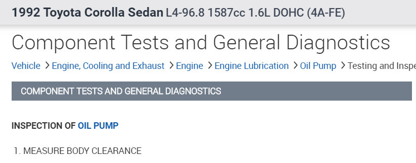

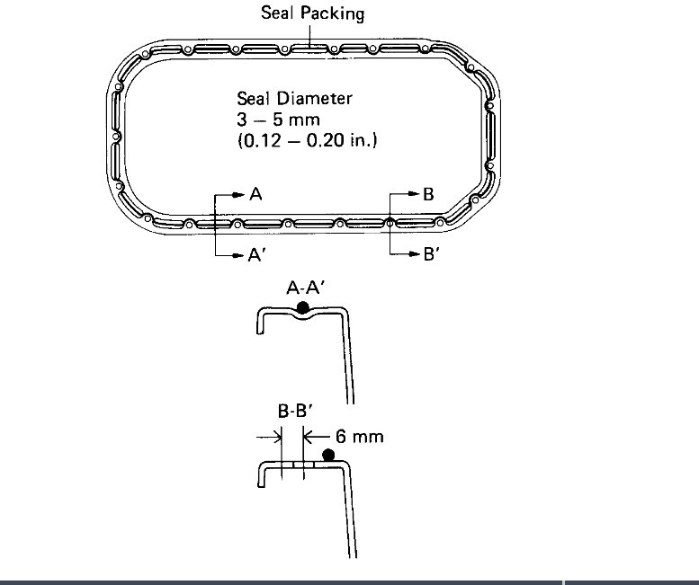

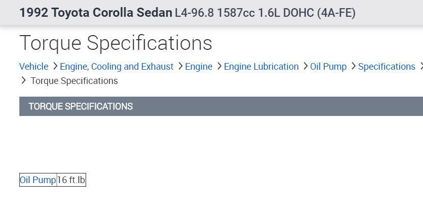

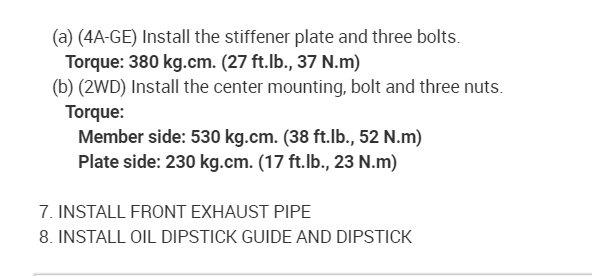

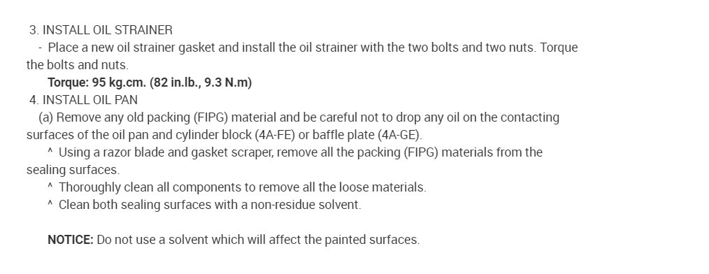

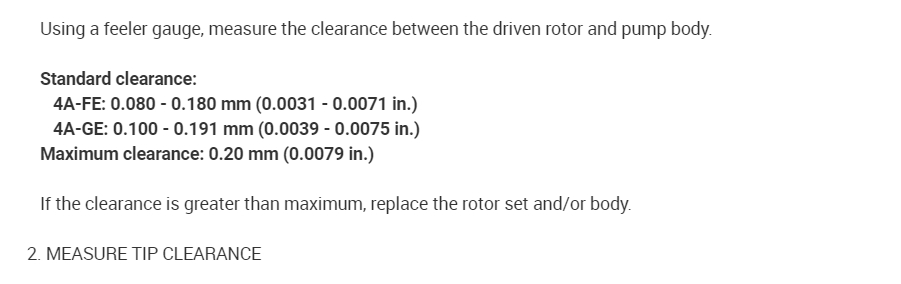

Hello again,

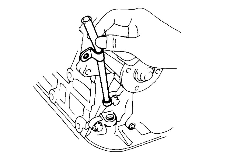

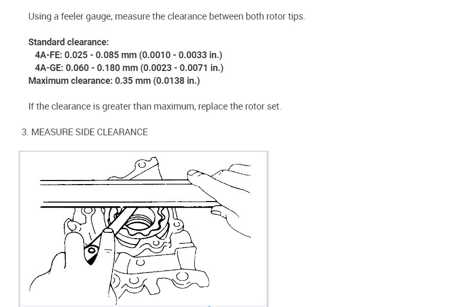

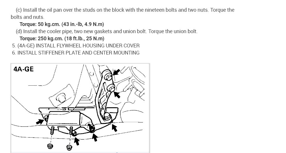

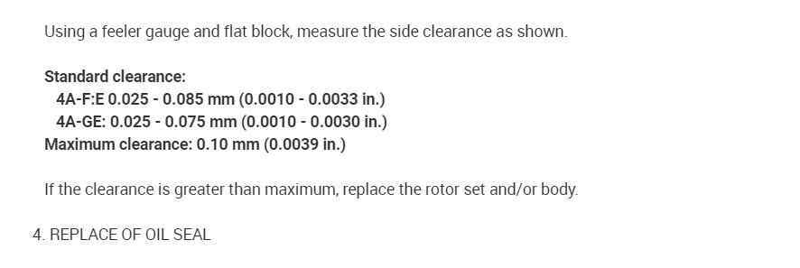

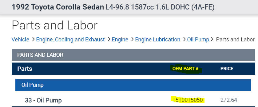

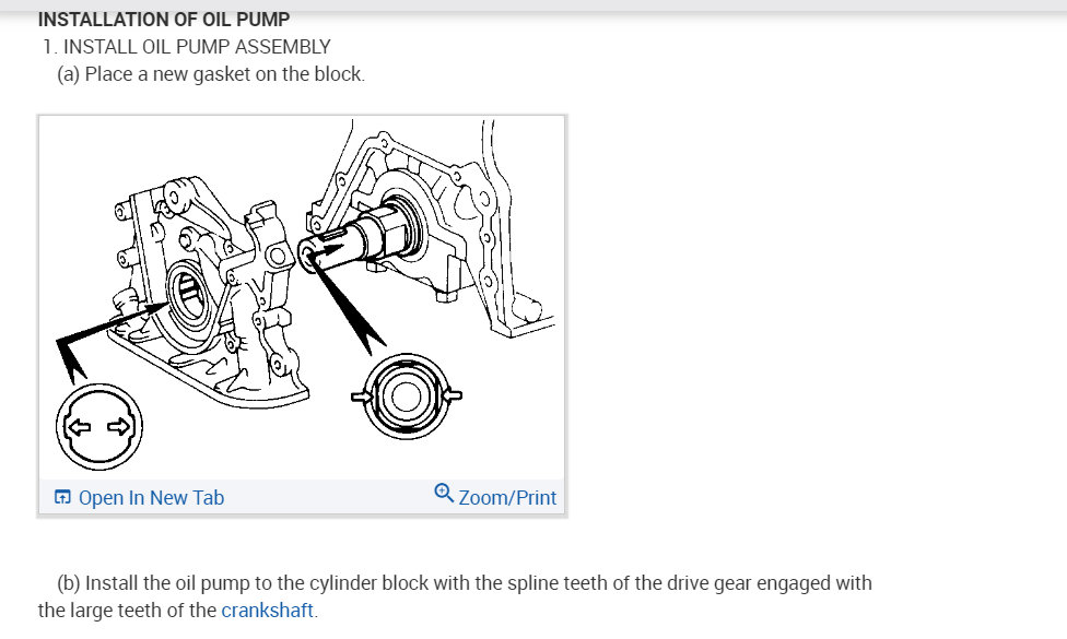

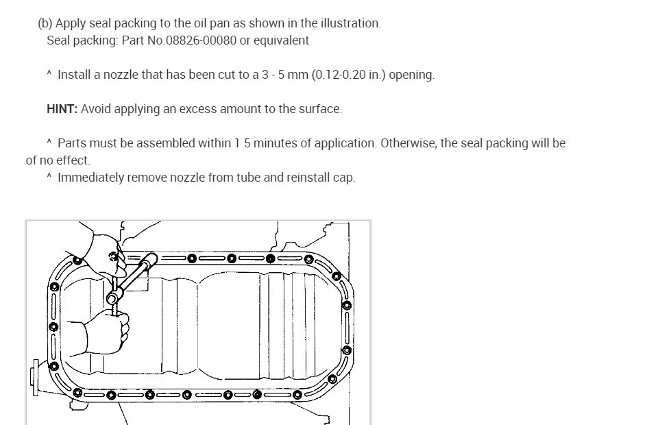

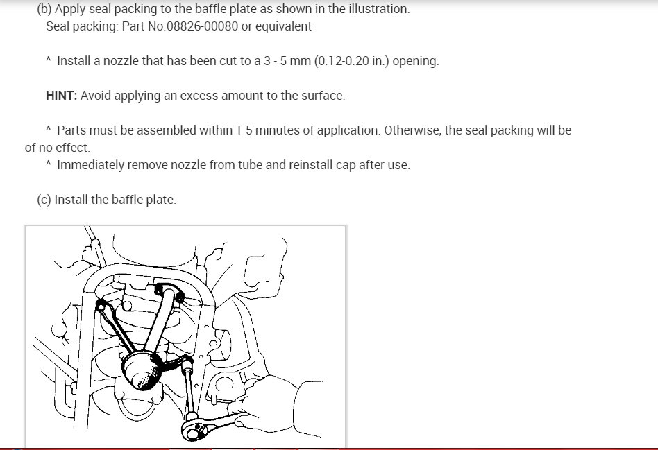

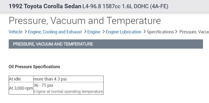

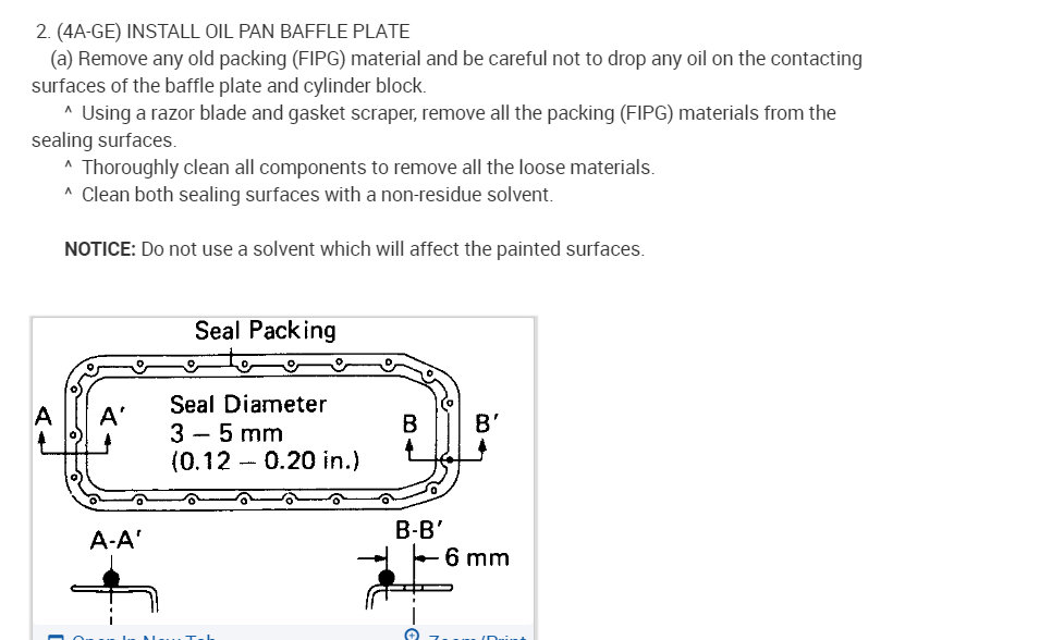

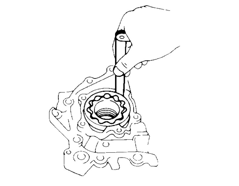

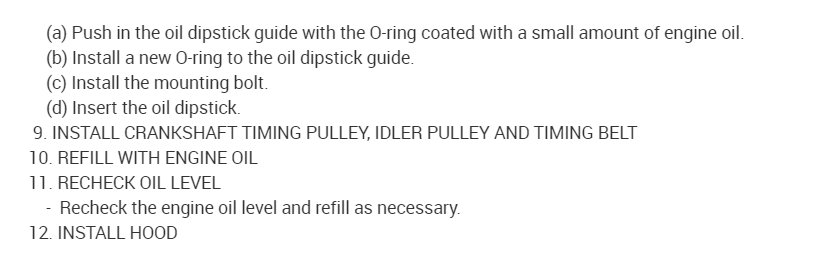

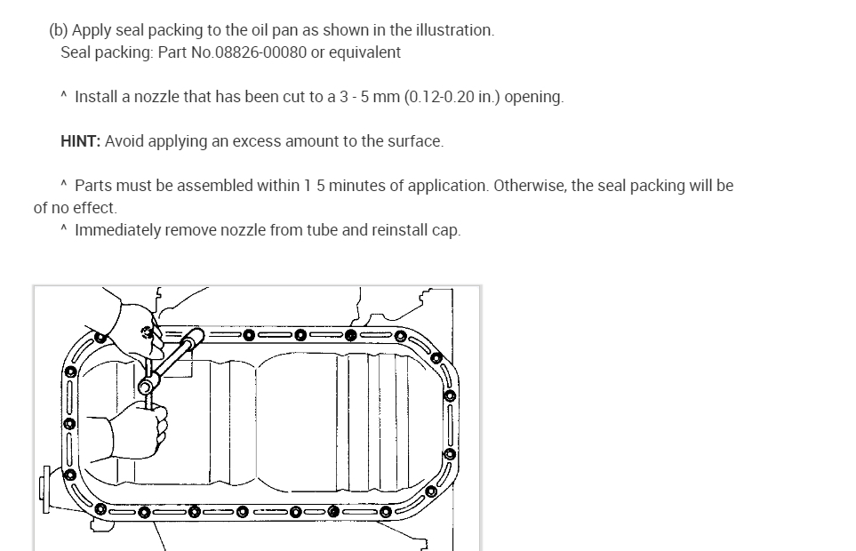

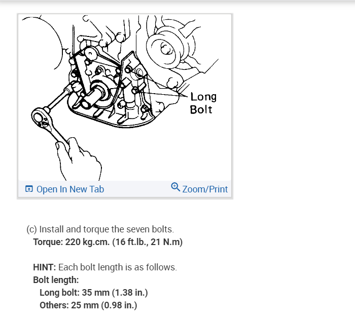

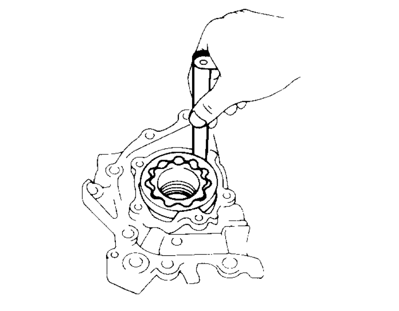

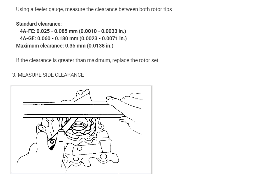

Okay, that's good. In the diagrams down below I have included the Original Equipment Manufacturer [OEM] part number, as well a specs, and a guide on the proper way to install your vehicle's oil pump. Please double check that the correct part was purchased and that the installation went according to the guide and get back to us with what you find out, please.
Thanks,
Alex
