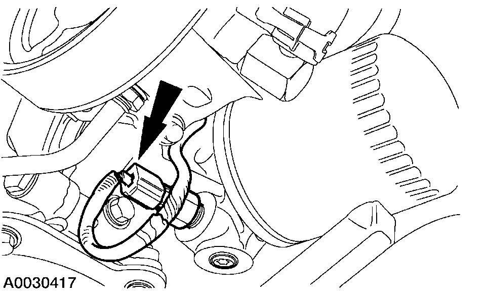

If the oil is clean and full and there is no noise coming from the engine (knocking or ticking) my first suspect is the oil pressure switch. Often times, the crimp which holds the switch together will loosen, cause a leak, and then the pressure drops because oil is bypassing the switch via the leak.

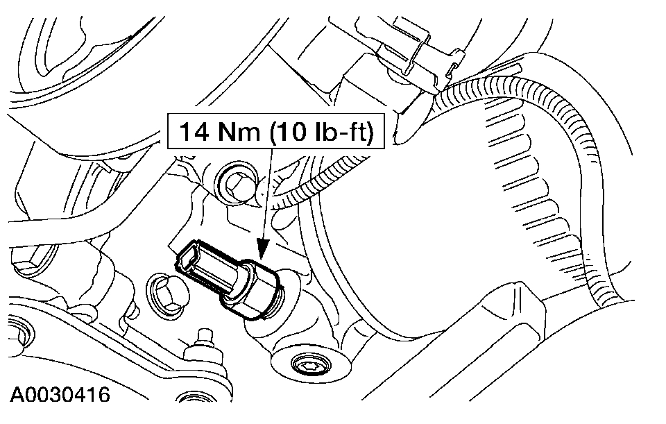

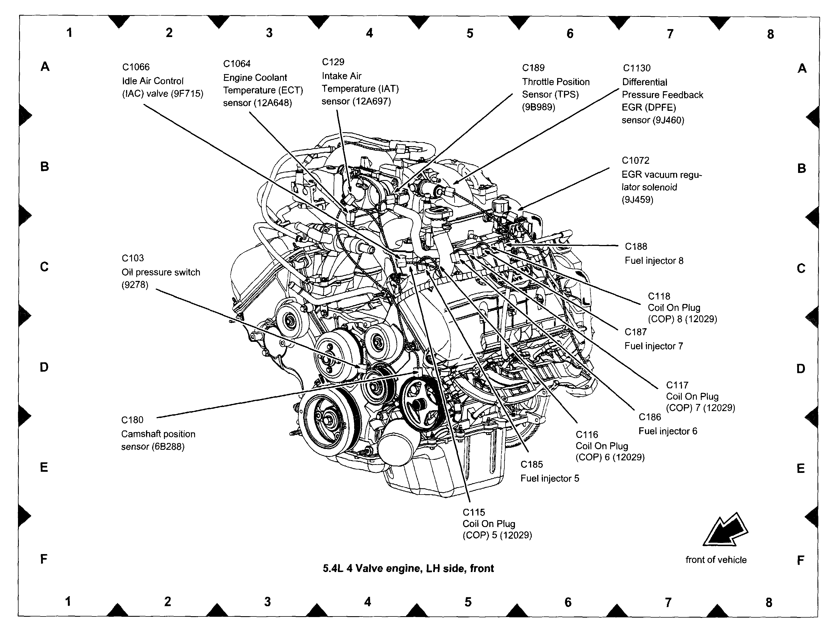

Here are the directions. The switch is near the oil filter. All attached pictures correlate with these directions.
___________________________
Oil Pressure Sender
Removal and Installation
1. Raise and support the vehicle.
2. Disconnect the oil pressure sender electrical connector.
3. Remove the oil pressure sender.
4. NOTE: If reusing the sender, clean the threads and coat the oil pressure sensor threads with pipe sealant.
To install, reverse the removal procedure.
________________________________________________
Let me know if this helps.
