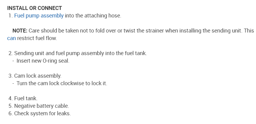

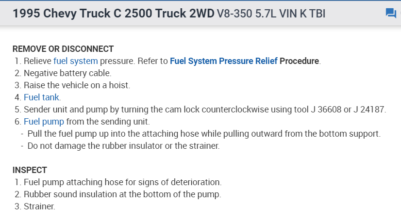

As I stated earlier in the post the fuel pressure should be 9-13 PSI. Having only 2 PSI shows the pressure to be way too low. It sounds like a weak or malfunctioning fuel pump.Here is a tutorial to view for changing an in-tank fuel pump:
I've attached 2 picture replacement steps below showing what is involved.Hope this helps and thanks again for using 2CarPros.
