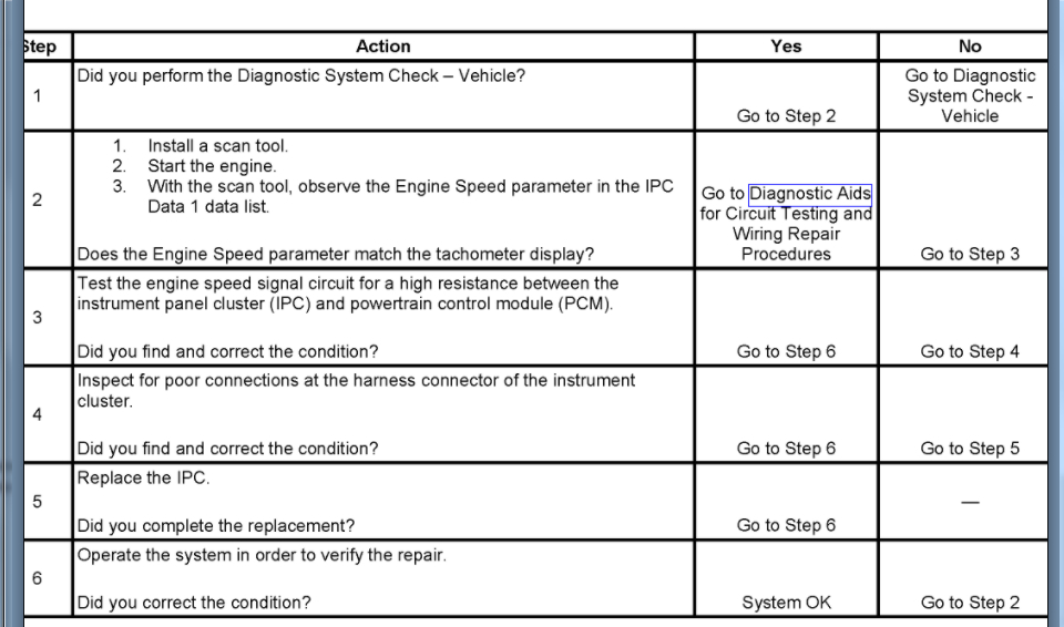

I am attaching the testing that we need to run through. More then likely this is a connection issue at the cluster or the cluster itself. Your tachometer runs off of a message from the PCM so it is not like there is a cable or speed sensor that could be faulty. The PCM gets the engine speed from the crank sensor and send it to the cluster to display.
If the truck runs fine then I suspect it is just a cluster issue that is showing up on the gauge.
Let's run through this testing when it is acting up and then go from there. Unfortunately you will need a scan tool that can see the RPM.
