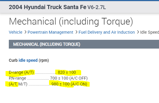

Also, I found the idle speed is too low. In gear, it should be between 720 and 920 (see pic below). The low idle could be caused by a couple of things such as a dirty throttle body, the idle air control valve, a vacuum leak, and so on.
