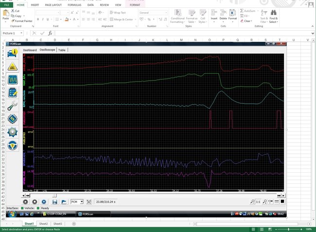

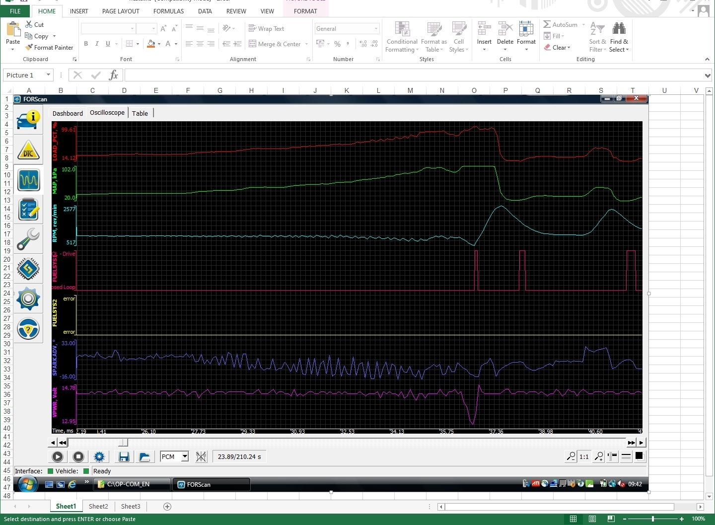

From cold and on tick over voltage drops from 14.3v, to 12.2v, after about 4 minutes. A few milliseconds later the rpm drops from 1100 to circa 500 (recorded on a diagnostic tool). This lasts a few seconds then voltage returns to 14.3, RPM surges and then stabilises around 1000. It may happen a couple of times whilst getting to temperature, but once at operating temperature is fine.
I have changed the coolant sensor, bank 1 oxygen sensor, throttle control body and the MAF sensor. I have also checked for vacuum leaks. There are no error codes.
