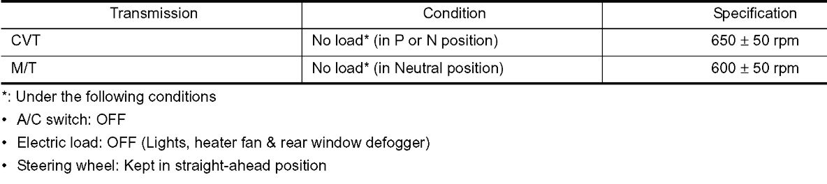

Engine idle is normal cold through most of warm up. After warn to normal max on temperature gauge, idle try's to drop to 500 rpm at stop in gear. Drives normal above idle. Also problem is gone driving in rain. Makes no sense. When rain stops idle drops to 500 rpm again. Why?
