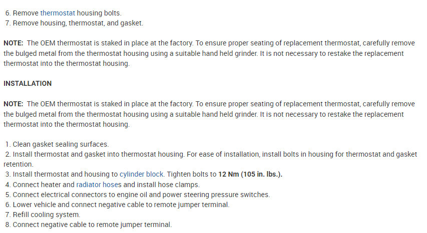

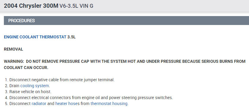

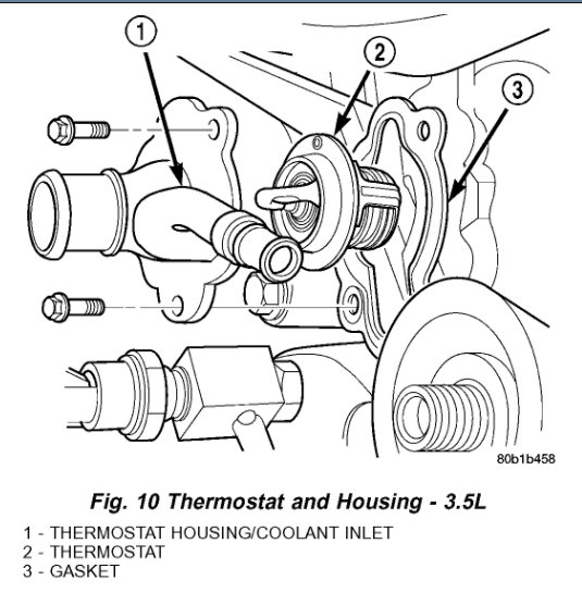

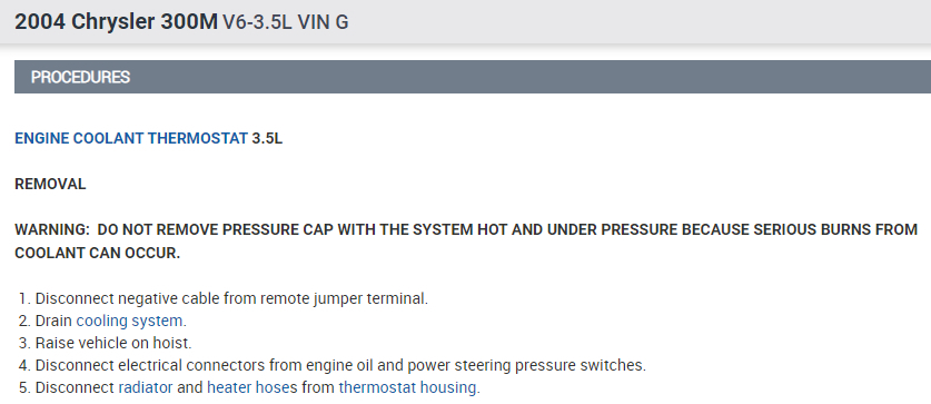

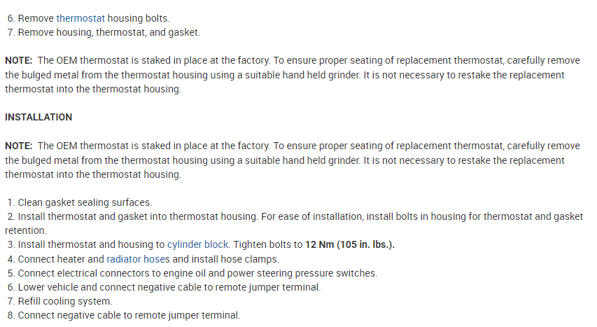

It's possible you might have a defective thermostat that might be causing this issue. Here is a tutorial on how to replace a thermostat:
I've attached picture steps below on how to replace the thermostat on your car. Hope this helps and thanks again for using 2CarPros.
