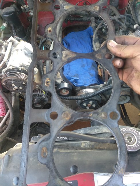

Thank you for the reply. I took the head off today and the head gasket had damage to it from both the cylinders that are low. I noticed one of the cylinder has a little gash around the rim. I know this is not good but is it bad?

Thank you for the reply. I took the head off today and the head gasket had damage to it from both the cylinders that are low. I noticed one of the cylinder has a little gash around the rim. I know this is not good but is it bad? The damage to the gasket does not line up with the gash on the cylinder.

From what I can tell, you might be over-thinking this. Exhaust gas is corrosive and can attack the head gasket. Once a path forms through the gasket, the flow of additional hot gas can burn the metal ring and push it out. There really is not any defect that led to that.
Do not panic if you find small cracks between the two valve seats in the head. Those are common and harmless. Proper surface finish is most important for good sealing of the new gasket. I do not like the Scotch pads on rotary air tools because they can gouge into aluminum heads too easily. You will have better luck with the discs with plastic fingers. It is also a good idea to take the head to an engine machine shop to have it checked for flatness. They will use a precision straight-edge to measure the warpage. You can have up to .005" warpage on a cast iron head, and .002" on an aluminum head.

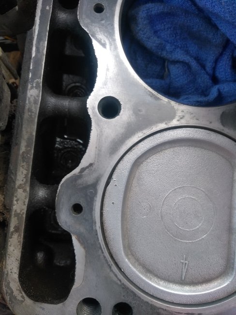

Awesome! I was nervous opening this message. I was told that the piston was bad by a co-worker and I wanted another opinion and I was anxious to know if that little gash was a big deal. I was hoping it was not. Thanks for the information, it is greatly appreciated! Update: I went back to read my previous messages, I meant to say there is a little gash on the rim of the piston. I attached a picture, I could not circle the spot but if you look a closely around the piston and the combustion chamber, there is a little gash. Hope it is still not a issue, as long as the head and block have a good seal. Fingers crossed.

If this helps, I use Microsoft Word a lot for my pictures. It is a typing program but I use it for the shapes and drawing objects that can be added, including arrows. Copy and paste the picture to a new document. Go up to "view", drop down to "tool bars", then check "drawing". That will put the drawing objects menu on the screen. Click on the circle, then click on your picture where you want it to go. You can drag it around and resize it. If the circle covers what you want me to see, go back to that tool bar with the circle highlighted, and there is a place to select the circle "fill" color. Select "no fill".
You can add arrows the same way, and there are places to make them bigger and change the color.
When you have everything added that you want, click the picture, then hold the "shift" key down and click the arrow and then the circle. You will keep adding things as long as the "shift" key is held down. Once everything is selected, you can release the "shift" key. Click "draw" on the left of the drawing tool bar, then at the top, click, "group". That turns all the items into a single picture. Copy that into MS Paint, then save it as a j-peg file. That file can be uploaded here.
