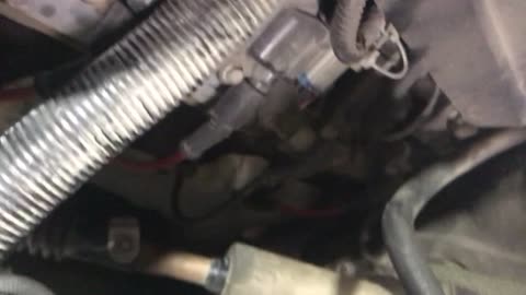

I did some research and discovered a common problem the 2007.5-2008 series had with lifters and also the bolts on the VLOM not being fastened correctly. I thought this was the problem but now I’m unsure as the noise changed from a tick to a scratching sound. Attached is a video with audio so you can also hear the sound.
I am able to reach the front 2 bolts on the VLOM and they were not even finger tight. After that I ran a compression test, the results were not good:
