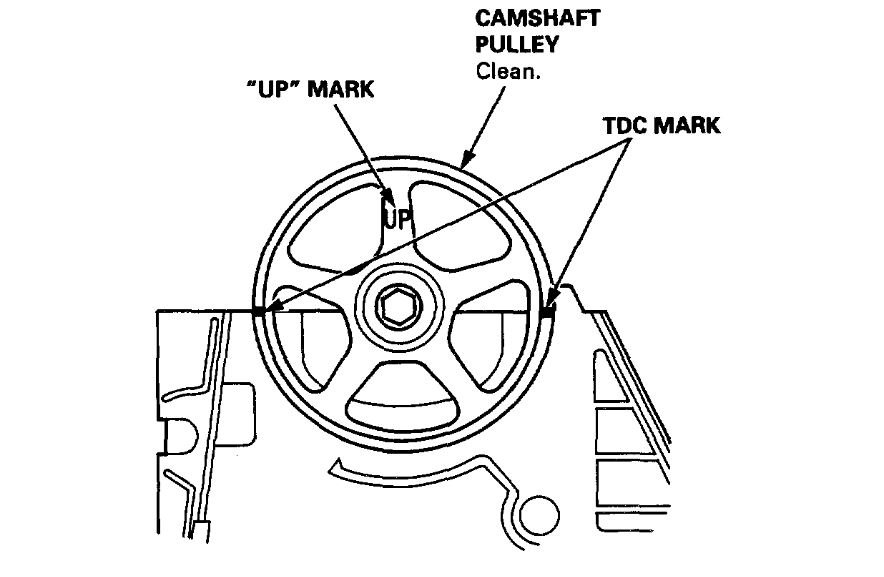

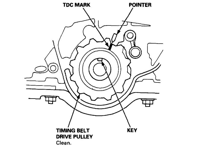

Cranks but not start. has good spark and fuel delivery. compression test showed low: 50 -75 - 50 -75. that's on cylinder 1,2,3 and 4. what could have caused that? can a timing issue can caused that compression? odd to me why 1 and 3 has same compression and 2 and 4 has same. thanks

Low compression like this is usually the result of a failed timing belt.
https://www.2carpros.com/articles/how-a-timing-belt-works
remove the top cover and check the timing marks with the engine at top dead center.
I attached a picture of how the marks should line up.
