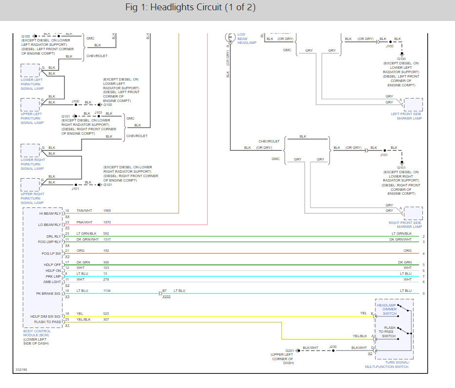

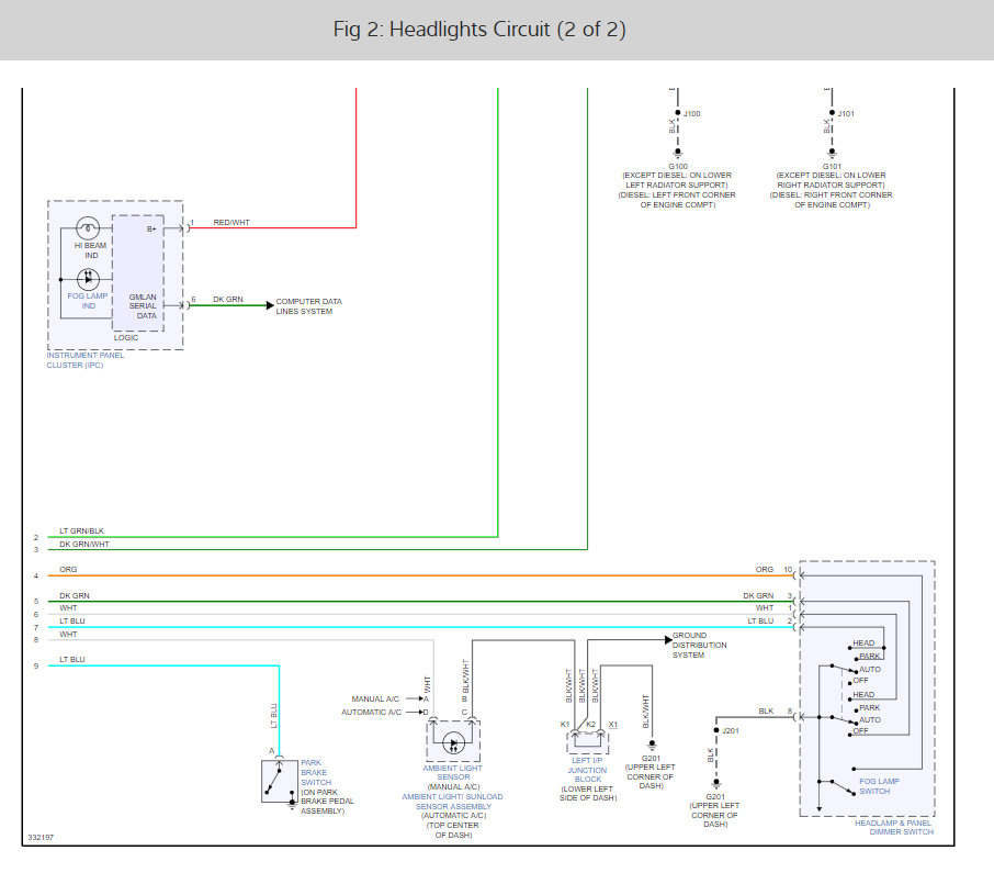

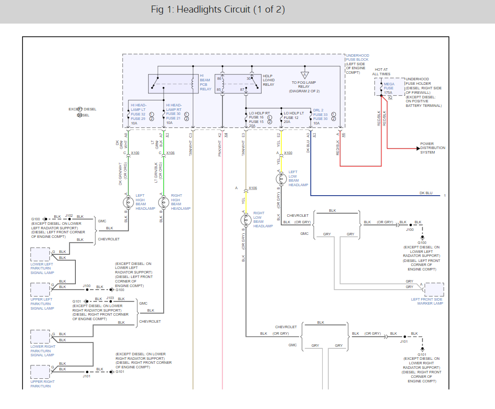

On my way home I noticed that people kept pulling over in front of me. I noticed my low beams coming off and then on as it got darker. The low beams turn off and on without warning. But the high beams work fine and have no issues. So I have found that the low beams will work with the engine off, and the ignition on or off. But as soon as you start the engine the low beams will flicker on and off or just stay off.
