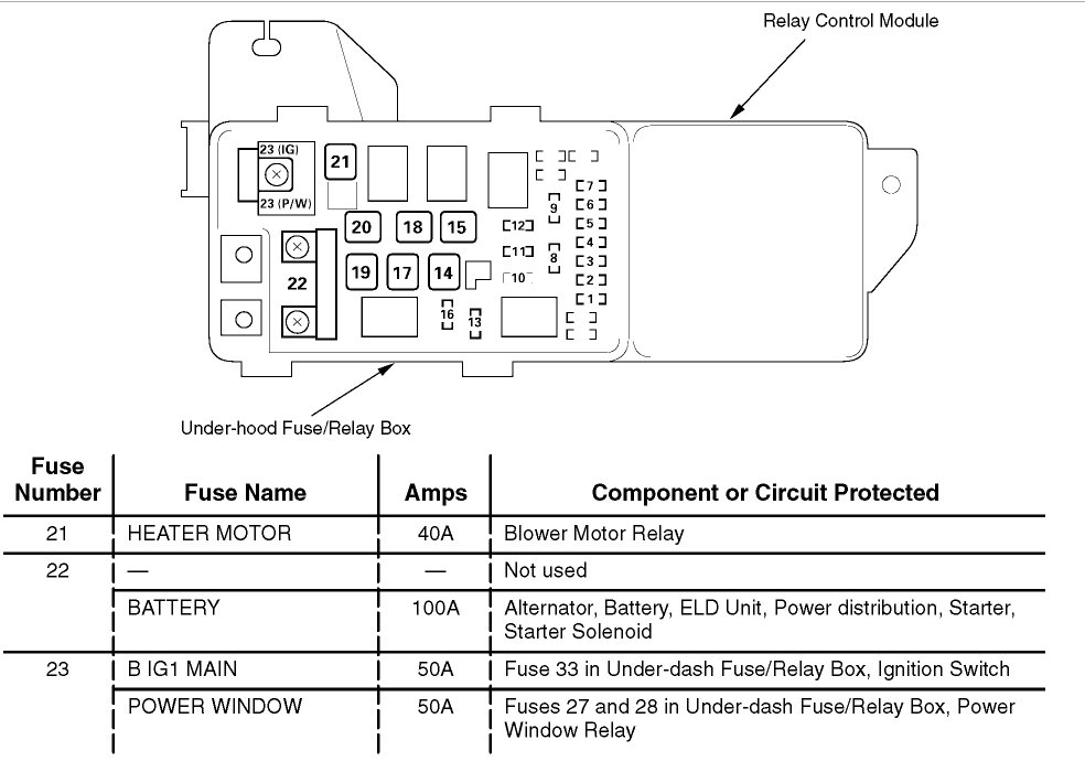

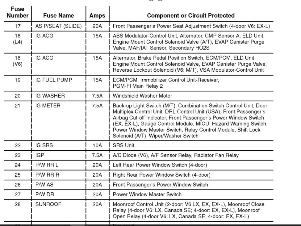

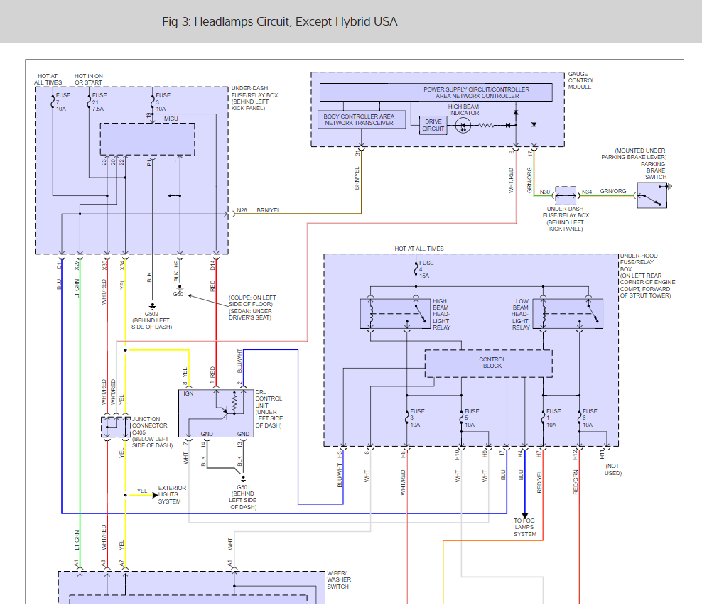

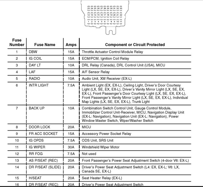

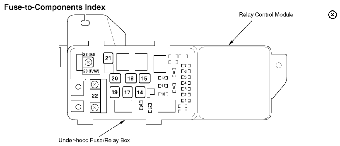

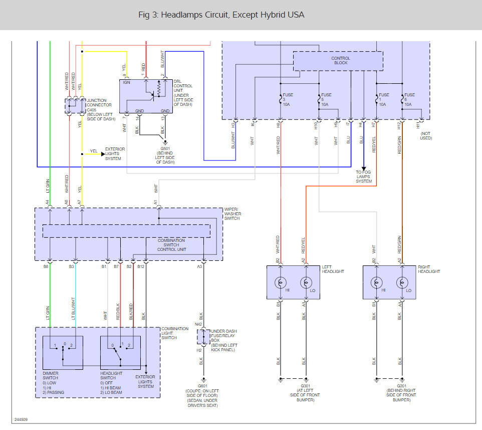

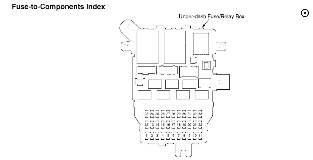

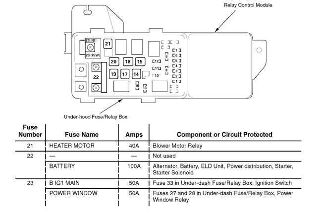

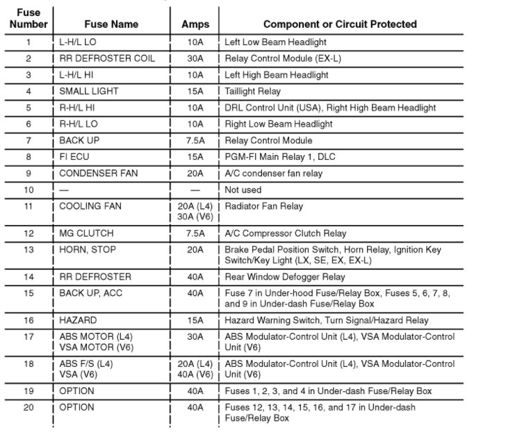

There is a headlight relay that sound like it went out. Here are some diagrams and diagrams so you can find and test the relay. I would try to swap it with another relay that is close by to see if you can get it to work. Check the fuses too.
and
and
Test for where we are losing power (below)

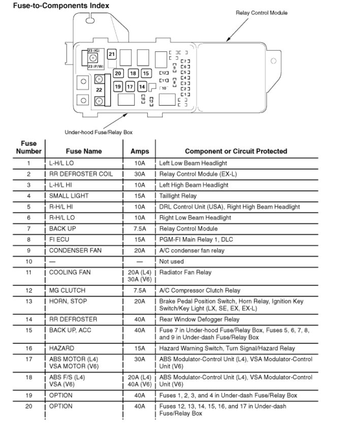

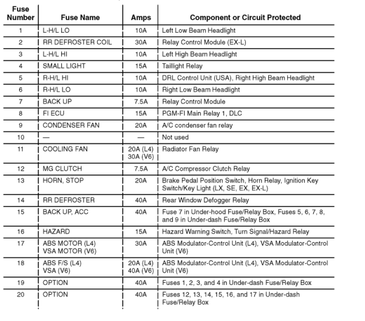

the Drivers side low beam won't work. I've replace the bulb and checked the fuse but still won't work. I measured the voltage at the fuse with lights on and read 0VDC. At the passenger side fuse I read 12.8VDC. Any help would be appreciated.

Hi djnacory, If you do not have voltage at fuse # 1 ( 10 A ) in underhood fuse box with low beam turned on, there is an open circuit within the relay. The headlight low beam relay supplies power to both fuses for left and right low beams and if only 1 is not working, it can only be due to an open circuit.
https://www.2carpros.com/forum/automotive_pictures/192750_HeadlightCircuit07AccordFig85a_1.jpg

I installed a new fuse and it working must have been a bad connection thank you.

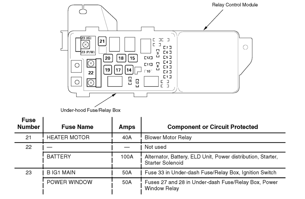

There is a low beam relay that needs to be checked here is a guide to help with the relay location in the diagrams below.
Check out the diagrams (Below). Please let us know what happens.

low beam passenger side 2004 honda accord not working.Power to #6 fuse but not to bulb connector.Fuse good,Bulb good.What & where to look next.Thanks Ronnie

Power supply is direct from Fuse # 6 to the headlight. Ensure fuse is good with a test lamp or try swapping with Fuse # 1.
If power is available, then there is a break in the wiring between fuse and bulb. Check the connection behind the fusebox for looseness or contaminations causing poor contacts.
