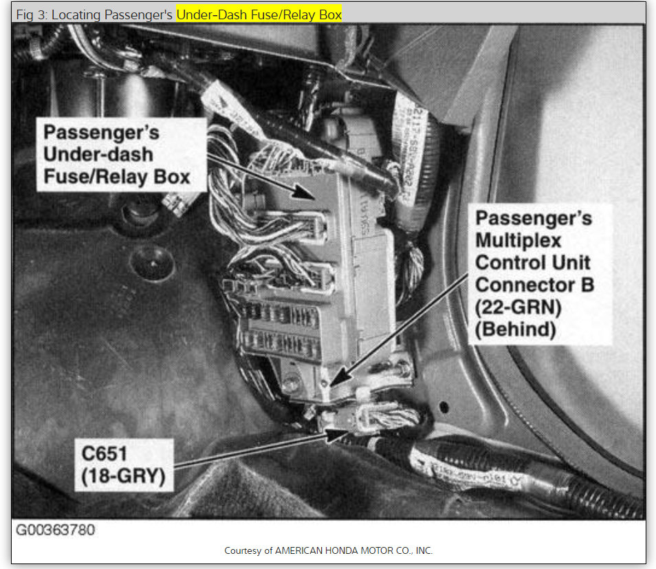

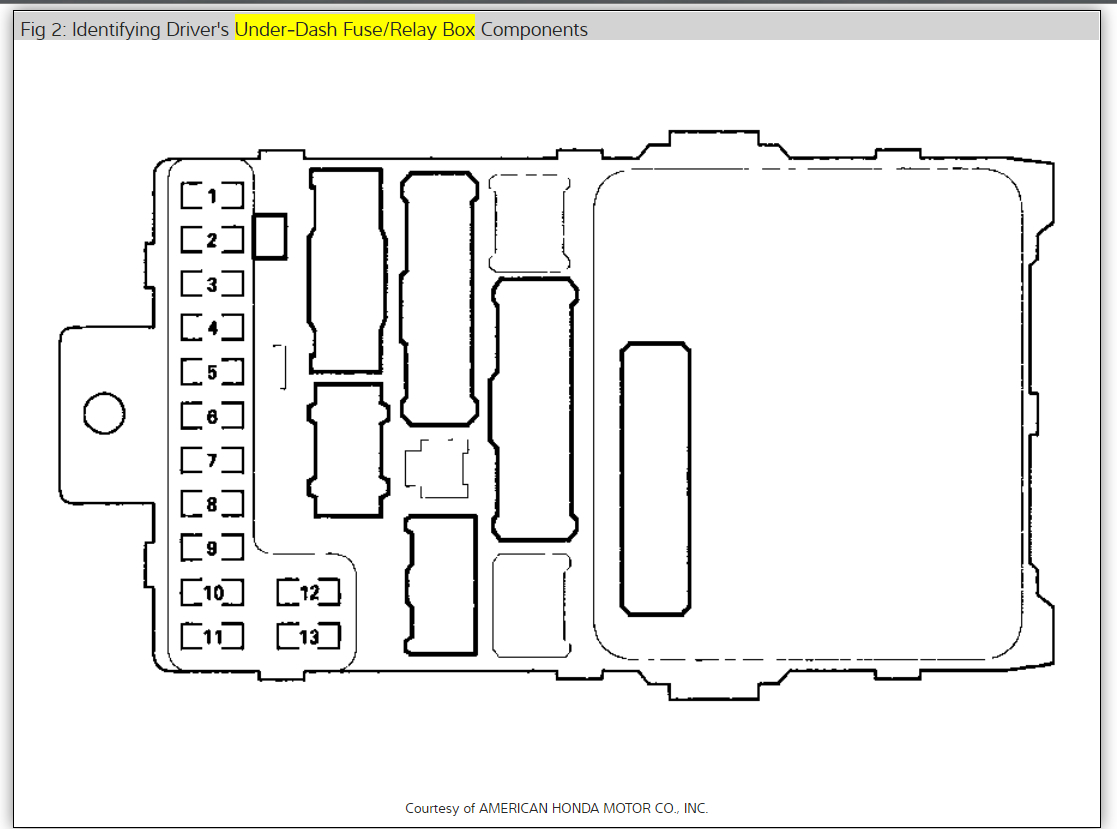

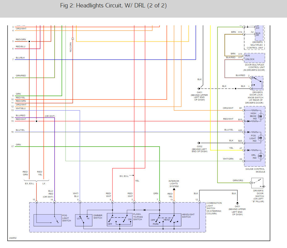

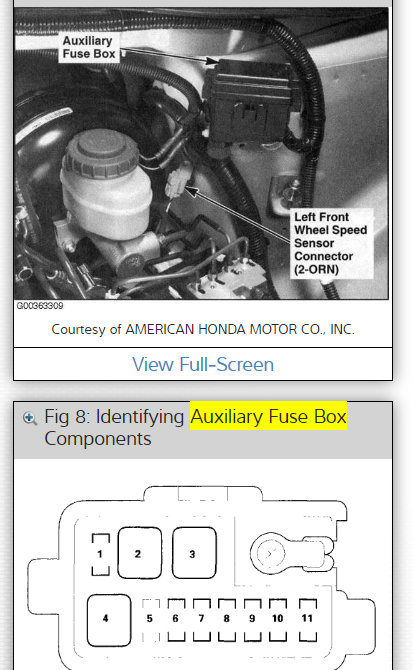

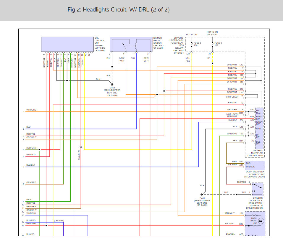

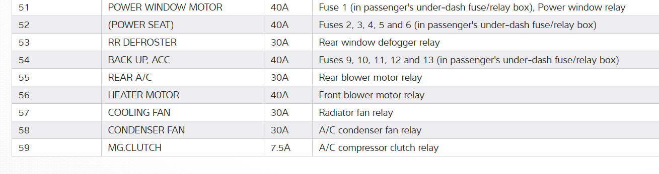

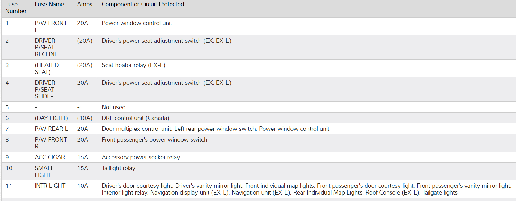

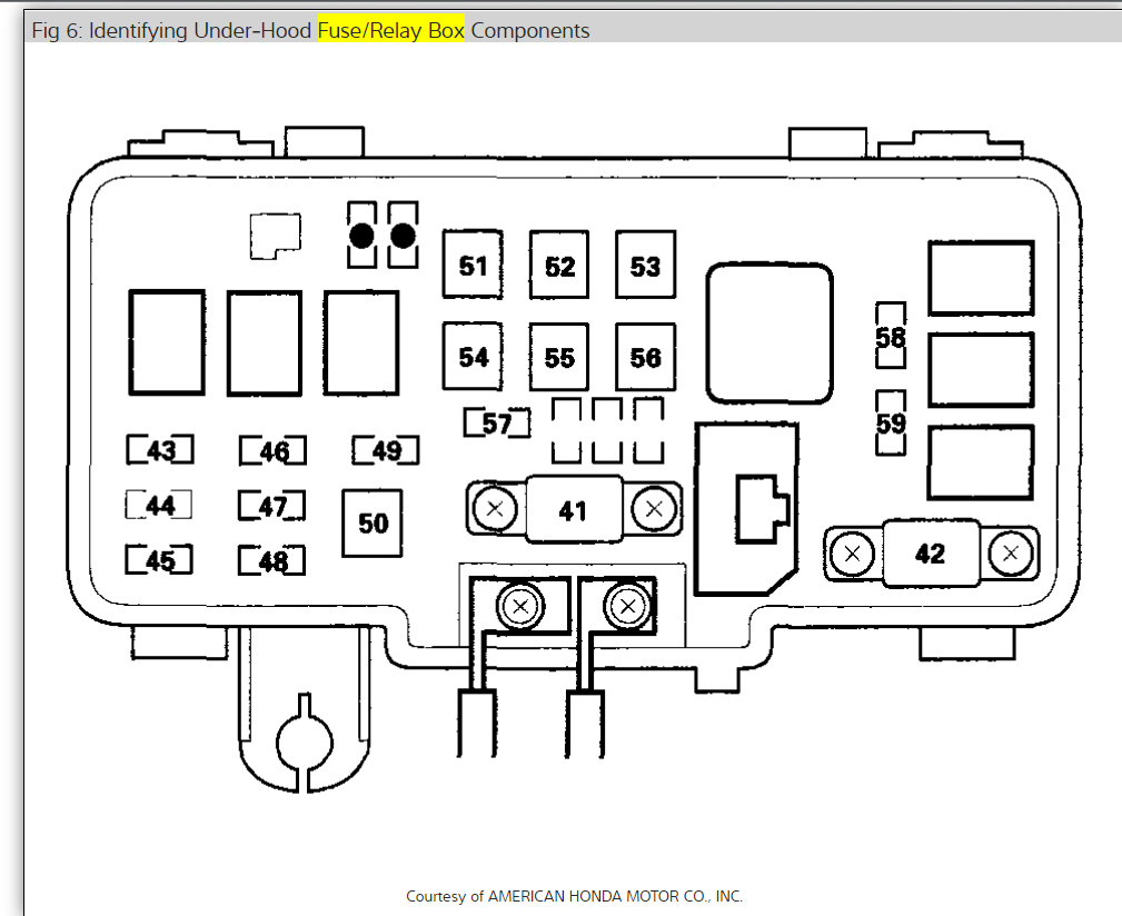

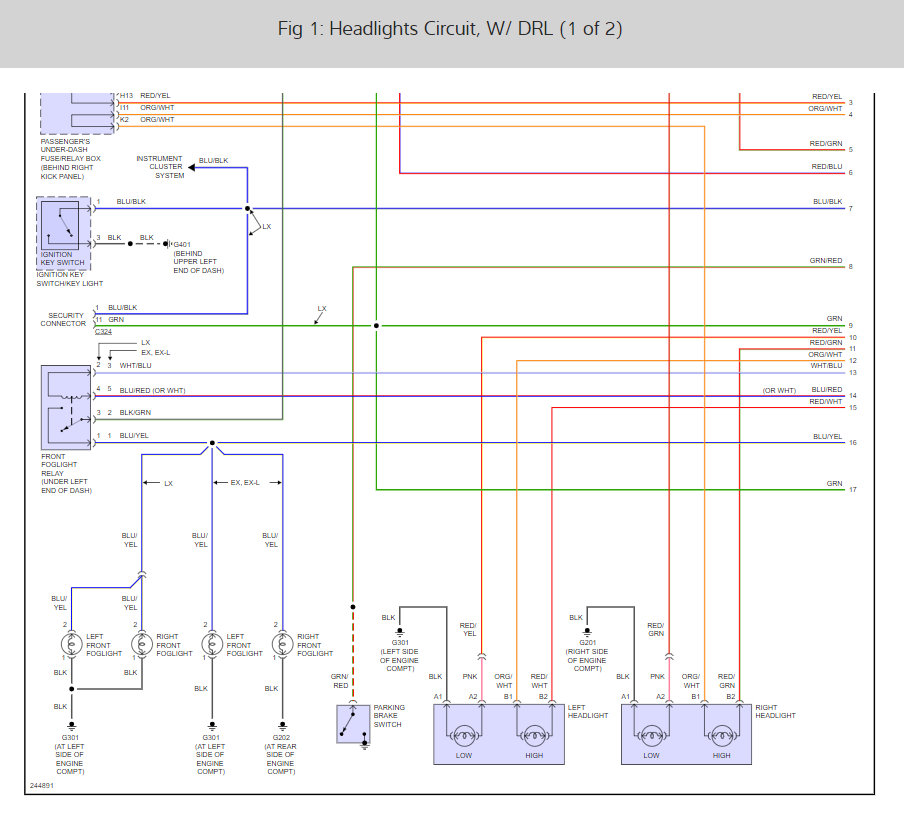

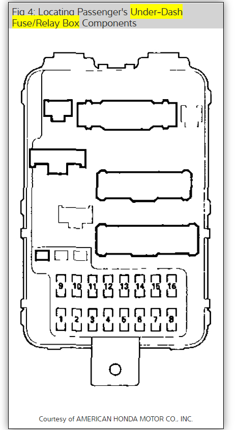

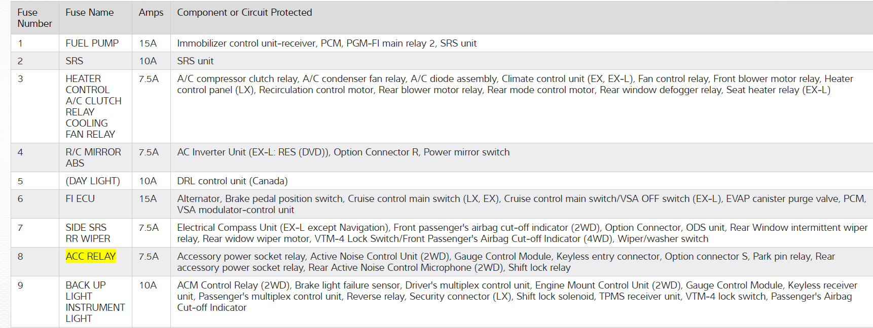

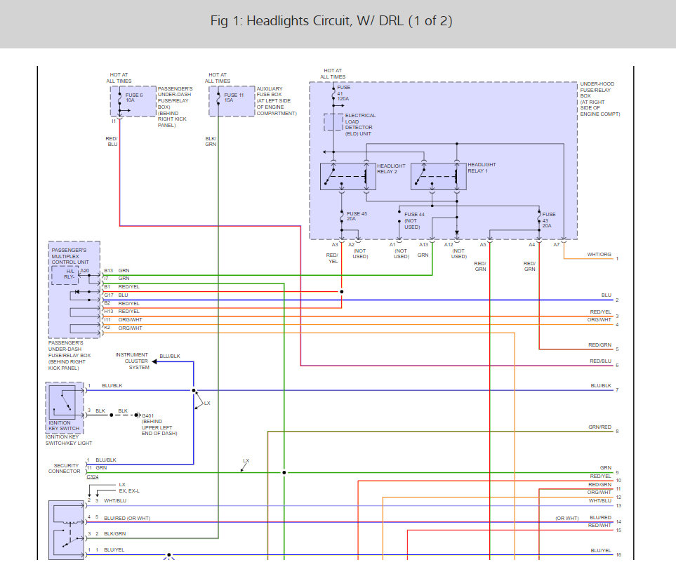

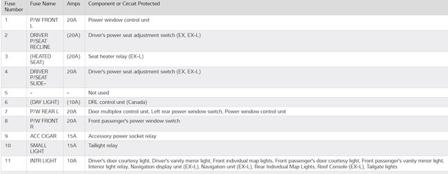

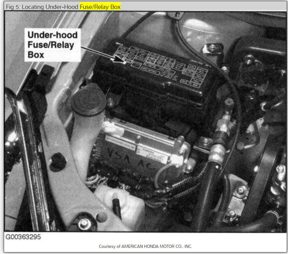

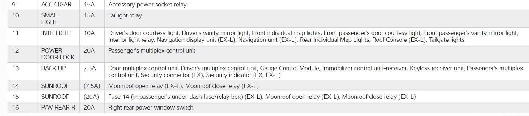

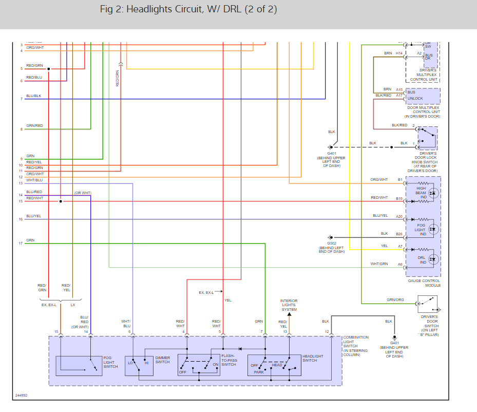

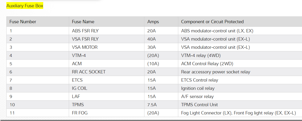

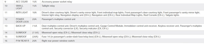

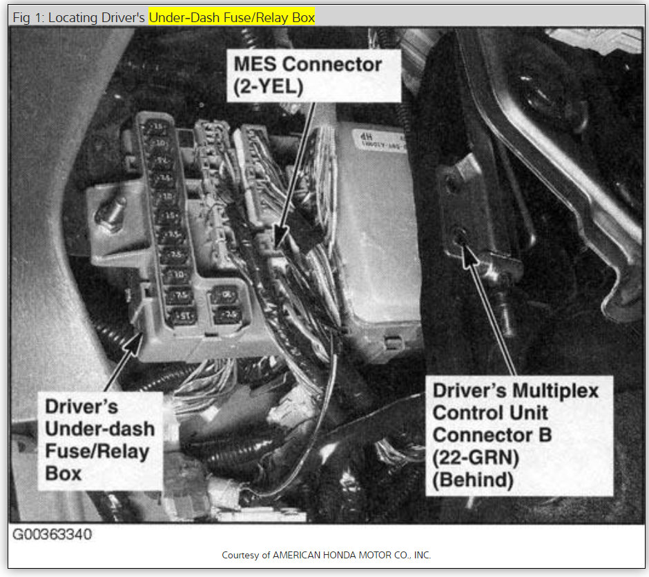

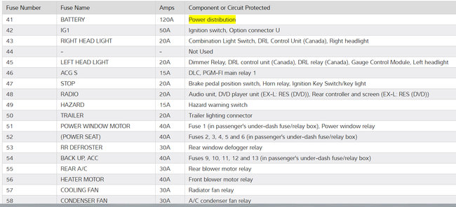

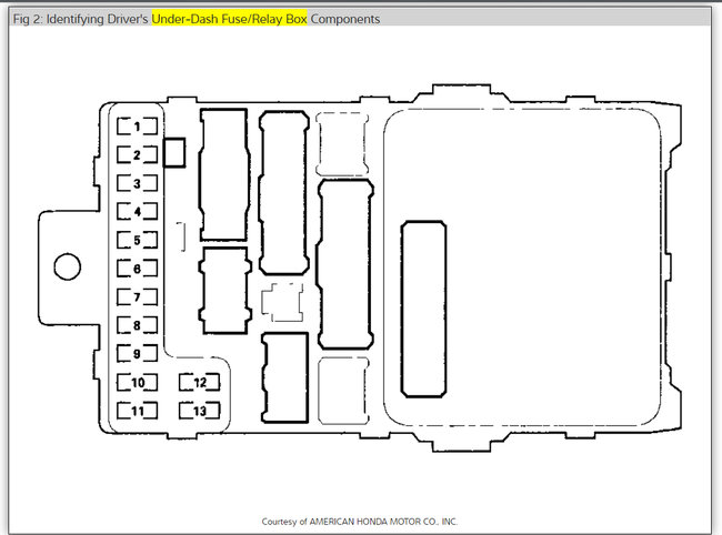

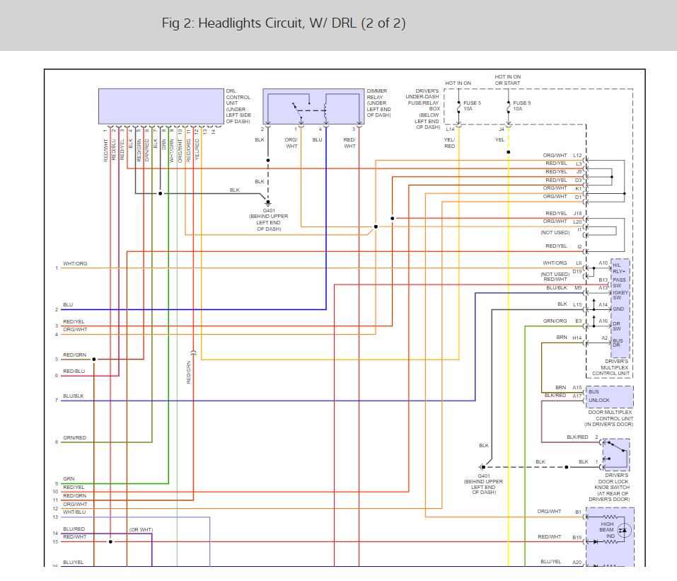

There are three fuse # 44, 43 and 45 that need to be checked with two headlight relays as well. Here are two guides to help get us started on fixing the problem and the headlight wiring diagrams and fuse and relay locations in the diagrams below:
and
Check out the diagrams (below). Please let us know what you find. We are interested to see what it is. There are two different fuse panels so see which one you have.
