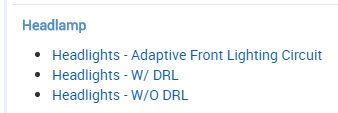

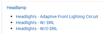

I would start by looking to see if you have a loose/burnt/corroded/defective ground wire for that bulb socket. I can send you a wiring diagram but need to know a little more about your car.Does it have conventional or Xenon headlamps? I've attached a picture below for further options on your car I need to know.Get back to me when you can and thanks for using 2CarPros.
