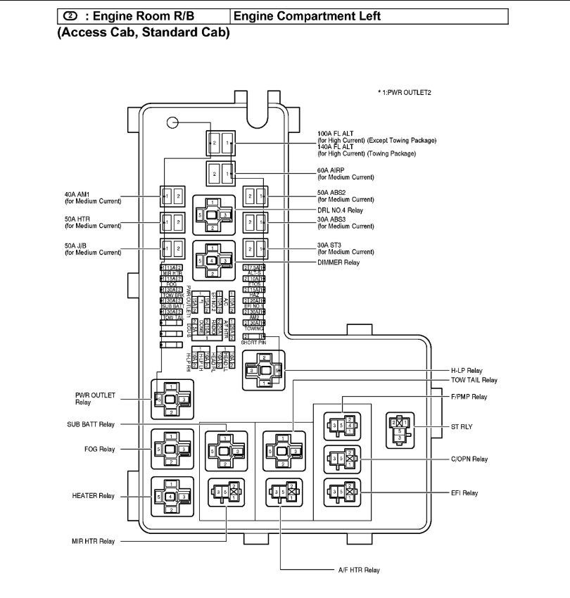

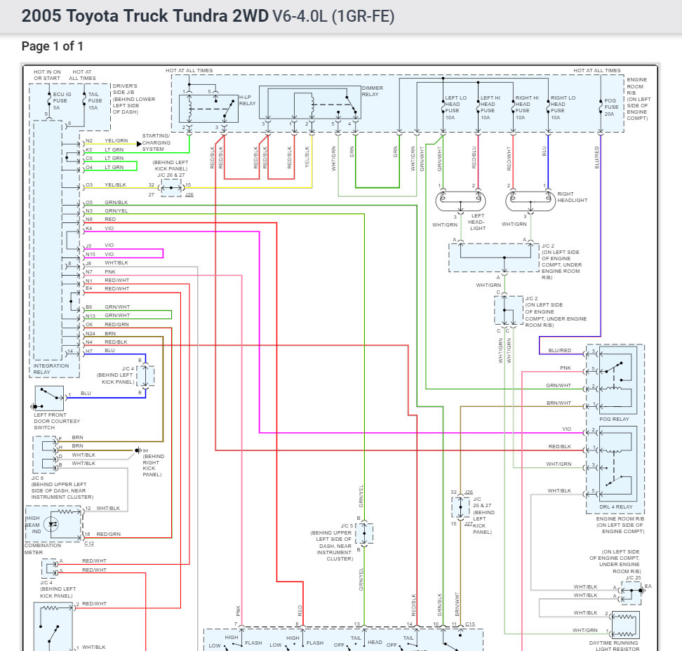

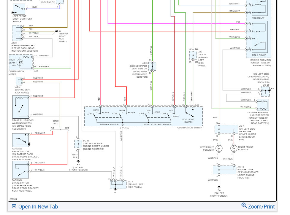

There is a HLP relay that needs to be checked. here is a guide to help test the relay and the headlight wiring diagrams so you can see how the system works and the relay location as well:
