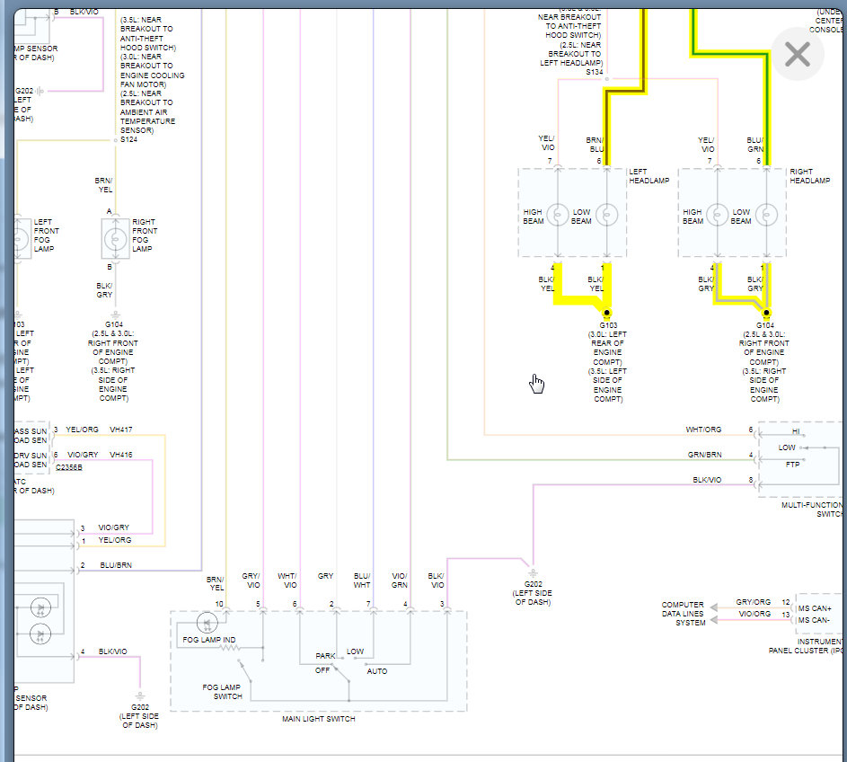

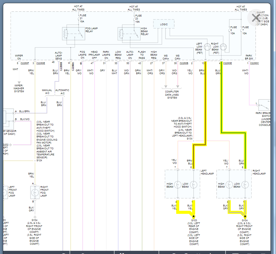

Here is a guide that will help with this issue:
https://www.2carpros.com/articles/one-headlight-is-dim-or-dull
I would suggest checking the voltage on the highlighted wires just to find out if you have 12 volts going to the low beam bulbs.
Normally this is a ground issue but the high beams share the ground so it is unlikely. More likely is a the FET that is used in the Smart Junction block.
Please run through this material and let us know what questions you have. Thanks
