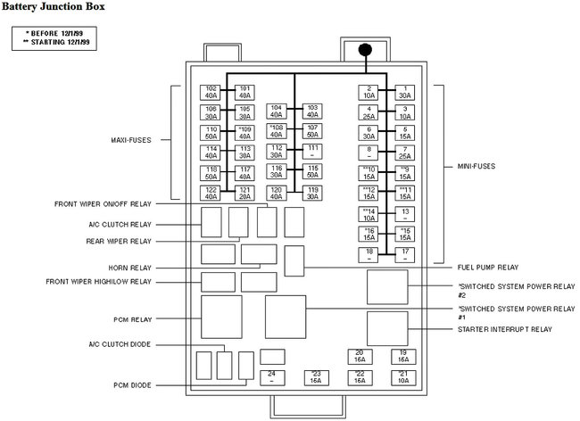

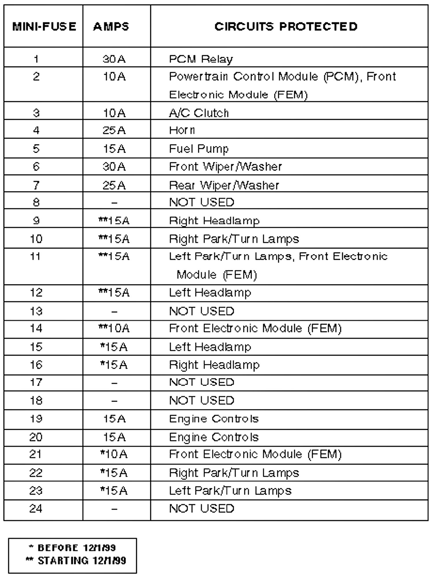

First, did you check both fuses in the under hood fuse/relay box? One is for the left and the other the right. See the attached pictures.

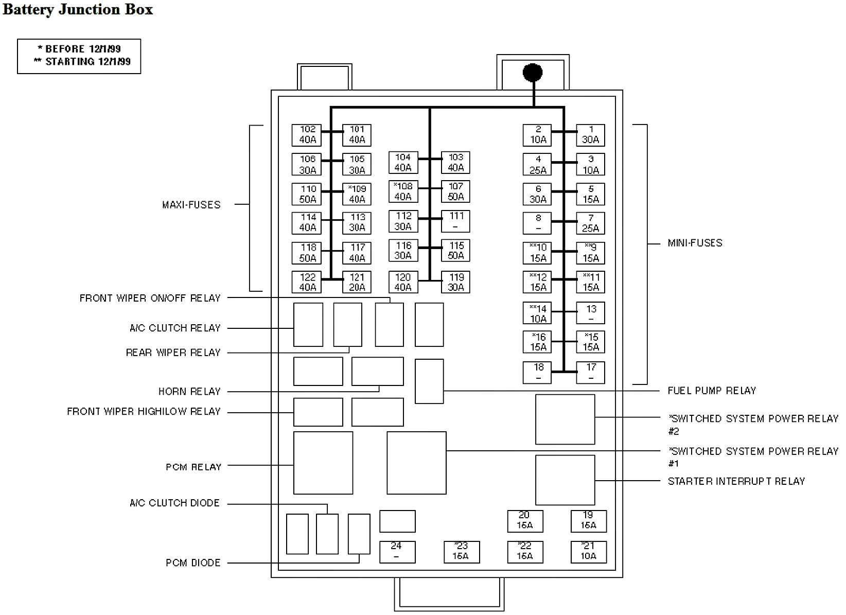

If there is power, suspect a bad socket. If there is no power, I then what you to switch switched power relay 1 with a different relay in the box that has the same part number. See picture 3 for relay location.
Do this and let me know what you find.
