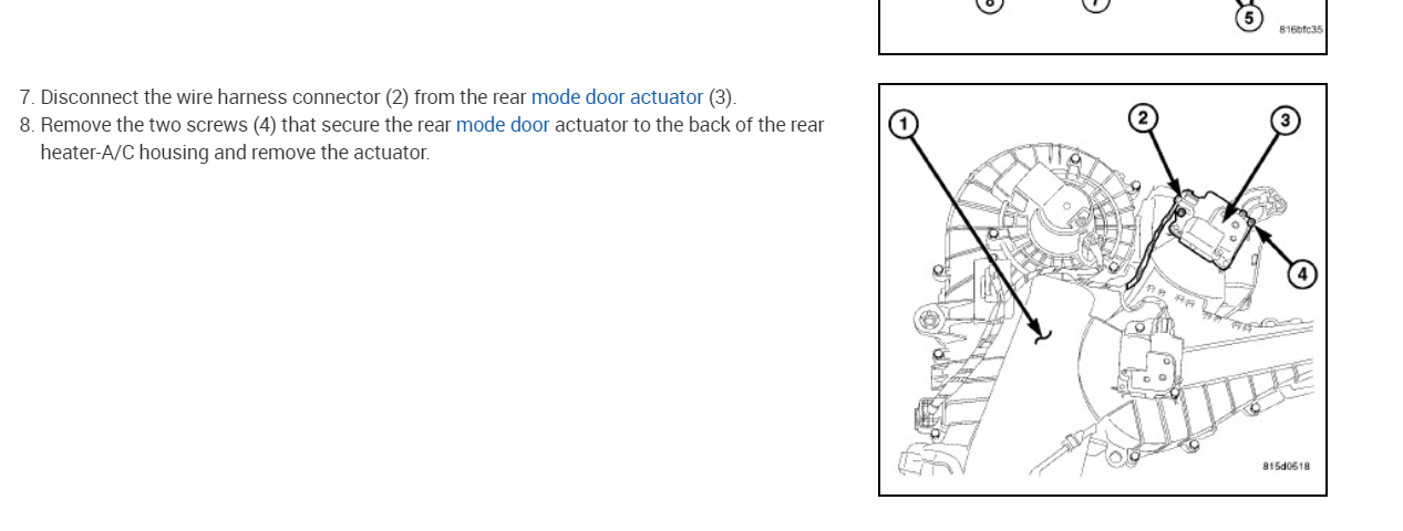

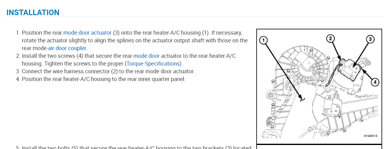

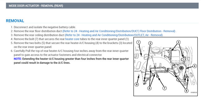

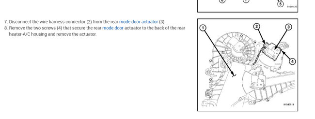

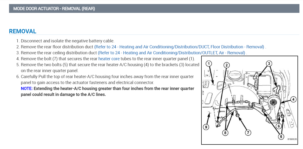

It sounds like you have a mode actuator in the rear A/C that is not working, please remove the plastic covering to expose the rear HVAC unit. Once this is done work the controls should be able to feel the actuators working. here is the location of the mode actuator so you can check it out and if it does feel like it is working replace it. Check out the images (below). Please let us know what you find.

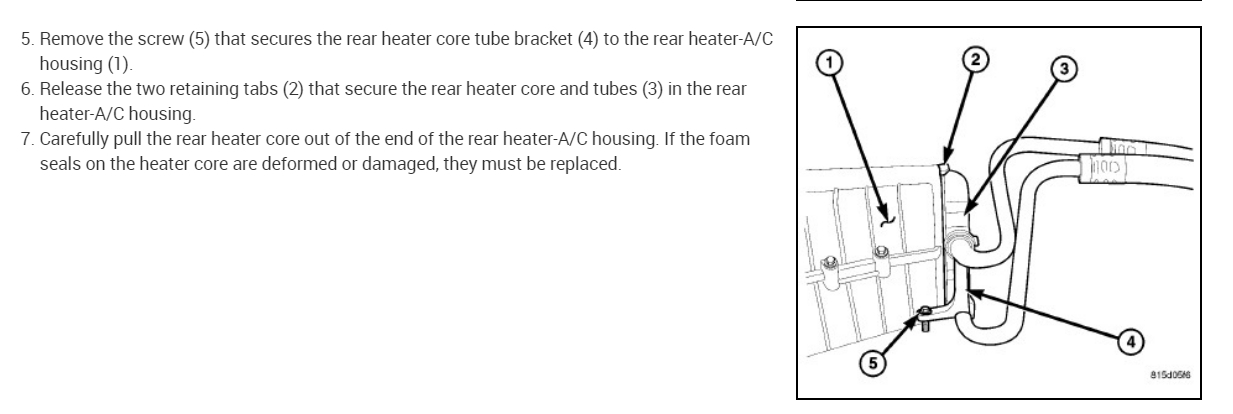

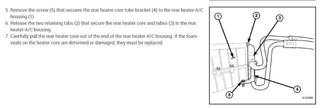

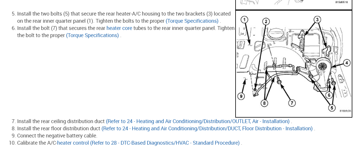

Please check the heater hoses running to the rear heat core to see if they are hot, if not it sounds like the rear heater core is clogged. Here is information on the rear heater hoses. Also check the coolant level when the engine is cold. Check out the images (below). Please let us know what happens.
