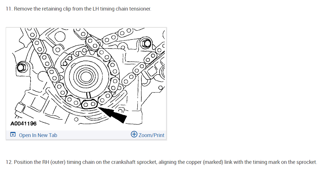

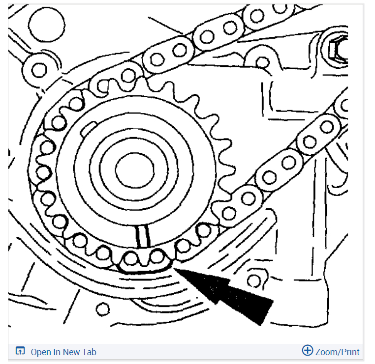

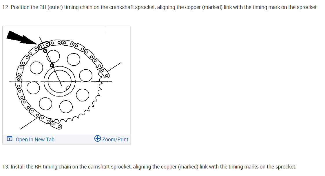

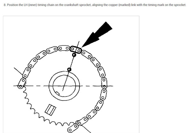

No they will not, once the chains are on and you turn the engine over the dots will not line back up. Here are the timing chain marks to help you but I think the valve procedure is the same so I would watch the video to see what I am talking about. If you don't follow the instructions, you can bend the valves. Even though there are no cam phasers the instructions are the same FYI. Check out the images (below). Please let us know what happens.
