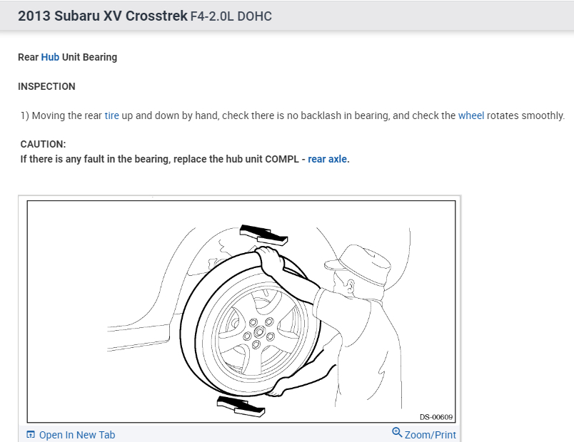

After hearing the noise from the rear from the rear passenger tire, I pulled over thinking it was flat. However, it seemed till I pushed on the tire. It has some play in it almost as if the lug nuts are not fully tightened down yet they don't budge when I try to tighten them. Is this a tie rod or ball joint issue?
Jan 9, 2023 at 1:05 PM

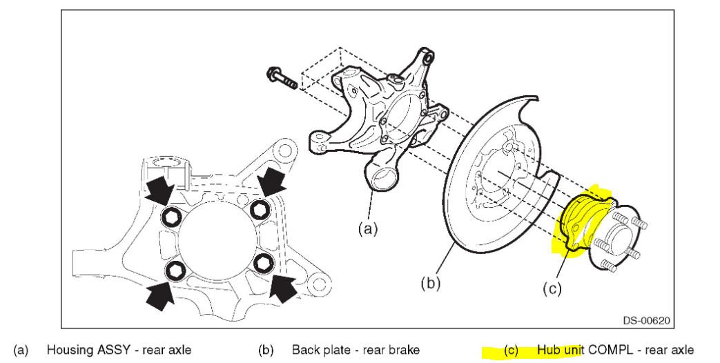

It sounds like the rear hub bearing has failed. This needs attention before driving.
If you look below (pic 1) it explains how to check the bearing. In picture 2, I highlighted the bearing I'm referring to.

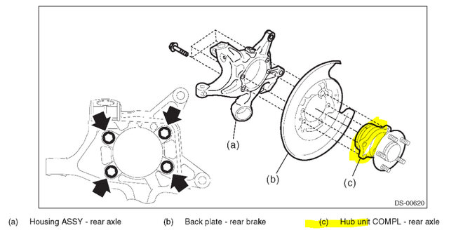

See pics below.
