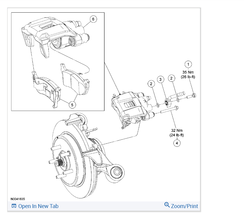

So, this can happen when grease has contaminated the brake pads, which sometimes happens when the repair job is done. Also, I would check the rear wheel tire lugs. Here is a guide to help. You can remove the tire as well to check to make sure the brake caliper is secure.
https://www.2carpros.com/articles/wheel-removal-and-re-installation
Can you please shoot a quick video with your phone so I can hear the noise? That way I can tell for sure what's going on. You can upload it here with your response. Check out the images (below). Please let us know what you find. We are interested to see what it is.
