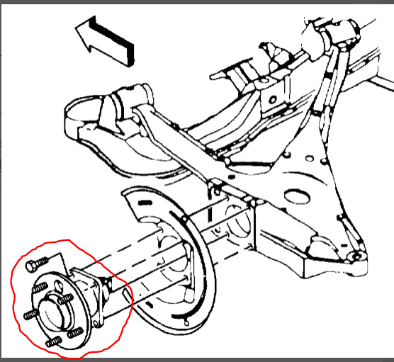

Have you inspected the wheel hub assembly on that side? First thing i would do is jack the wheel off the ground still tightened and attached.Grab the wheel by both hands on each side and wiggle to see if there is any play.Do this from side to side and top to bottom. I've attached a picture below of what the wheel hub assembly looks like and location and circled in red.Let me know what you find out.Hope this helps and thanks for using 2CarPros.
Jul 4, 2020 at 9:59 PM
INTOSILENCE1
  • 79 POSTS
Well, there is no play whatsoever from side to side, but up and down there is a tiny, almost imperceptible movement, but there is no grinding sound when I spin the wheel, which is another symptom of bad bearings. I also checked the rear driver side bearing, and it was very similar, no side to side play at all, but just a tiny bit of up and down, although it seemed to be even less than the rear passenger side. Also no grinding sound when spinning the wheel.

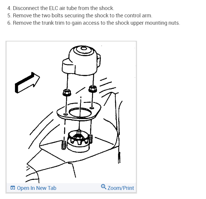

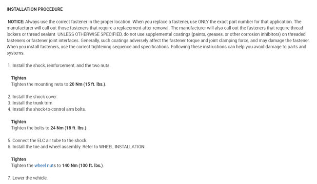

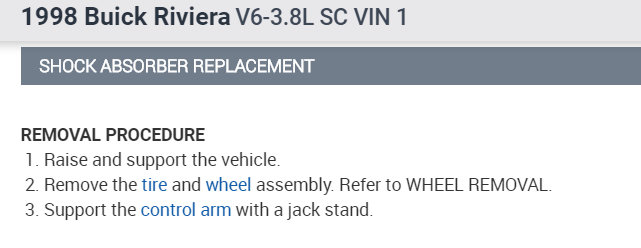

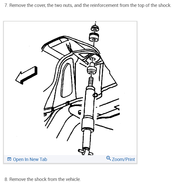

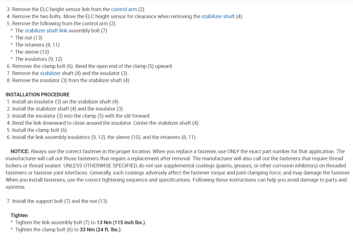

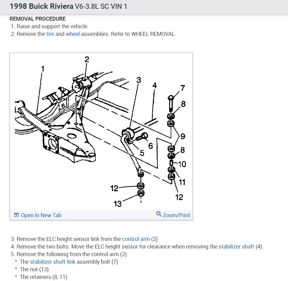

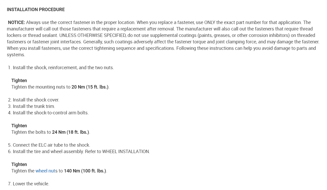

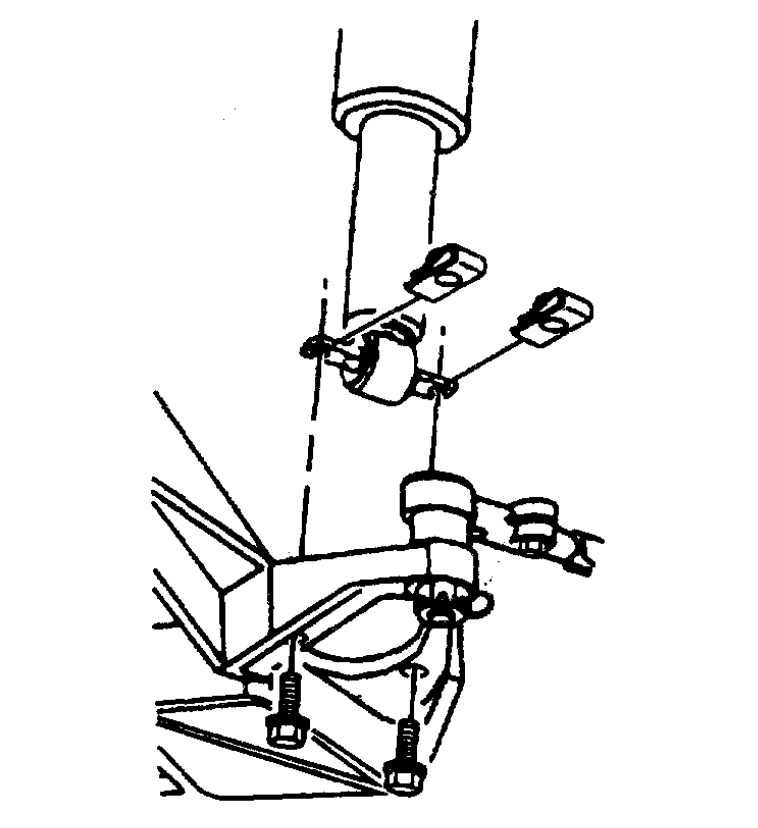

Thanks for the video. It sounds like rear shock or sway bar link is worn causing the noise. Here is how you can replace the rear strut. Inspect the sway bar first to see any obvious problems if okay replace the strut. Check out the diagrams (below). Please let us know what you find.
