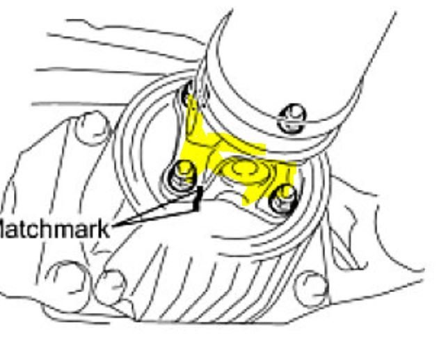

Normally, a clunk and vibration is related to a bad universal joint. That is the component that attaches the driveshaft to the transmission on one end and the differential on the other. Also, this vehicle does have rear CV axles which can do the same thing.
Picture 1 below shows the drive shaft universal joint near the rear differential. Here is a link that explains how one works:
https://www.2carpros.com/articles/how-u-joints-work
Now when they go bad, there is excessive play in needle bearings which allows for a clanking, vibration, squeaking and so on.
To check it, place the vehicle on a flat surface and place the parking brake on fully and block the wheels so the car can not move. Place the transmission in neutral so that there is no tension on the driveshaft and joint. Then, you need to grab on to the driveshaft near the joint and see if there is excessive play. I would feel better if you had a helper hold his foot on the brake while you did this.
