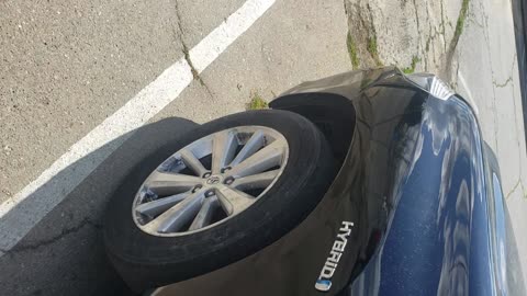

Makes loud noise from front was giving misfire for coils that's not problem. code shops don't know what's really wrong.

MOH209
Yes, here is video let me know.
Mar 26, 2020 at 11:09 PM
MOH209
Makes noise when start and drives. makes noise loud noise. no heat up no leaks.

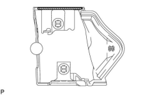

(a)Remove the clip.
pic 1

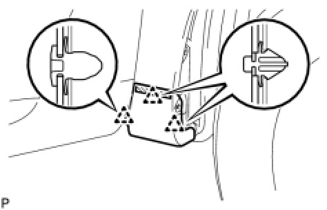

(c)Peel off the front fender side protector and disengage the 3 clips, and then remove the front fender moulding sub-assembly RH.
pic 2

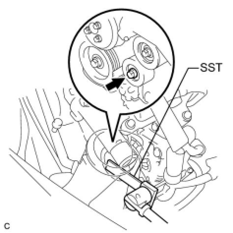

(f)Remove the front fender side protector from the front fender moulding sub-assembly RH.
pic 3

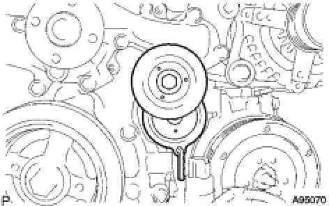

(a)Using SST, release the V-ribbed belt tension by turning the V-ribbed belt tensioner assembly counterclockwise, and remove the V-ribbed belt from the V-ribbed belt tensioner assembly.
pic 4

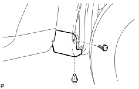

(b)While turning the V-ribbed belt tensioner assembly counterclockwise, align with its holes, and then insert the 5 mm bi-hexagon wrench into the holes to fix the V-ribbed belt tensioner assembly.
pic 5

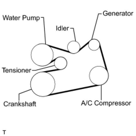

(a)Install the V-ribbed belt.
pic 6
