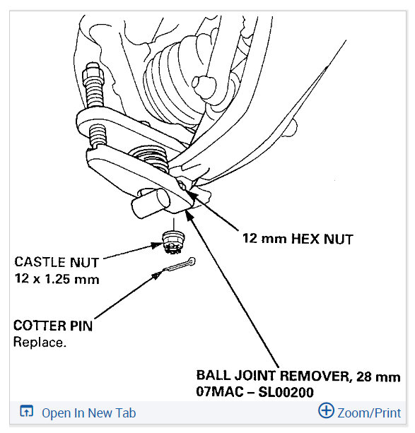

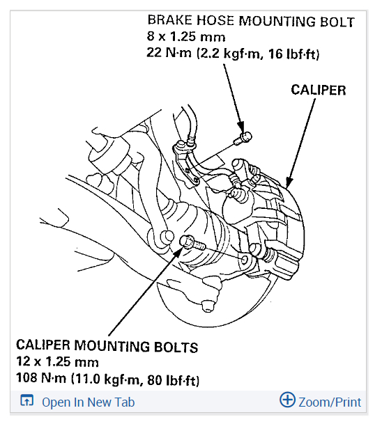

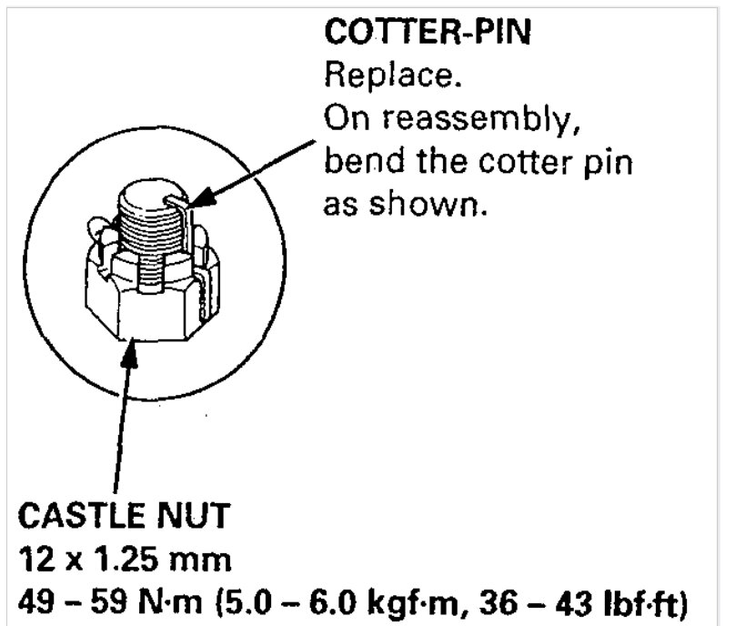

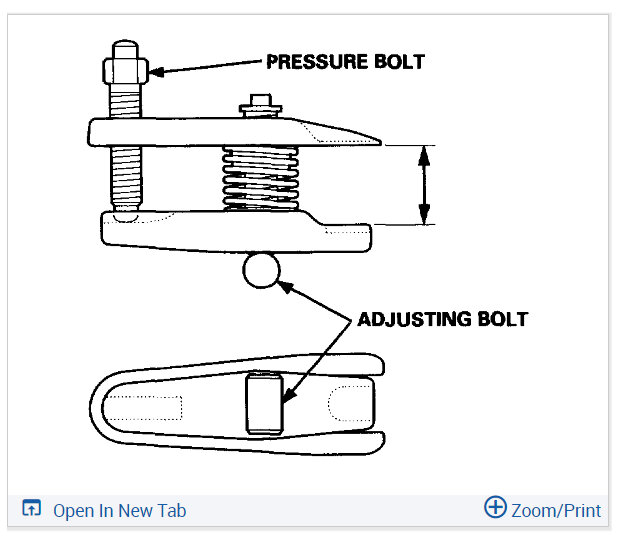

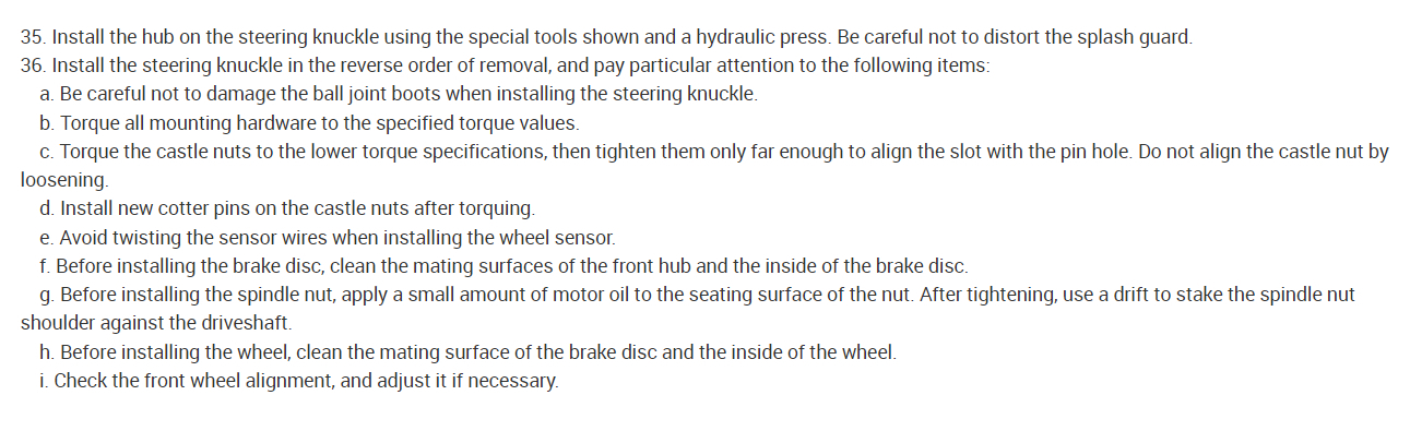

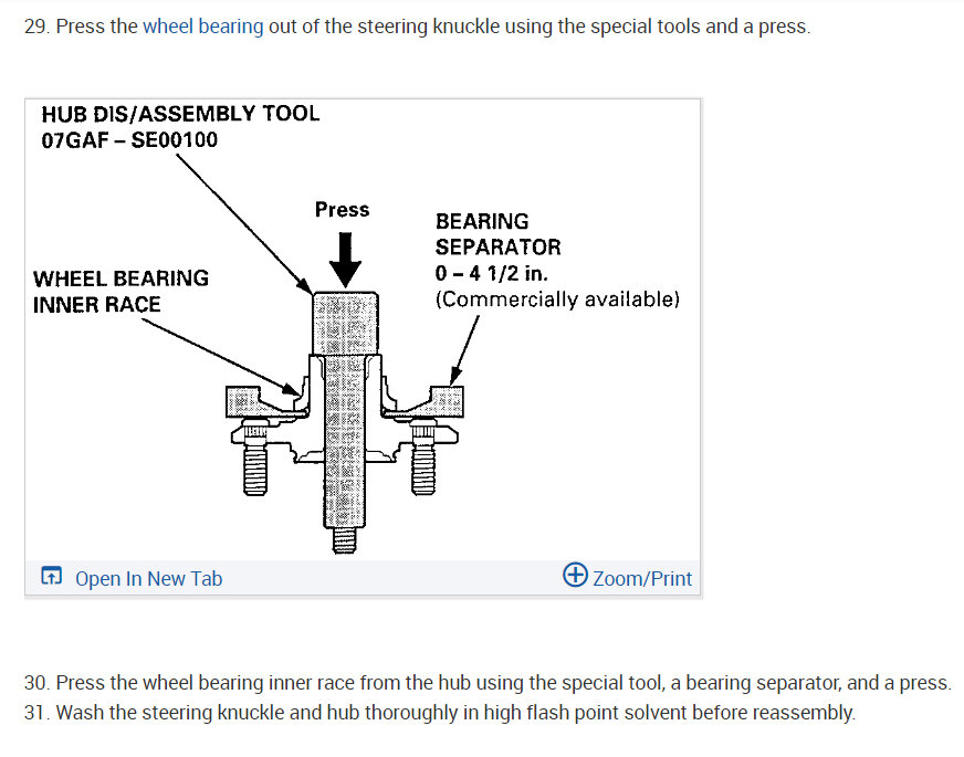

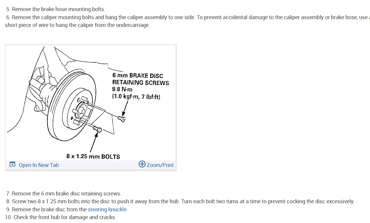

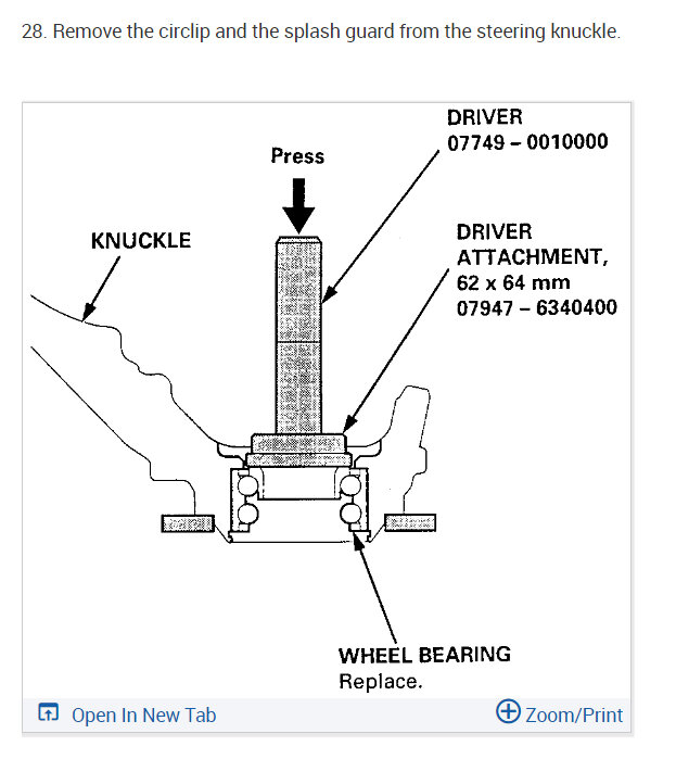

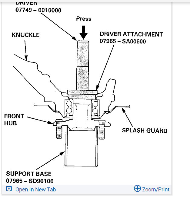

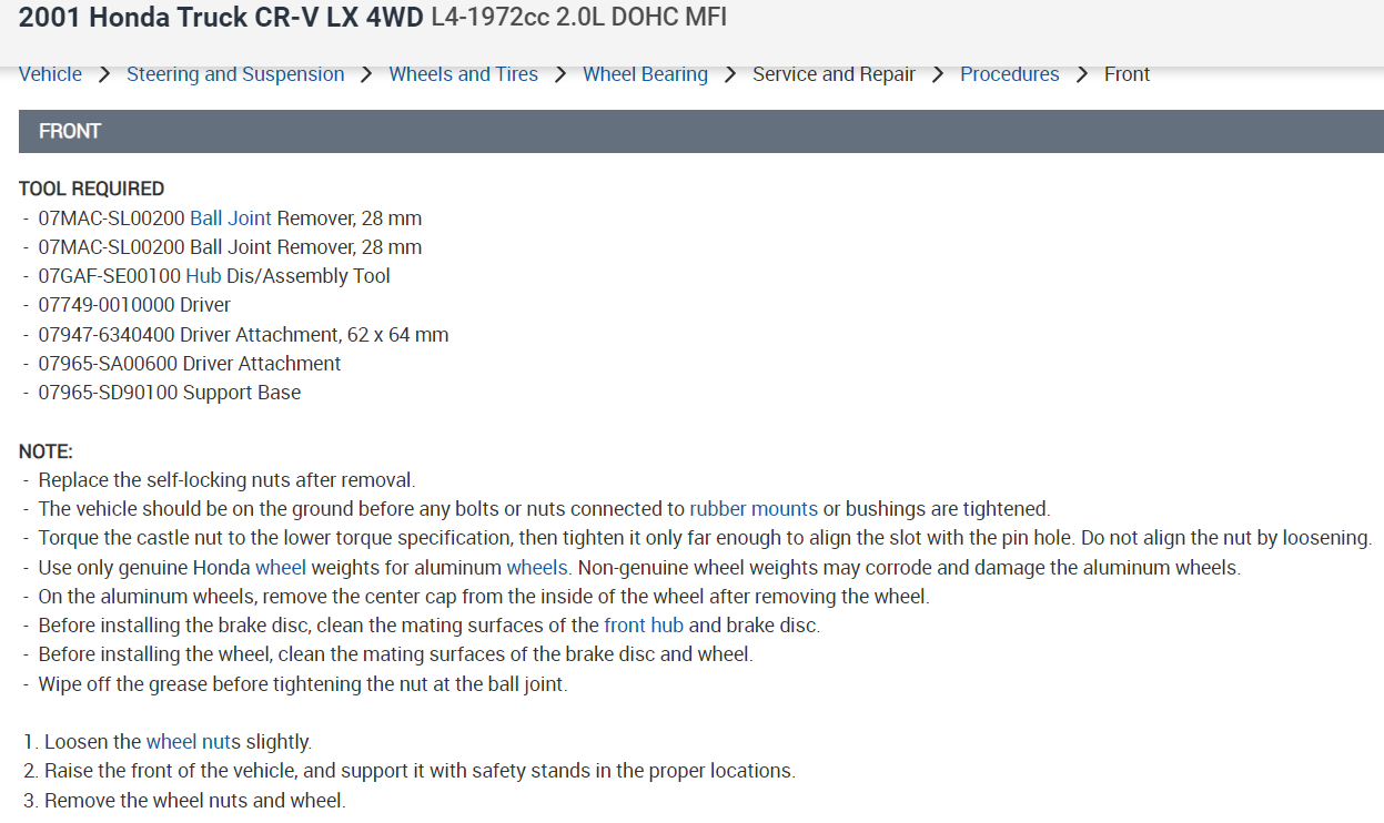

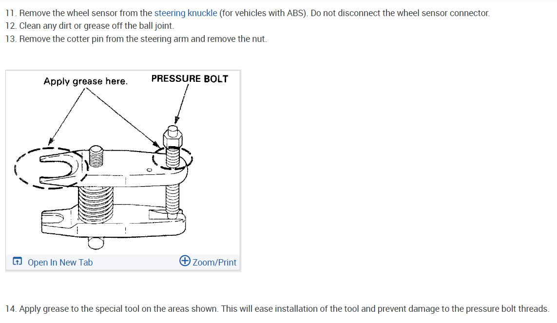

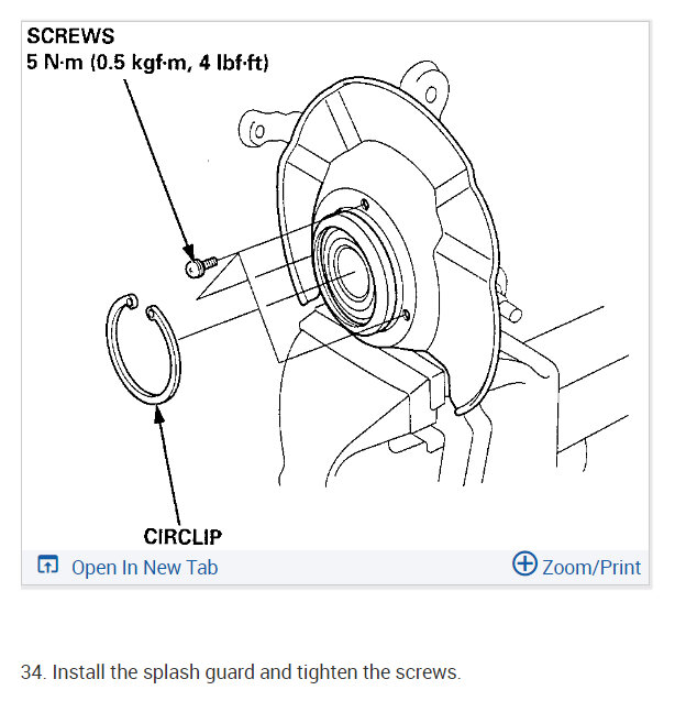

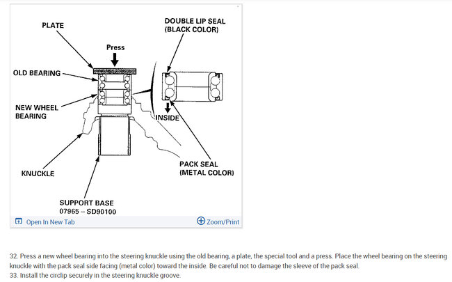

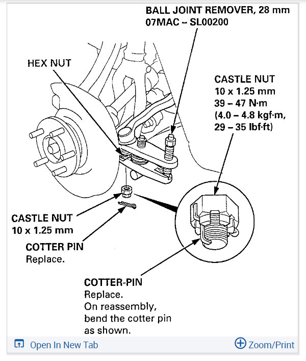

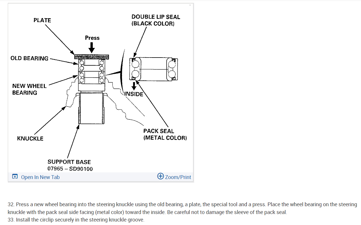

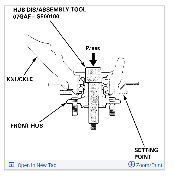

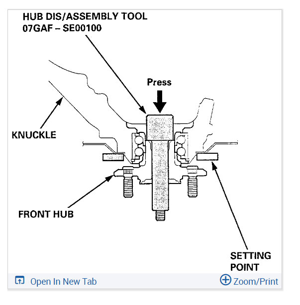

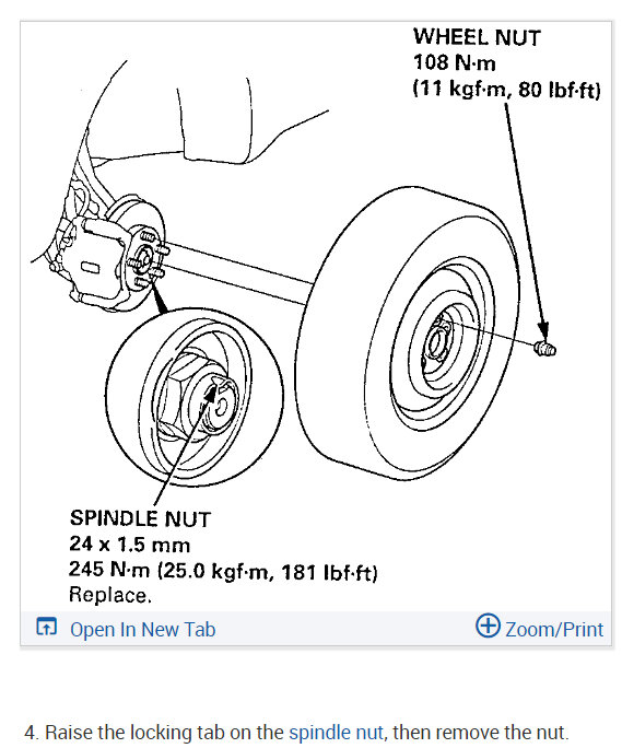

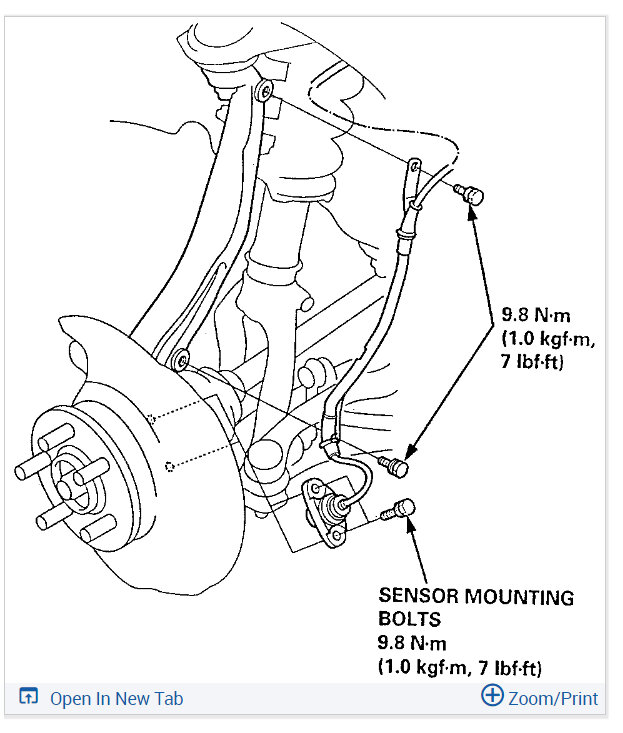

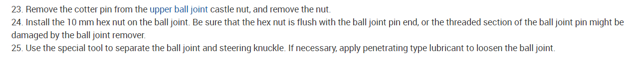

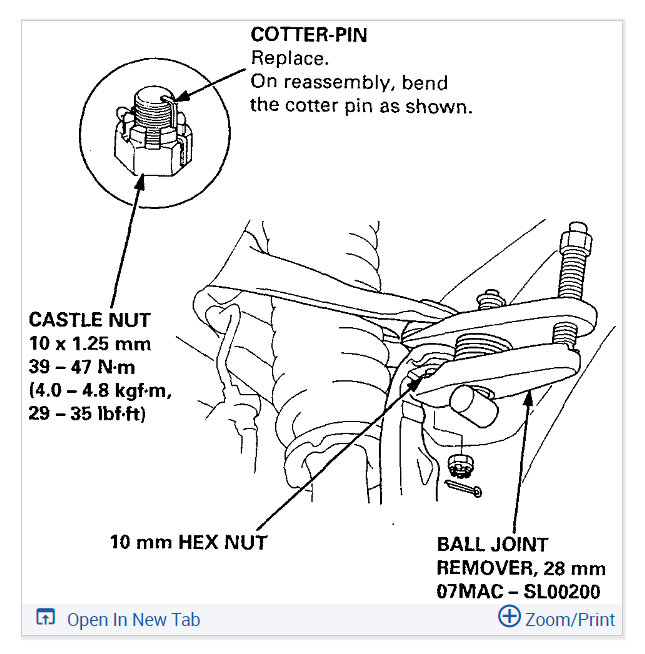

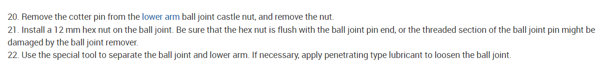

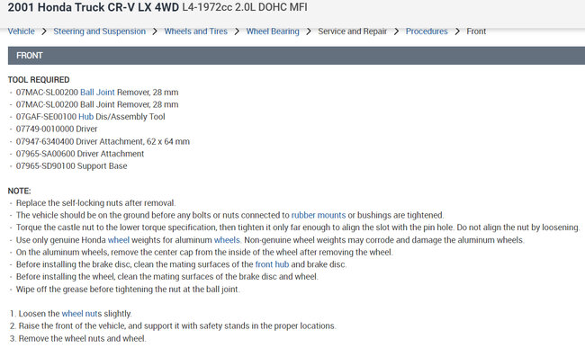

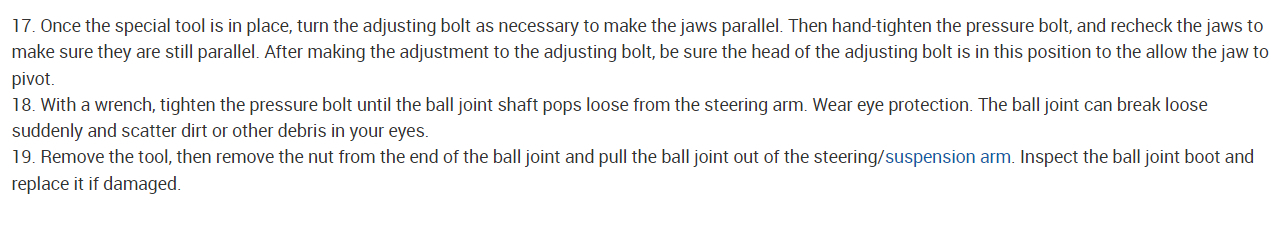

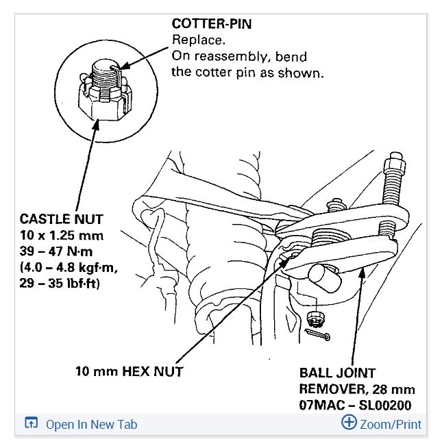

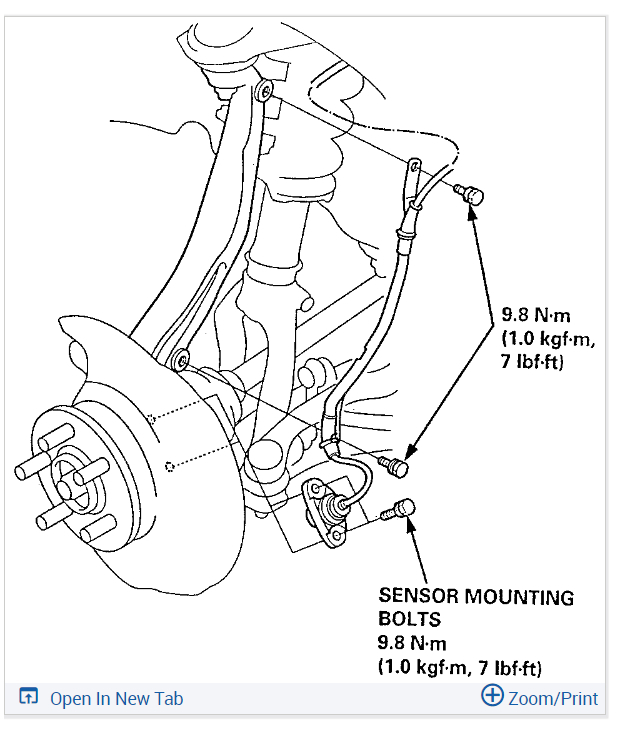

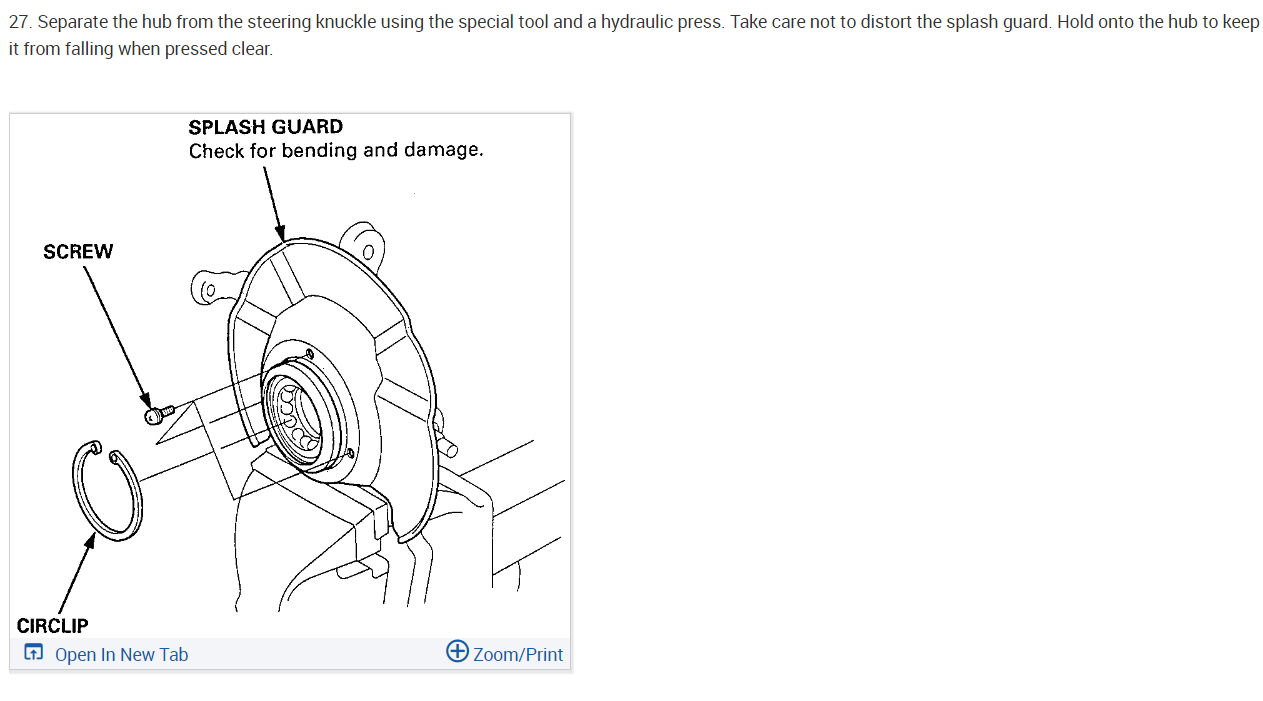

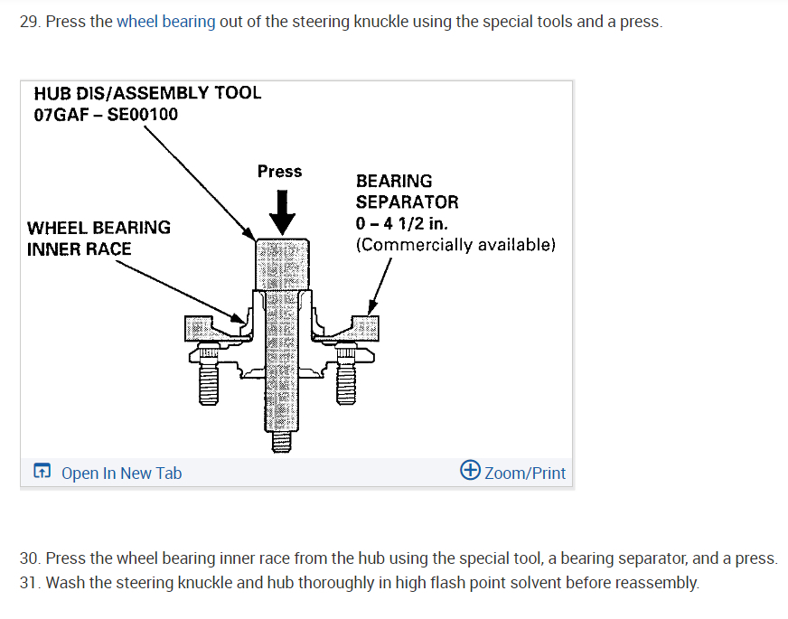

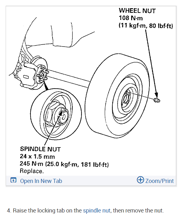

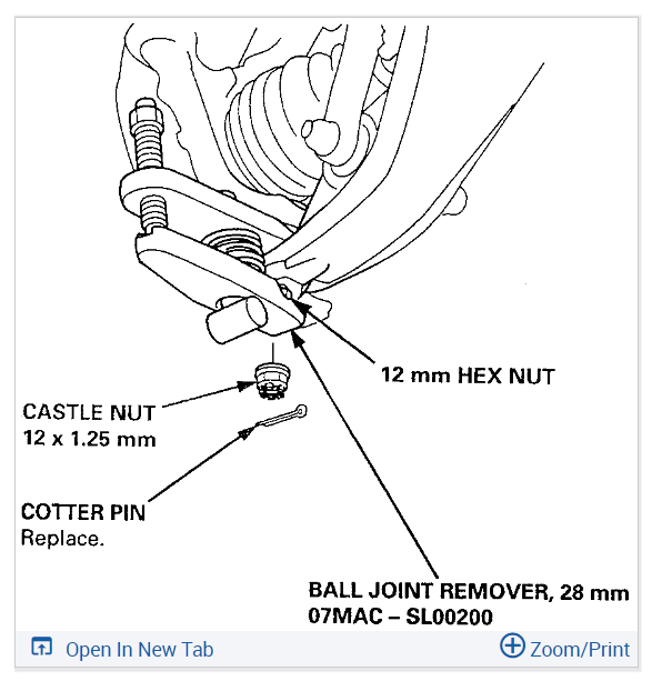

This is common when the bearing hub goes out, depending on which side you hear the noise on, here is how to change the hub out.
Here is a video to show how to press out the axle bearing with instructions below for your car:
https://youtu.be/_FzmmBoa4Tg?si=Y7DM7_yCRMz53x-d
Check out the images (below). Please upload pictures or videos in your response to the problem so we can see what's going on.
