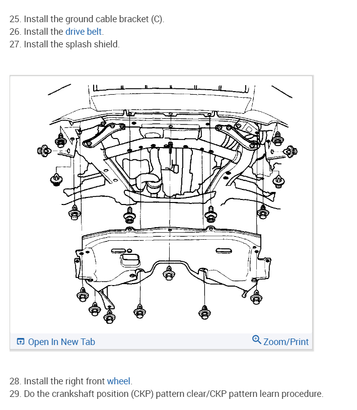

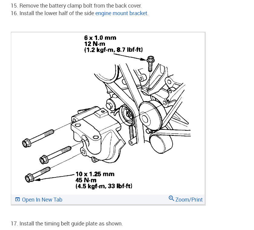

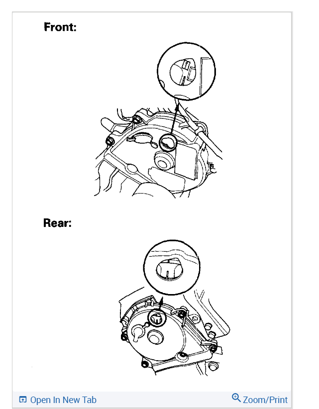

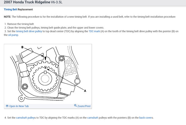

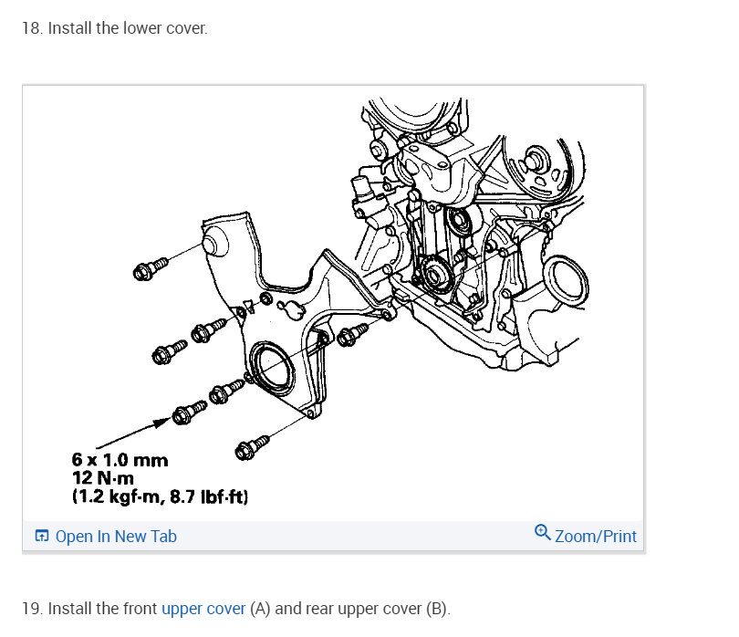

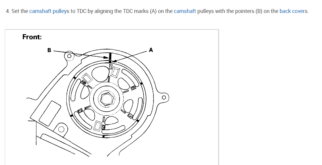

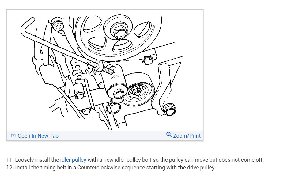

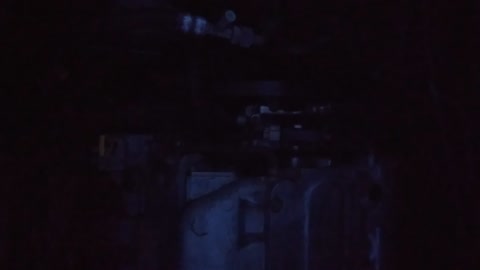

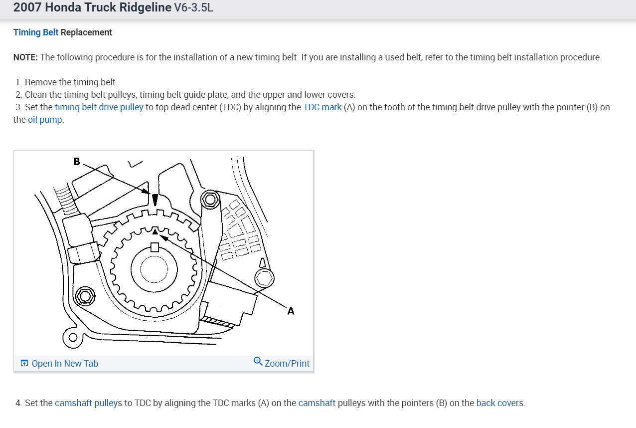

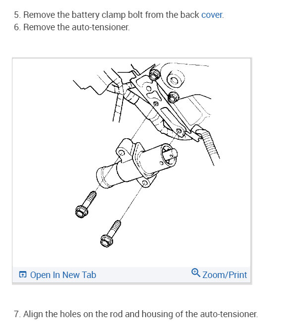

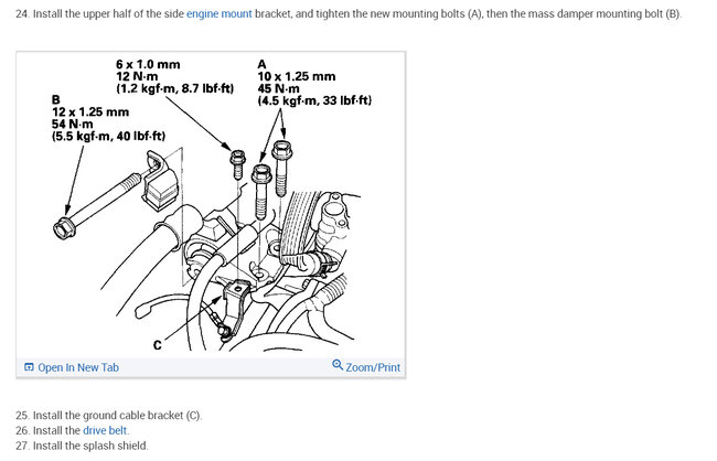

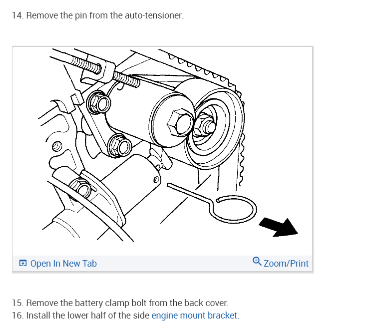

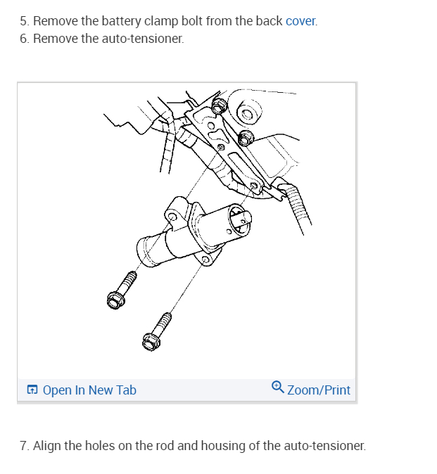

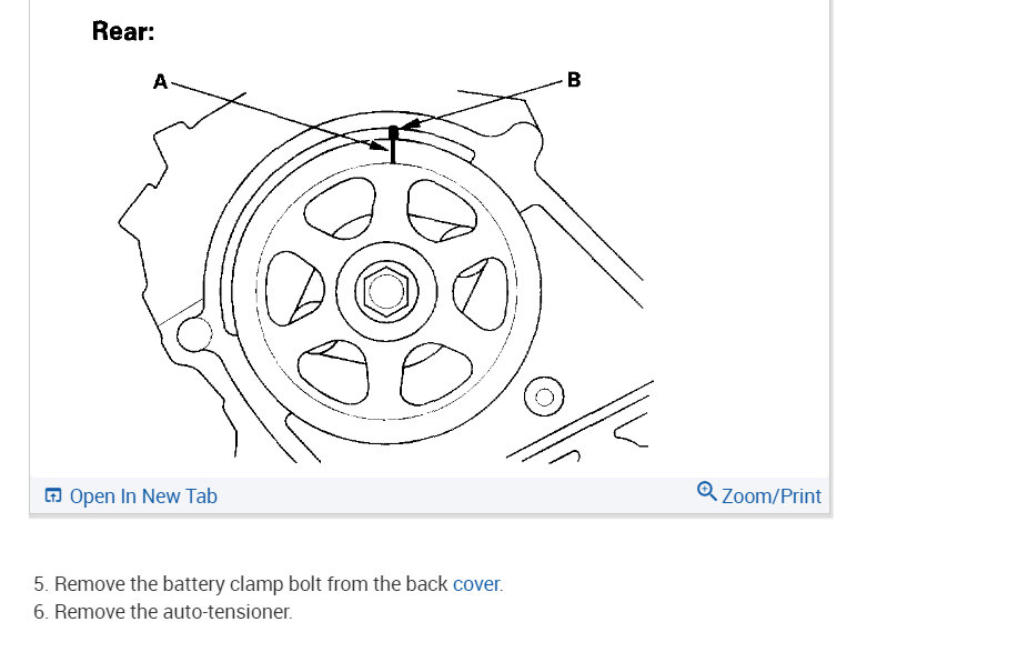

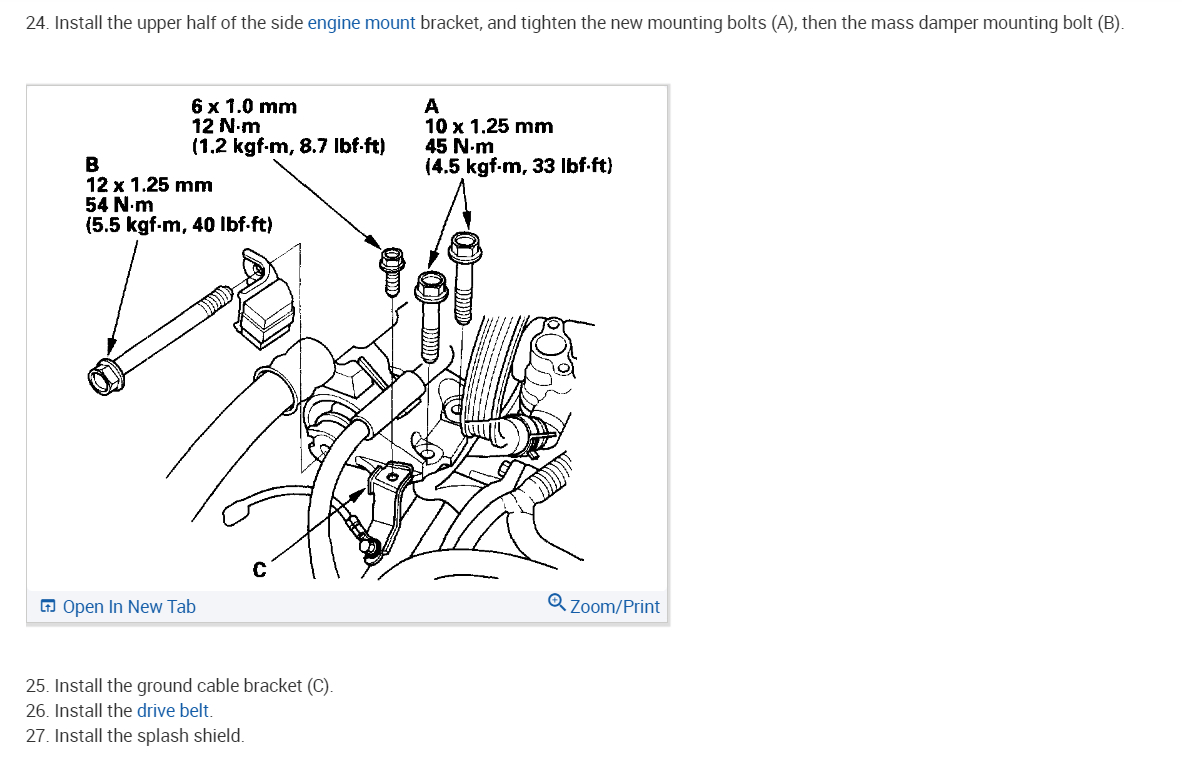

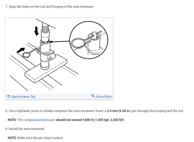

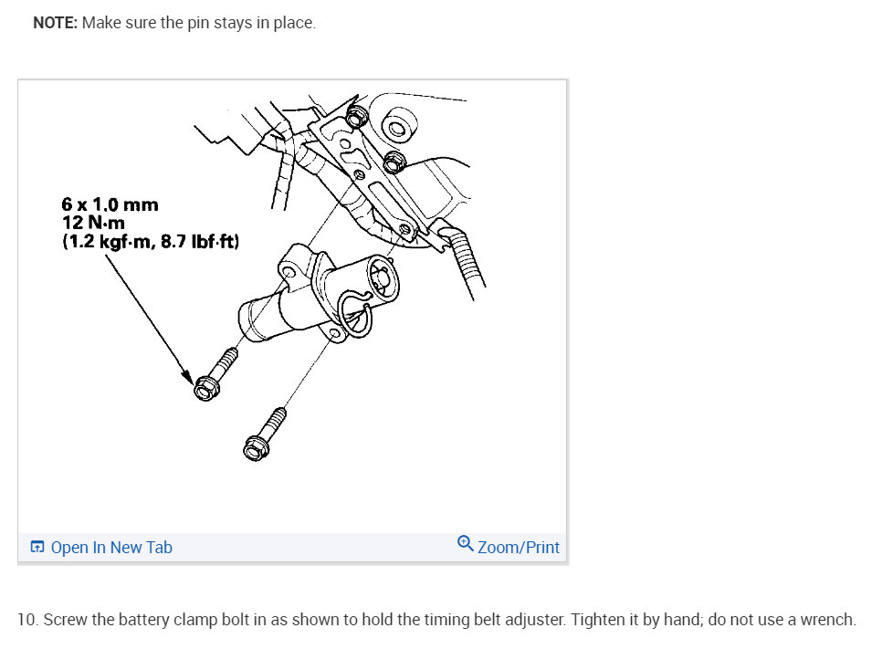

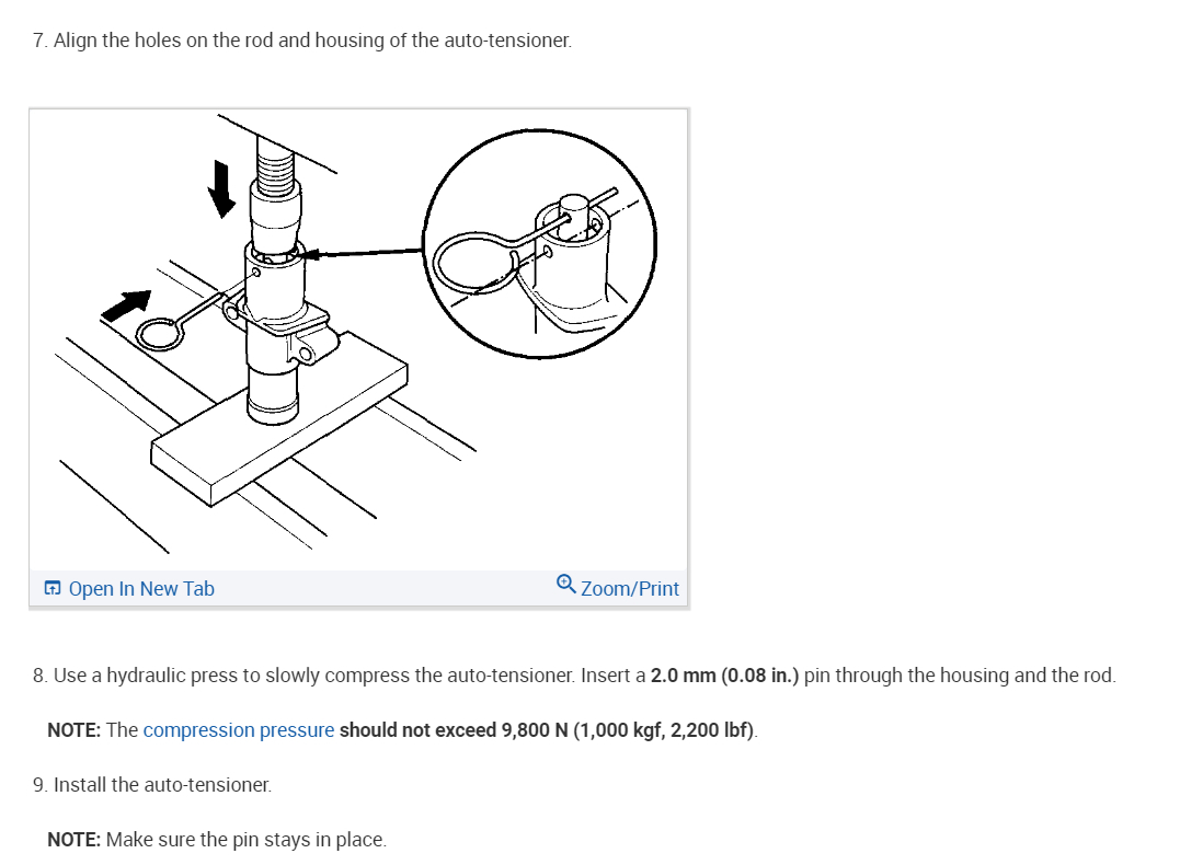

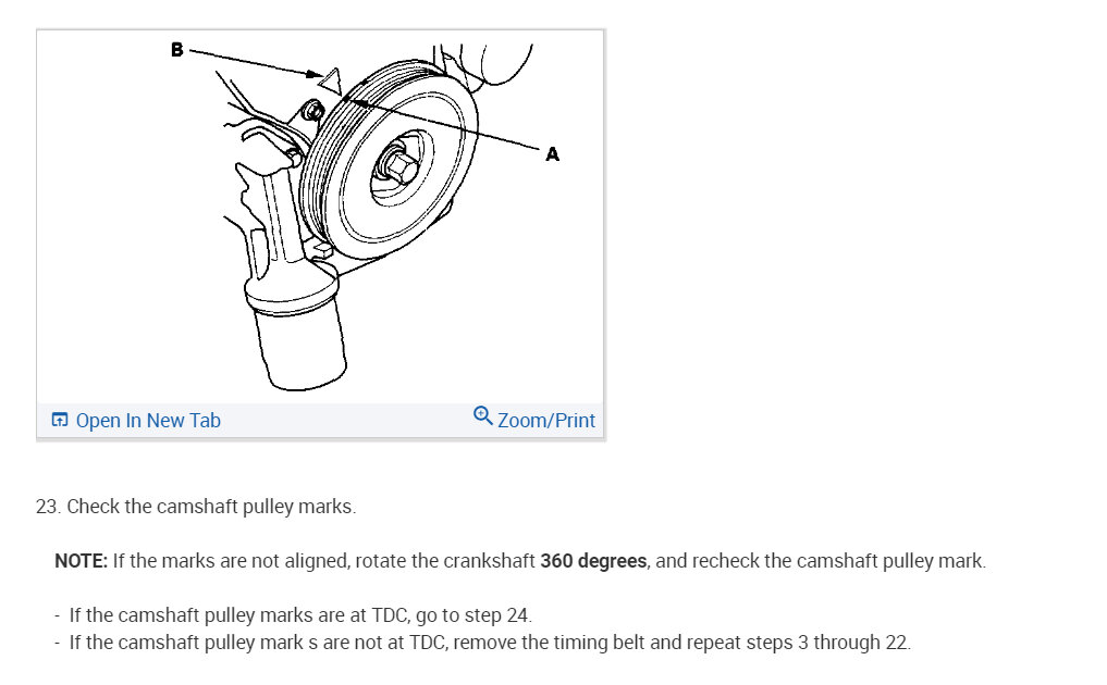

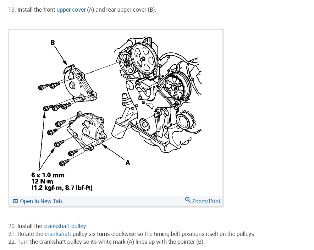

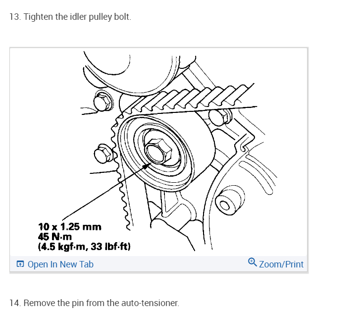

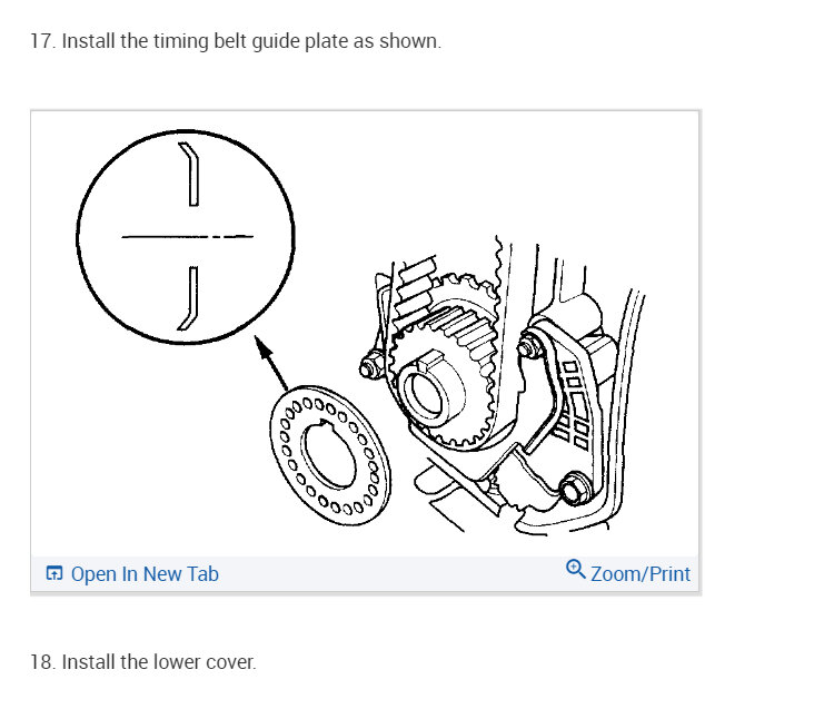

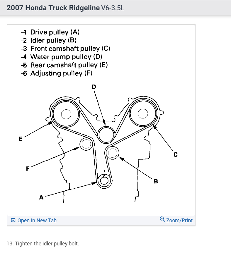

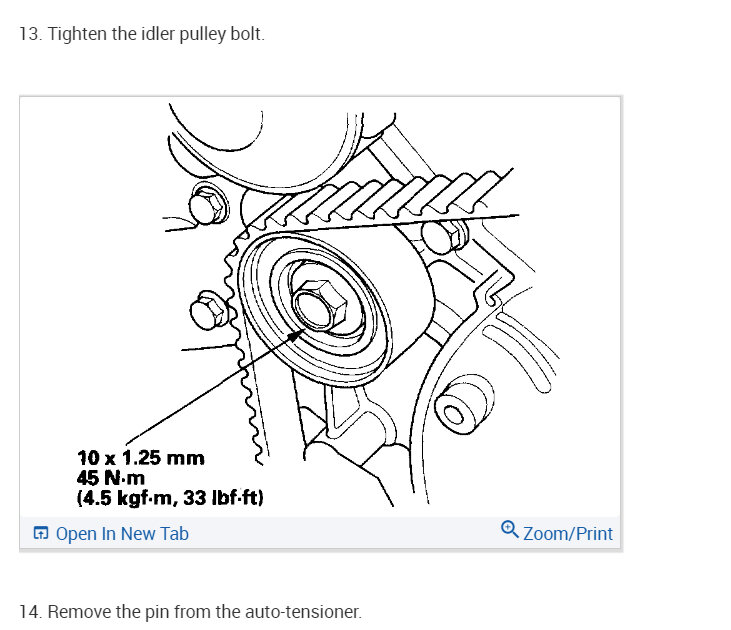

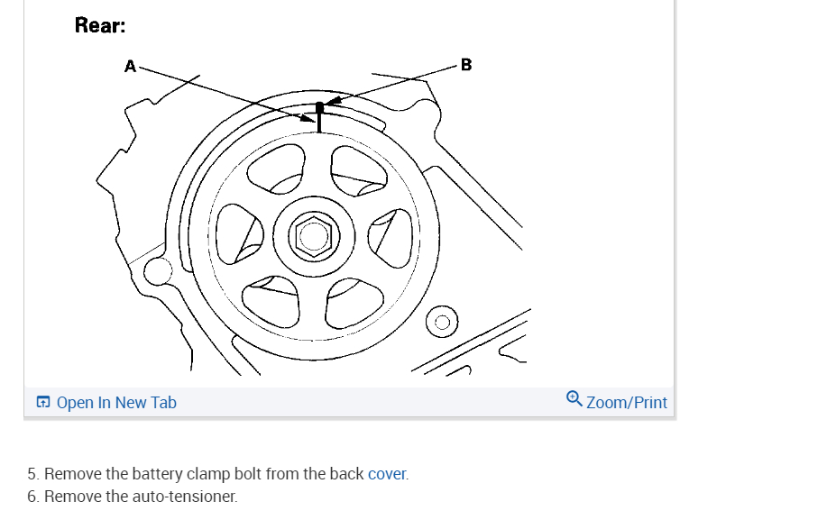

Thanks for the video, it helps. I don't think that the power steering pump knocking sounds more like the timing belt guide has broken or the timing belt is about to let go, I do hear a tensioner bearing that is making the squeaking noise. If you remove the belt, it should help confirm the problem. Let me know. Here is how you can change the timing belt in the images below. I would replace the water pump and timing belt tensioners as well. Check out the images (below). Please let us know what you find.
