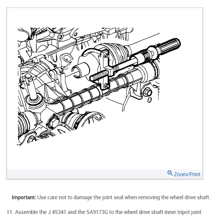

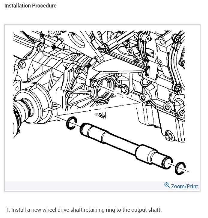

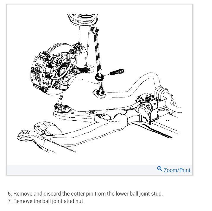

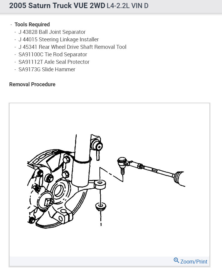

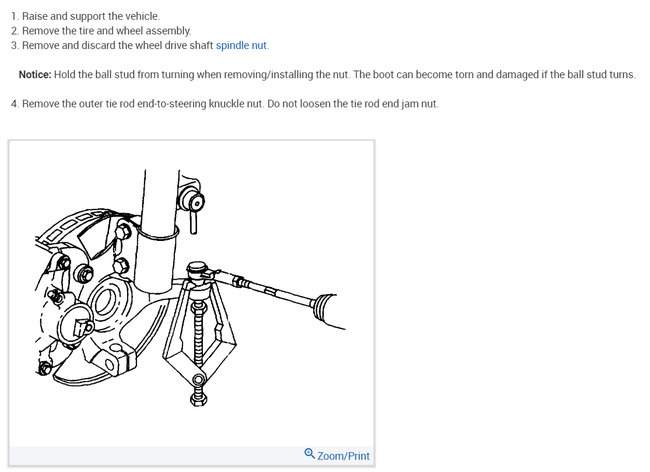

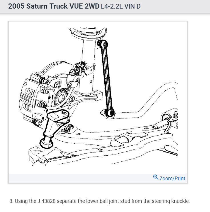

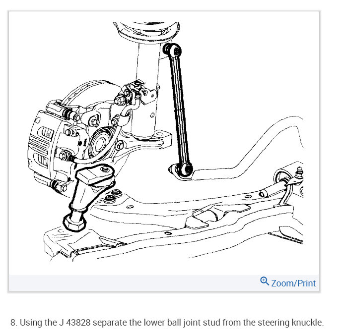

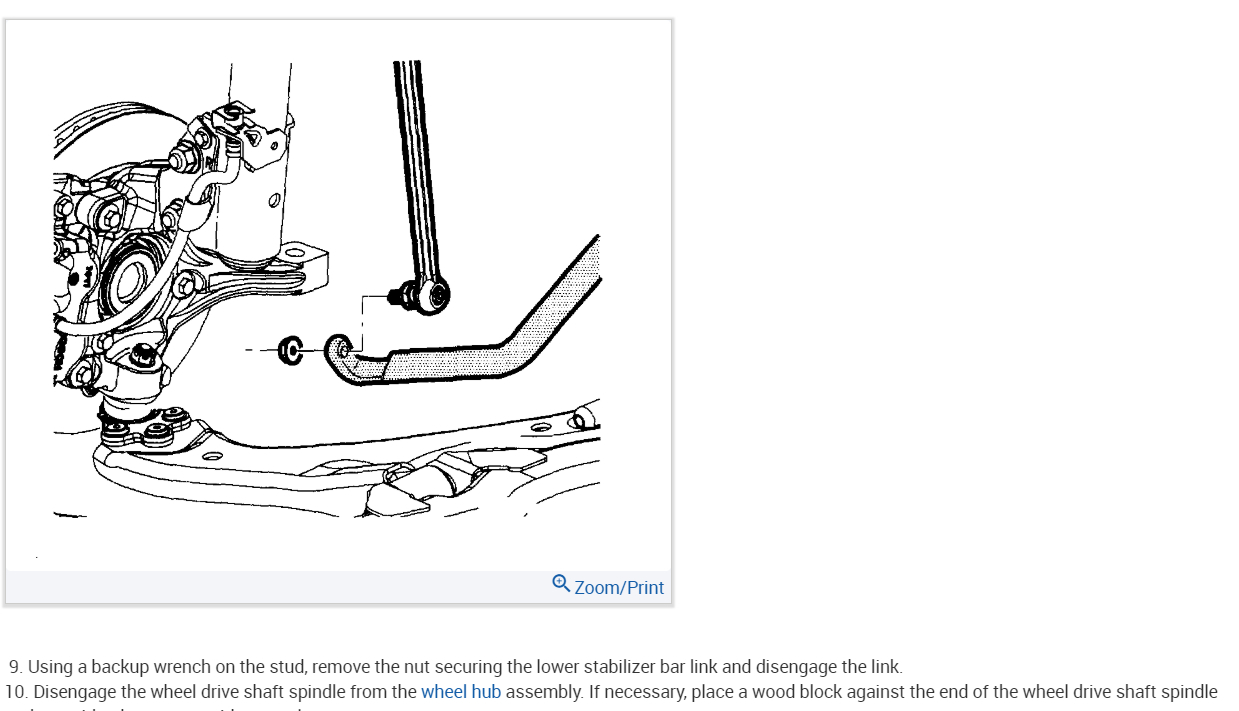

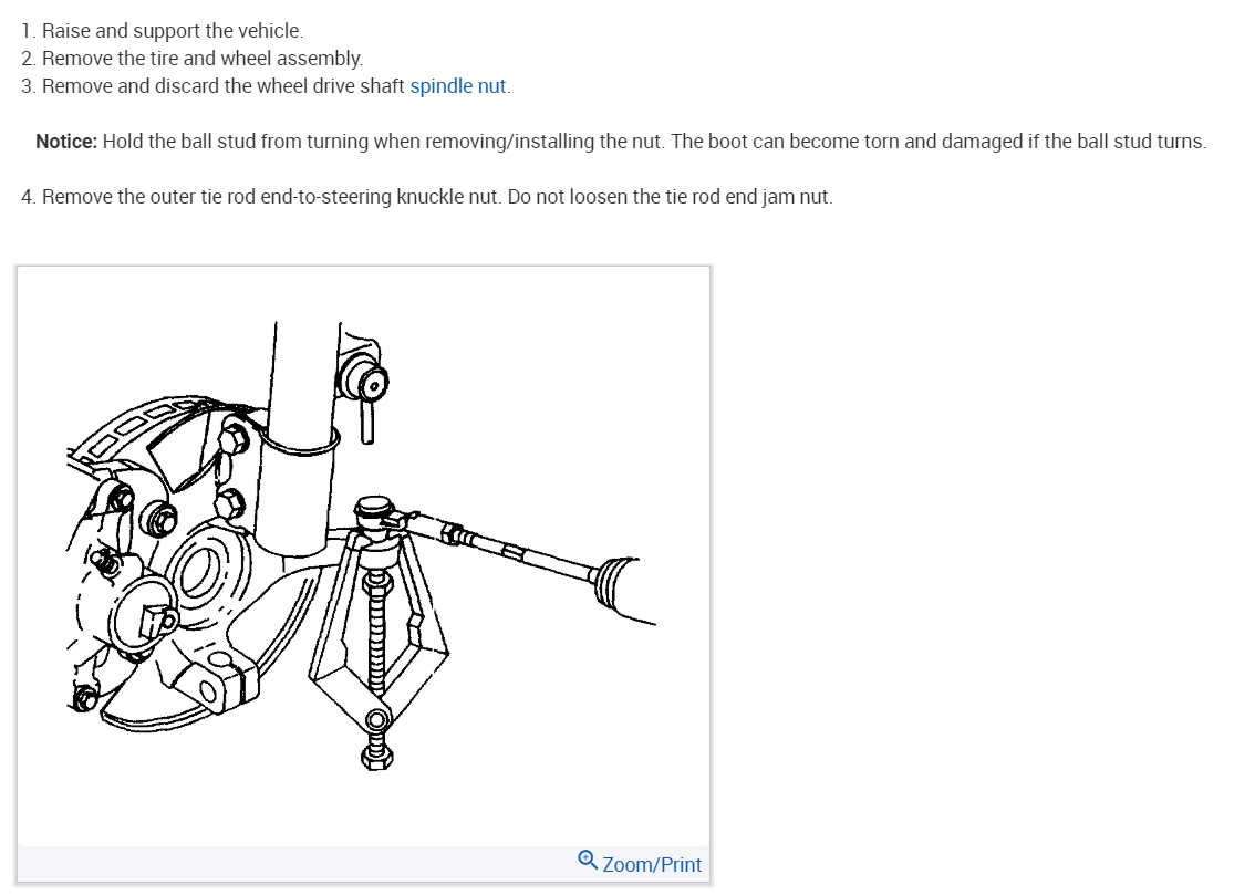

It sounds like you might be right about the support bearing. Can you please shoot a quick video with your phone so we can hear the noise, that would be great. You can upload it here with your response. If it is the bearing you can remove the axle and just spin the bearing by hand you will be able to tell if the bearing is bad. Here is a guide and diagrams below to help you see how to remove the axle:
https://www.2carpros.com/articles/replace-cv-axle
you will need to pop the ball and tie rod ends here is a gudie
https://www.2carpros.com/articles/how-to-release-a-ball-joint
