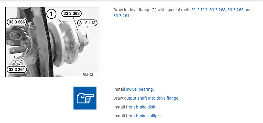

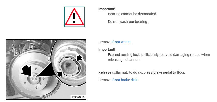

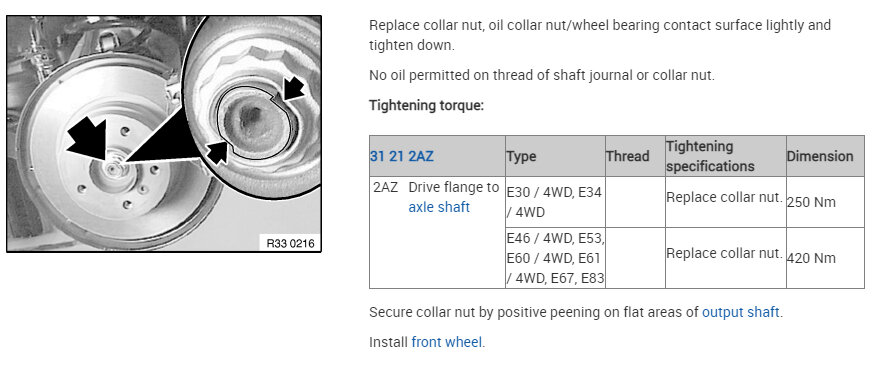

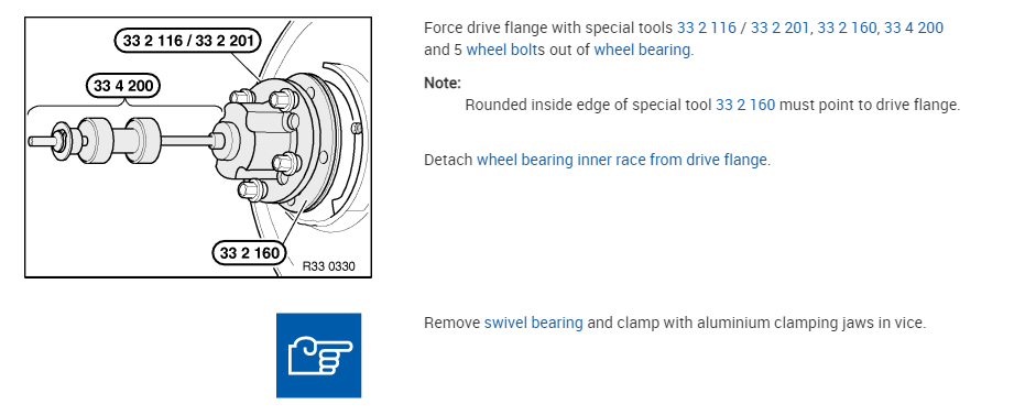

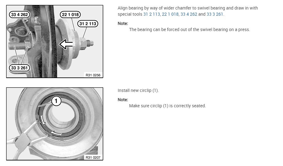

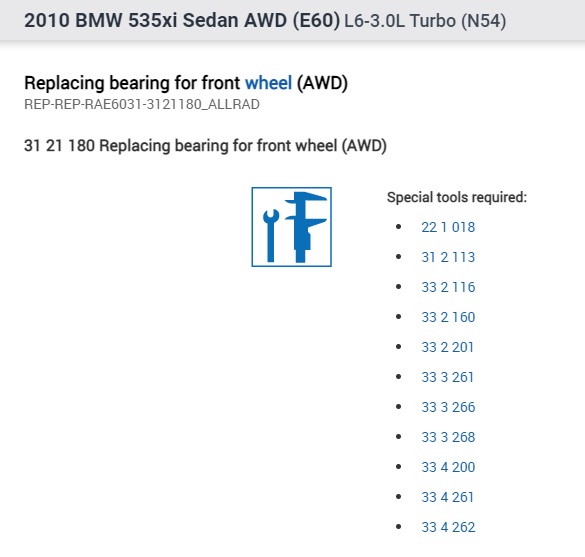

If you look below, I attached the directions for the removal and replacement of the bearing. Take a look through them and let me know if you have questions.

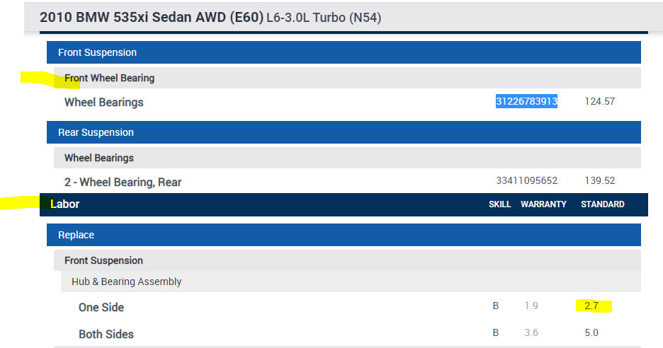

I don't know if you are interested, but I did include the OEM part number for the bearing and the labor time to replace it. See pic 1 below. Additionally, the remaining pictures are the directions for replacement.
See pics below.
