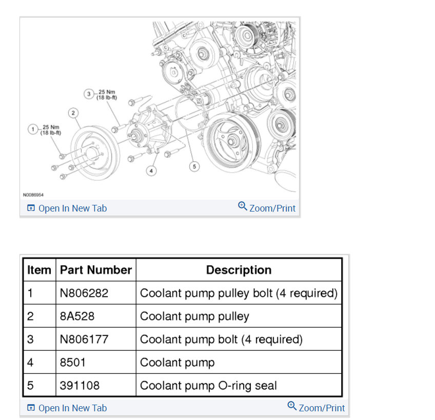

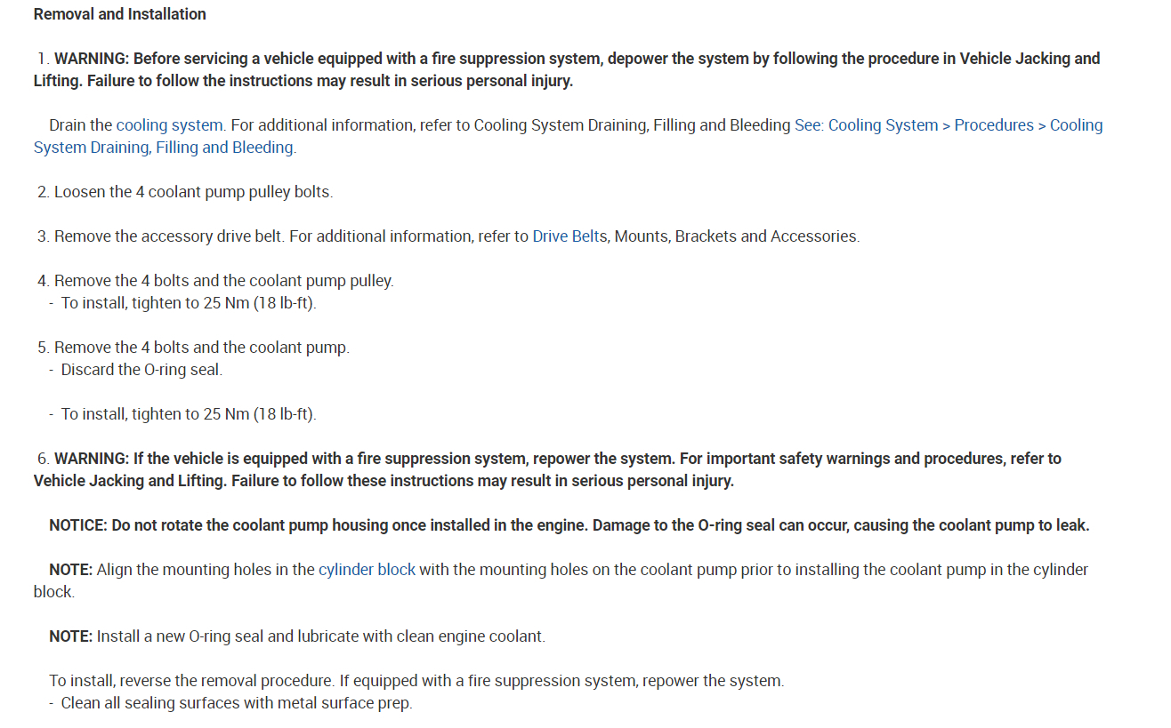

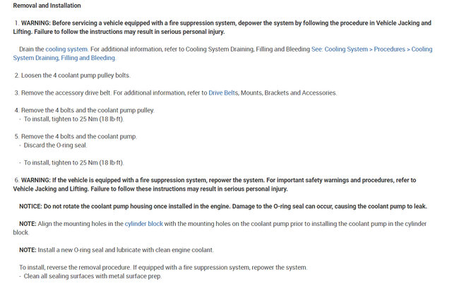

The most common is the water pump. The bearing fails from the tension.
https://www.2carpros.com/articles/water-pump-replacement
https://www.2carpros.com/articles/coolant-flush-and-refill-all-cars

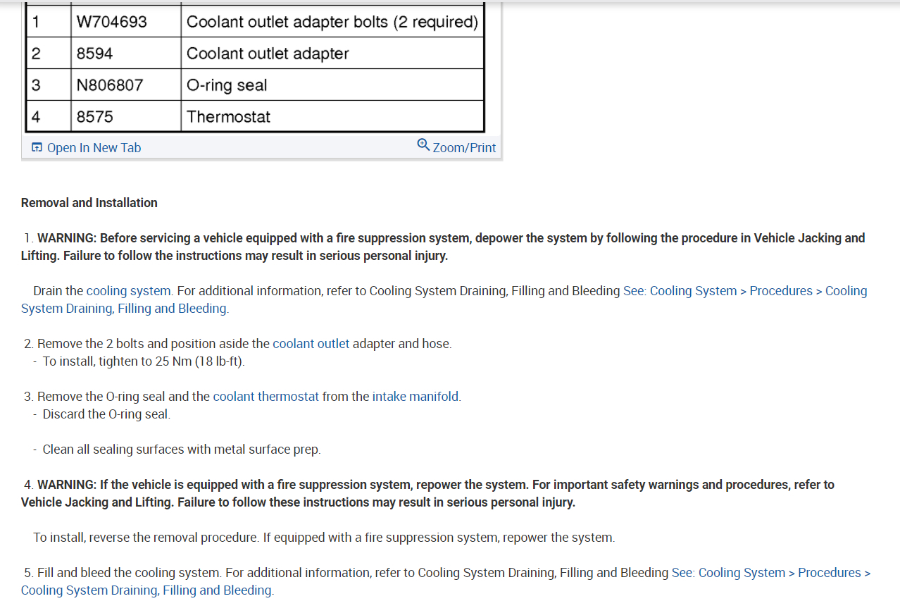

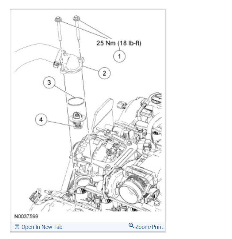

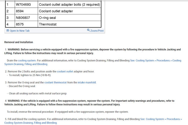

If it is the water pump, I would suggest replacing the thermostat as well since you have the system open. I attached the procedure below for you to view. It is an easy replacement.
